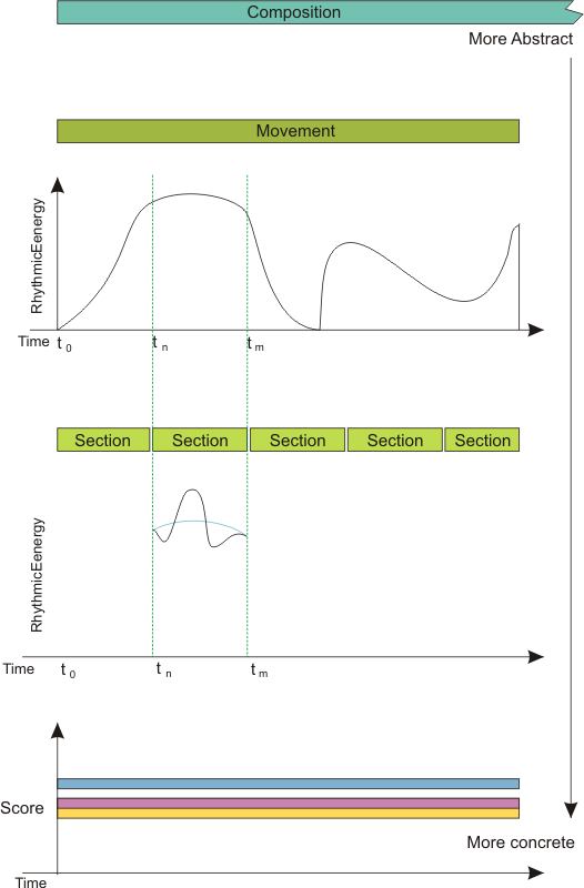

Two recent threads in the composition forum:
How do you write your partiture?
Composition Grammar
Interestingly (or not) I have been working on a heuristics based music composition system that includes several of the features raised in these two posts. Unfortunately after something like 8 months work on the infrastructure I still have at least 8 months of work left just to complete the infrastructure. When completed it would allow the user to create a composition by setting discrete parameters, drawing continuous parameters, and entering motifs—rhythmic, harmonic, melodic etc,. It is a top down system, meaning that (except for motifs) one starts at the highest level of abstraction and works down. Many of the abstractions (parameters) are hierarchical. The attached diagram shows one way in which continuous parameters, in this case RhythmicEnergy might usefully follow hierarchical decomposition. In this example conservation is the method. Here the area under the RhythmicEnergy curve from tn to tm is the same at movement and section level. One could specify such parameters at high levels of abstraction and let the algorithms work out the appropriate variations at lower levels of abstraction.
Though very far from implementing it I am currently working on definitions, i.e. models, of mode (in the broad inclusive sense of pitch class sets) that are amenable to graphic representation. If anyone is interested in perusing that in this forum I would be glad to exchange ideas.
 Filesize:  36.61 KB
 Viewed:  21587 Time(s)

elektro80 wrote:
Initially, I felt that this might do nothing for me re the way I write music. I tend to think I kinda visualize everything at once.. that doesn´t make any sense.. I know.. but I think I write in a kind of nonlinear everything at once kinda way (.. still doesn´t make any sense).
Actually, I think it makes perfect sense. And this program is designed to facilitate that very process—at least if I understand you rightly. For me a composition may begin with a few notated fragments-ideas, but before I begin work proper I always develop a complete “schematic” of the work. As work progresses the plan virtually always changes and evolves, sometimes very radically but I still find the plan necessary. The program will work much the same way.
The program (which I’ve named Heuristic Muse Shocked ) constructs a composition from a plan that is dynamically built on the fly. This is accomplished through a dynamic goal stack called the Agenda—quite analogous to the execution stack in standard compilers / interpreters. The main difference is that it can be reconfigured on the fly. Say the “Create Composition” goal has pushed movement subgoals onto the stack (above it’s own location) *. The stack would look like this
“Create Movement 1”
“Create Movement 2”
“Create Movement 3”
The top goal is always the one to be executed**. A goal is popped from the stack when all its subgoals have been completed. What makes this stack dynamic and differentiates it from program stacks is that it is reconfigureable. Say the “Create Movement 1” goal has pushed a bunch of subgoals on to the stack and one of those subgoals decides it wants to paraphrase material in “Movement 3.” But Movement 3 has yet do any score generation. Movement 1’s subgoal that needs that material can ask the Agenda controller to reconfigure the stack so that work on Movement 3 can progress at least far enough to meet the needs of that subgoal. If the Agenda controller cannot accomplish the reconfiguration it passes that fact back to the requesting subgoal which then must make other plans.
*Prior to pushing the create movement subgoals it would have generated, or obtained from the user, the minimal data needed to accomplish those subgoals, i.e. have created a minimal schematic. Each create movement subgoal would create its own schematic at a slightly lower level of abstraction and so on.
The execution sequence for a goal is.
1 Execute functions not dependent on subgoals including gather/generate data for subgoals.
2 Push subgoals on to stack (through the stack controller).
3 When all subgoals are accomplished execute subgoal dependent functions.
4 Pop from the stack (through the stack controller).
**In terms of the hierarchy this implies a depth first approach but it doesn’t have to work that way.

Kassen wrote:
Could you go into a little more detail? How will this link to instruments, for example? Are you planning to use MIDI, OSC or will sound generations be a part of this program too?
MIDI will be the most concrete level. The system will first generate “theoretic score” which is more or less inversely analogous to an orchestral reduction or to open score such as Bach used for The Art of Fugue. At this level there would be little performance data beyond tempi and dynamics. But information about expressive content would be present at higher levels of abstraction. The theoretic score and those expressive abstractions would be used to create a performance score. Finally the performance score and the expressive abstractions would be used to create (through a relatively simple one to one mapping process) the midi data, which would be output to a file—this can include phrasing articulation, timber modulation, note level dynamics, etc. But during composition (creating the theoretic score) real-time MIDI playback will be available with only tempo and dynamics much as it is in the early releases of Sebelius. At this point there is no more than a “place holder” for performance score and until the “theoretic score” generator is fairly far along in functionality no more work will be done on it.
Kassen wrote:
What platform are you developing this for?
Sorry to say I’m writing it for MS Windows. If I had it to do all over again I would have refreshed my Common Lisp skills and done it under Linux, but that’s water under the bridge now. I’m writing it in Visual C++6.0 Though I may upgrade to VC++2005 I’m using MFC so I won’t incorporate managed extensions or CLI—too big a pain in the ass with MFC. Anyway VC++ was the toolset with which I had greatest facility—so here I am, stomach churning violently every time I create a pointer bug.

Kassen wrote:
Do I gather you are aiming at cross-breeding practices of instrumentalism and composition here?
I’m not sure what you mean by that. As a guess I will interpret the question as if you had used the word instrumentation i.e. orchestration.
I have to admit I am still unclear myself on exactly how the transform from theoretic score to final performance level midi data will work. My concentration has been on design and implementation of infrastructure and getting a grasp on the details of where computer music composition currently stands. A great deal has been done in that area the past 10 years and I’m knee deep in books on the subject.
Anyway my hunch about the way it will work is that if you want to use a specific set of “instruments” then a definition of that set must be supplied. The definition of an instrument will include data about its abilities both technical and aesthetic as well as details of to the mappings between system aesthetic parameters and symbols and MIDI data that controls or modulates those parameters in the “instrument.” Generalized dialog forms would be provided for such definitions but ascertaining and entering such data and making the appropriate symbolic links between system aesthetics and “instrument properties” will be up to the user. This “orchestra” data could then be used by the program to constrain aesthetic parameters to produce score that generally suits the defined instruments. But at least in the first iterations of the program the compositional algorithms will not have specific instruments “in mind” while they grind out notes. In the beginning simpler techniques of “orchestration” will be used.
And thanks for the good words and encouragement. At this point I’d be happy just to know that I’ll live long enough with competent mental faculties to get just some of the theoretic score generating code working. Unless you are a programmer you can’t imagine what a depressing shitload of grunge work stands between here and there. I recon it will be a year before there is even a ridiculously limited program to test—but I’ll definitely post it here when it gets to that point.
What I need at this point is a creative discussion of how modes and tonality might be modeled in a graphic vector like manor.

DrJustice wrote:
This is intriguing Bachus!
I must admit that I don't quite understand the exact sequence of stack operations and processing steps (yet..) - but I guess that' where some of the magic lies, in the workings of the dynamic stack controller 'Agenda'. DJ
Oh I fear you will be quite disappointed. The Agenda controller turned out to be a rather simple affair—not much more complex than the execution stack of a typical language. On those stacks the order of dependence is absolute. Execution of each element on the stack is dependent on the result of on the one on top of it. The Agenda is different only in that an element lower on the stack does not necessarily need the result of all or any of the elements higher up in the stack. That’s why the Agenda’s contents may be reorderable while the content on the execution stack of a typical language never is. No magic there at all, really.

I'm attaching a text file with some technical description of the Agenda primarily for DrJustice, as I see he is a techie type.
A further note:
I’m sure it will be clear to the more technical that the object for which a goal is being realized does the realization itself. This is very important in that it allows data and method encapsulation. Thus the composition object need know only how to layout its structure at the highest levels of abstraction—how many movements, how long, how to distribute any attributes assigned to it over it’s movements etc. The same it true of the movement. It need know nothing about the composition and only enough about itself and sections to create it’s own layout and so on.
I might also point out that goals and the agenda control the entire process of composition creation—eventually right down to the level where the goal is to add a single note.
CAgenda.txt

DrJustice wrote:
So any man-handling of the stack is up to the Realization. --
Well not really, the call: m_agenda->PushGoal(g) is carried out unconditionally and that might be considererd man-handling. But to reroder the Agenda the call
result = topGoal->m_directObject->RealizeGoal(topGoal) ;
must set result to the Symbol _reorderAgenda
I Have yet to implement the re-ordering function so there is not a case for it in the switch statement shown in the attachment, but the data structures required to allow it when possible are defined. Since the CGoal object is a list (because it inherits from CTNode) It can carry more information than is immediately apparent from it header definition. The case will look like this
case _reoderAgenda :
Reorder(topGoal) ;
break ;
So the goal that was topGoal has not changed its position on the Agenda but its data list has been altered by the call to Reorder(…) to inform its realization function of the success or failure of the request to reorder. And on the next pass through the OnIdle() loop that goal's Realization function is called again and can continue with that updated data as needed.
Reorder(…) is a member or the Agenda so it is the Agenda controller that manages and has the final say in any reordering. This keeps a relatively clean separation between the CAgenda and the CGoal classes though the list members of a goal store the book keeping data that is need by the Agenda to do the reordering.
I hope that makes some sense.
