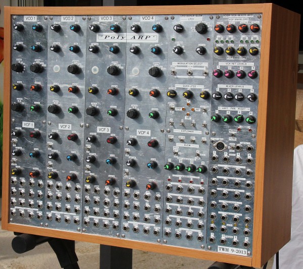

Well, after building my DIY ARP-2600 clone in 2010 I have had a great desire to build a polyphonic synth with ARP qualities. I mainly wanted something that would allow me to create chords and pads sounds and use my previous mono synths for lead sounds. I figured that four notes simultaneously would probably be the best I could hope for, without being impossibly complex. I have rolled the idea around in my head for quite a while and finally after finishing my analysis of the Simmons SDS-3, I decided to dive in.
Throughout the building I changed and adapted it for maximum efficiency. So here is the result which is not quite finished but enough to prove the concept.
The modules include the following:
(4ea) ARP 4027-1 cloned VCOs (my PCB design from the 2600)
(4ea) Sub Oscillator boards that divide by 1.5, 2, 3, and 4 (Roman Sowa’s design, my PCB)
(4ea) ARP 4035 Filters (AndR1960’s PCB design)
(1ea) Quad MIDI to CV board (ACX Synth’s design and PCB)
(8ea) ADSR Boards, one for each filter, and one for each VCA (Electric Druid’s design, ACX Synths’s PCB.
(2ea) Dual VCA boards (Thomas Henry’s 21st Century design, Fonic’s PCB)
(1ea) LFO Board (Electric Druid’s design, Frequency Central’s PCB)
(1ea) Quadrature LFO (Yusynth design and PCB)
(2ea) Dual Gated Slew boards (Yusynth design and PCB)
(2ea) Audio Mixer boards, wired for stereo, with L,R panning (Yusynth design and PCB)
(1ea) Bergfotron +/- 15 V Power Supply (Bergfotron design and PCB)
(4ea) ARP Explorer voice boards (my own design, tested, but not added yet)
Laying out PCBs is one of my least favorite things so where I could, I used designs from the web. I don’t mind actually making the PCBs themselves, so all of the boards were made at home.
I wanted the whole synth to be compact, not long and narrow. I also don’t like having the knobs to close together so as a result each module is a very strange format. They are double height MOTM size. Right now the panels are labeled with cheesy white labels, but at some point I hope to redo the panels with cool graphics.
I normalized the patching so that it can be played with just a MIDI keyboard cable, but the wiring bordered on insanity! There are 114 ¼” jacks that allow for patching if desired.
About halfway through the build process I decided to add Yusynth’s Quadrature LFO and this really expanded the sound. The four phases of the LFO can modulate the pitch, PWM, or filters individually.
Each VCO/VCF/VCA channel has it’s own input to the Stereo Mixer and can be panned anywhere from Left to Right. I usually set it so that VCO1 is Left, VCO2 is just Left of Center, VCO3 is just Right of Center and VCO4 is Right. This creates a really great stereo image effect, especially when the quadrature modulation is added.
I also added the Electric Druid LFO which provides eight different waveforms and can be synced to phase 0 of the Quadrature LFO if desired.
I decided on using eight of the Electric Druid ADSR boards because they have low parts count and allowed the VCA and VCF envelope parameters to be adjusted together simultaneously and yet they are gated individually.
I finished the Poly ARP synth about two weeks ago and after playing it the first day I realized that tuning the VCOs can be painful. I remedied this by adding a 4PDT switch that has a Normal and a Tune mode. In the Tune mode all of the VCOs are connected to channel one of the MIDI2CV output. This makes it easy to tune the oscillators to the same note and then switch back to Normal mode.
So there you have it, a four note Poly ARP Synthesizer with 92 knobs, 34 switches, and 114 jacks.

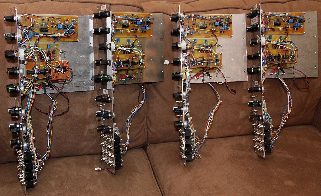

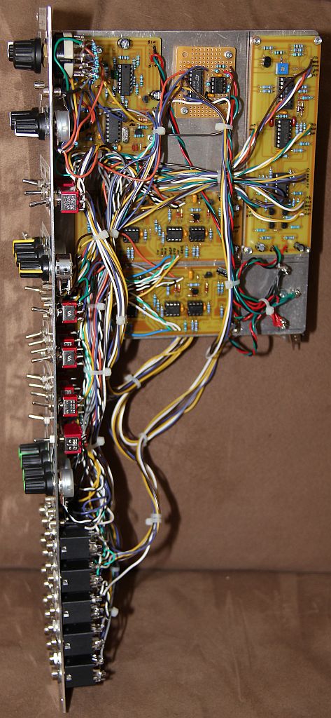

I have built several of these MIDI2CV boards and they work really well. Alain Coupel (ACX) was very helpful and sent me new firmware when I had problems with notes sticking
I have added a few more pictures of each module before they were installed in the case.
I normalized the patching but still needed to be able to remove and work on each module. I used DB15 connectors to connect the various patching to the other modules inside the case.
I typically don't use the white molex connectors that many DIYers use for plugging in the PCBs. If I had it to do again I would have put connectors on every board. It would have made final assembly much easier.
