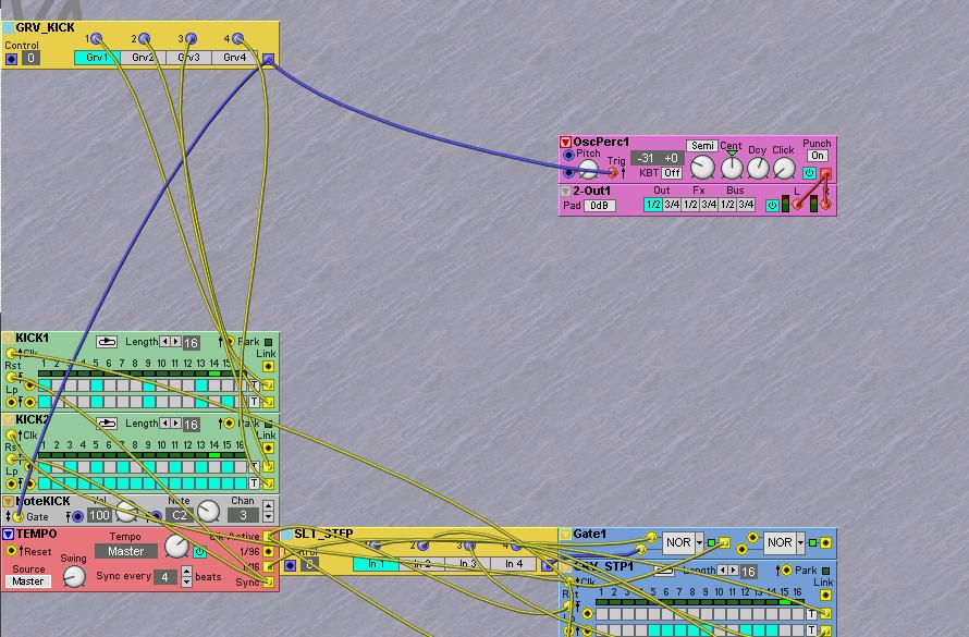

Hi all,
I make a step sequencer. I use a "Sw4-1" to pass from a groove to another one. But the groove change immediately. How can I sync the "Sw4-1" to start the new groove that I select to the next bar (or 1/2, 1/4, ...), not immediately ?

At work so no G2 but couldn't you place a sample and hold after switch and clock it from the sync signal of the clk gen? You may need to add the odd logic delay here and there to prevent logic racing.

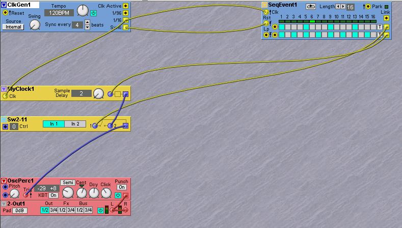

Can I have to use the "DlyClock1" between the second switch and the sequencer trigger-row ?
What is "logic racing" ? I don't understand this term.
I added a new and small exemple.

Ok I don't think logic racing is a problem here as the idea is to delay the pattern change until the clk gen sends a sync signal (e.g. the end of the bar).
To do that we need to use a sample and hold, to hold the value stored in the switch and then a value switch to actually change the connection once clk gen is received.
See my example:
I added another block for if you need more than 2 patterns to switch between. Only connect your sequencers to the Value switch or the Mux, no need to connect them to the switch itself.
EDIT: Sorry, I didn't explain logic racing. This is when logic signals arrive at things in the wrong order, the G2 calculation method has caused a logic signal arrives long before you want it to. The only solution is to place a logic delay in the path to slow down tha logic message.

I love you !!!
I save 12 beers, 4 coffees, a handful of grass and a lot of time!
Ok, I make jokes but I know. A good way to learn is to do it by myself. Doing tests, fail, restart. I must confess that I was far from the correct answer. I tried with the Mux8-1 (without success) before to create this topic. Now I understand the good routing and I will continue by myself.
