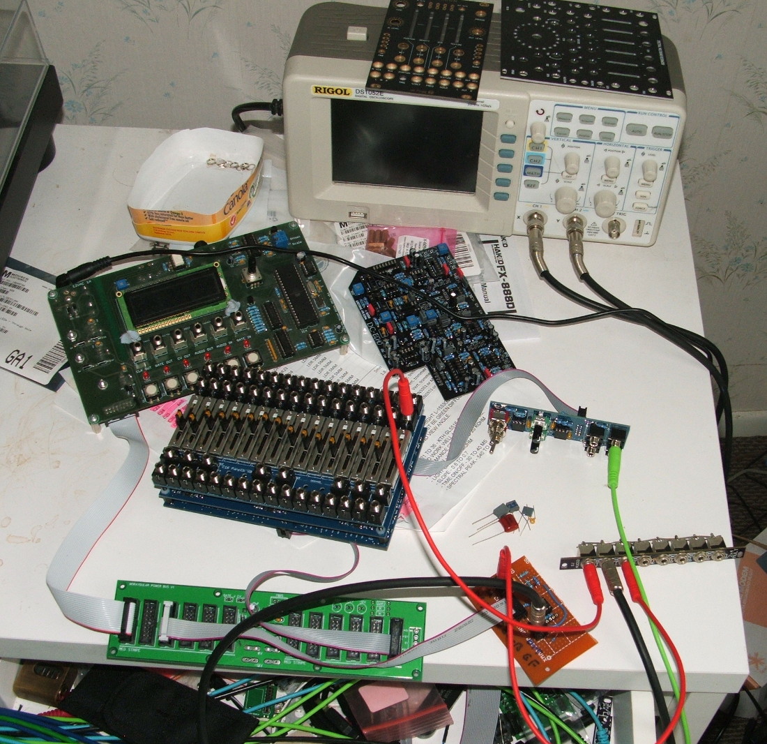

Right, new revision of PCBs and panel are being fabbed, so I needed to test which envelope follower capacitor value worked best in each EQ band.
You can see my little group of test caps I was swapping in and out of the sockets on the perfboard Smile

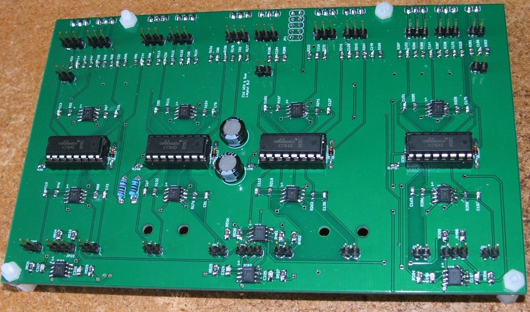

EngA is finished -- the sixteen VCAs, and the final mixers for the various outputs. I think it looks quite spiffy!
EngB, on the other hand, needs 99% of work still to be done on it.

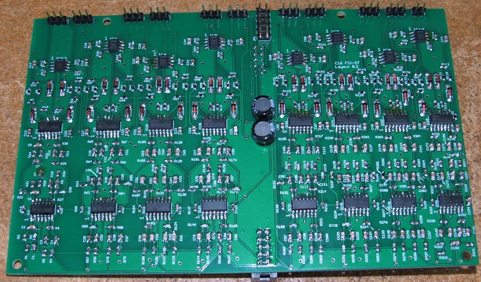

I've soldered up EngB, the board with the filters themselves and the new envelope followers. If I ever do another take on this project, the filters are getting their own, dedicated PCB so I can just solder them up once and then do new revisions of the other submodules.
The good news is that the followers work nicely. I plugged in a VCO to the Input, and as I messed with the frequency of the VCO, I could see the lights on the panel travel up and down the spectrum (as opposed to the old followers, which lit up whenever the heck they felt like it.) One or two LEDs aren't lighting up, so I need to test whether it's the filter for that channel (everything follows on from the filters), or whether it's the follower. I'm going to do that when I have the energy... stupid overtime.
Once all of this board is verified good, I'm then going to go through the gain stages -- the gain on the input buffer (currently set to 3x gain... too high, I'm pretty sure it's blowing out the VCAs), and the gain on the various output mixers (faders, VCAs, comb) so that they all come out at roughly the same p-p levels. Should I set the fader out levels so that when the faders are at max, the gain is x1 (compared to the input), or so that they have a bit more gain if you dime all the faders?
I also need to test the spectral transfer switches, and see if the resistors are passing the right amount of signal (or if they're going to distort those VCAs... again...)
Making progress, slowly, but then I've wanted this module for years. I can wait a bit. It's probaby vanity, but I also think these circuit boards are looking dead spiffy!
