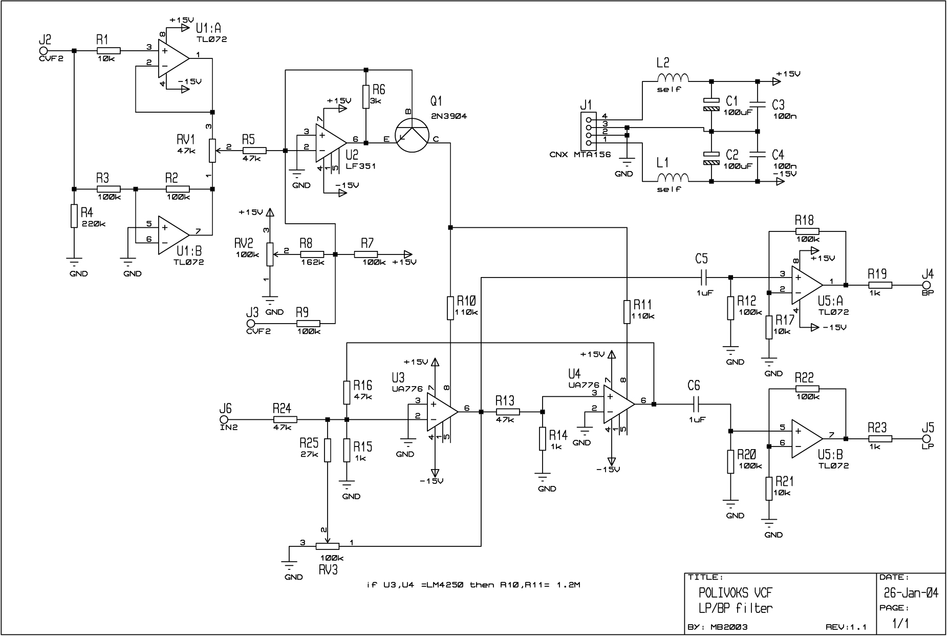

I am looking to build a clone of the Polivoks VCF circuit. Can someone explain how the voltage to current circuit works, as I haven't seen this configuration before.
I have copied the circuit from the schematics vault for reference.

JovianPyx , I get how the circuit's that you posted work. However in the Polivox circuit the base is connected to the inverting (-) input of the opamp and the emitter to the output of the opamp, I cant see how this could work the same way, do you think this is an error in the schematic?

Yes, looking at the schematic again I do see what you mean.
What I see is that instead of the current coming from the summing node through the collector circuit, it appears to come from the opamp output through the collector-emitter circuit. I can't say for sure if it will work that way, but perhaps it does but not as a truly linear current source. Also, the way the base-emitter is biased, because there's no series base resistor, it looks like it could be possible to blow the transistor - however, there's that 3K shunt resistor which may protect the transistor. It could be that this arrangement is not linear, but also not expo, but it may be close to expo enough to help the filter track better?
As to "is there an error", I believe there is not. I just looked at another drawing of the same schematic and it is wired the same way. So I think that it is a non-linear / non-expo current source. The docs I found don't reveal much in terms of how it works.

The opamp is basically fixing Vbe to .06 * CV input (simplify by ignoring all the summing and buffering and just assume a single CV input). At this small Vbe, according to the Ebors-Moll model the current through the base is negligible compared to the current through R5 and R6. It's not relying on a base resistor to limit the current because the supplied Vbe is so limited.
I'm not familiar with the filter but I suspect Q1 is biased in a range that will respond exponentially to the CV input and provide the desired current to the UA776's, it's just not temperature stabilized with two matching transistors. Our ears aren't sensitive enough to hear the variation in cutoff frequency, it would only be noticeable if the filter were self-oscillating.

with RV1 you can morph between a positive and an inverted (ADSR)envelope .
RV2 is the basic cutoff freq. setting.
U2 with Q1 are a non temp. compensated inverting current sink, that pull down the current control inputs of the 2 UA776 when +CV rises.
BTW redesign:
If you want to replace the obsolete UA776 with an LM13700, control current direction is inverted:
RV2 and R7 must go to -15V, Q1 is a PNP then an R9 with J3 must be shifted to -in of U1B instead of U2. Of course the signal path requires also changes..

no, a single transistor has a strong temperature drift; useless for VCOs

I ran a simulation of this circuit just now and it does seem to follow an approximate exponential response. With zero input the circuit sinks only around 1.3uA, with all inputs full on about 20mA. It doesn't follow the 1v per octave characteristic, but is very definitely NOT a linear voltage controlled current sink.
As suggested earlier, it seems that the characteristic curve lies somewhere between linear and exponential
