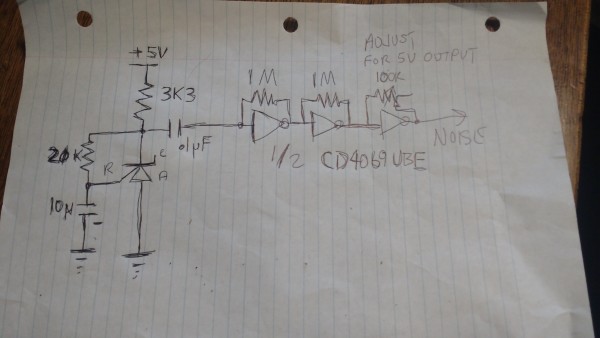

PostPosted: Fri Oct 21, 2022 3:59 pm    Post subject: 5V low voltage simple analogue noise generator Reply with quote  Mark this post and the followings unread
simple modification of the second image.
Runs on 5V
Naturally, add +5V for the CD4069UBE at Pin 14, and system ground at pin 7.
