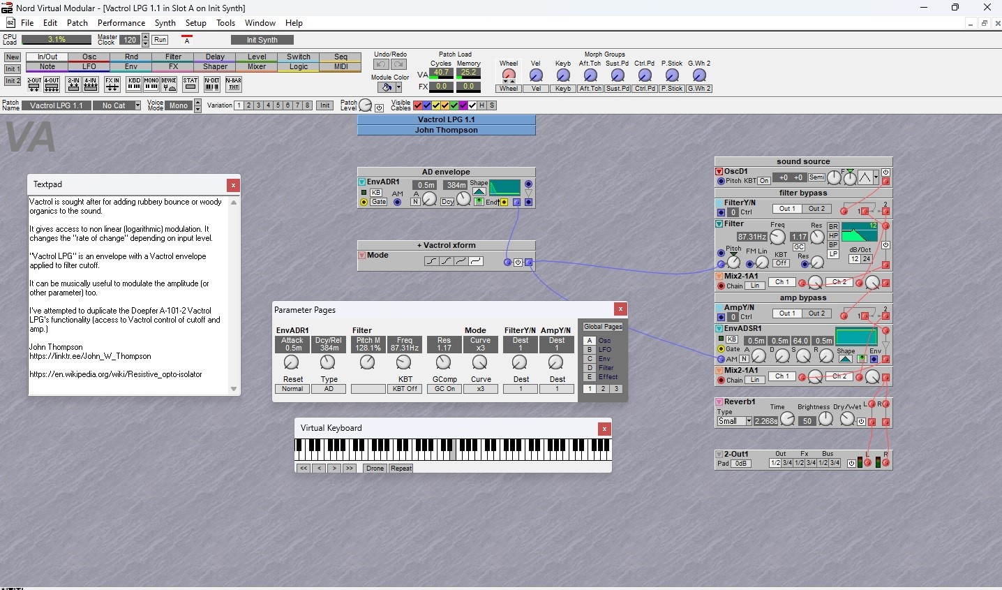

Info in the Textpad. The parameter page is set up.
V1.1 fixed amp and filter bypasses.
Variations to come.
