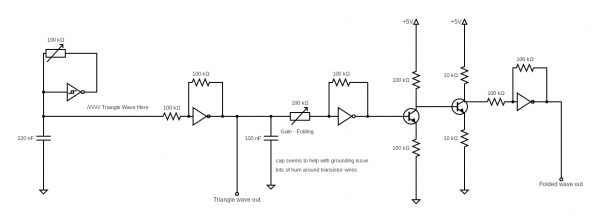

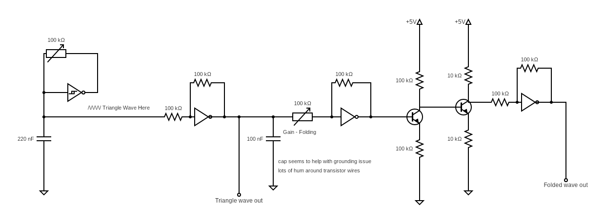

Hello all - It's been ages since I've breadboarded but I decided to get a new voice for my lunetta together this week in the form of a triangle wave and wave folder. Hoping someone can help with an annoying bug with it.
I'm following Elliot Williams https://hackaday.com/2015/03/09/logic-noise-sawing-away-with-analog-waveforms/
to create the triangle from a 40106, then buffering it (although using the 4049 as its what I have).
The wave folding is inspired by Moritz Klein who technically is designing 'proper' synth circuits with double pole supplies and so on https://www.youtube.com/watch?v=jbStEUfBWXY but I found the saturated transistor trick works on these triangle waves too (although only one way, which is fine).
I'm getting some great sounds out of this thing but its REALLY QUIET. I have a passive vactrol based 'VCA' to gate signals and it just crushes it to nothing. Even straight into the mixer its really quiet compared to my square wave oscillators. The square wave from the 40106 goes 0-5v but the triangle is like, a quarter of that?
Anyway - I'm thinking that I need to add gain somewhere, I've tried various input/feedback resistor combinations on the 4049 but none seem to actually amplify the signal - a limitation of using that chip as a psuedo amp?
I get the inkling that an op amp is required - I've ordered some LM358s as reading other posts on here say it's fine with single sided supplies but how do I configure it to boost the output wave? Inverting amplifier at the end of the chain just before the output? Any suggestions gratefully received!

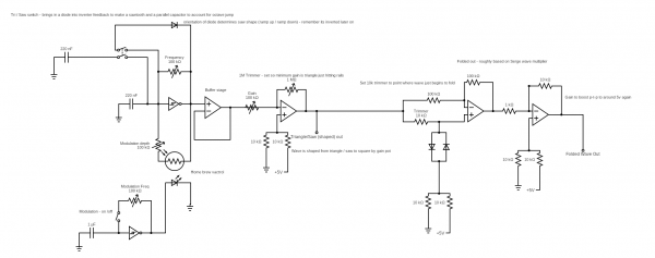

Solved! - Perhaps people would like to see how it's possible. It does involve using an op amp (a couple actually) which makes it moot whether it's a lunetta thing I suppose. I did wonder, half way through doing it, why I didn't just build a 'proper' triangle oscillator. I persisted because the rest of my set up is all single supply at 5v and this oscillator gives me a different voice that still interacts with my sequencer and 'vactrol controlled amplitude' and so on.

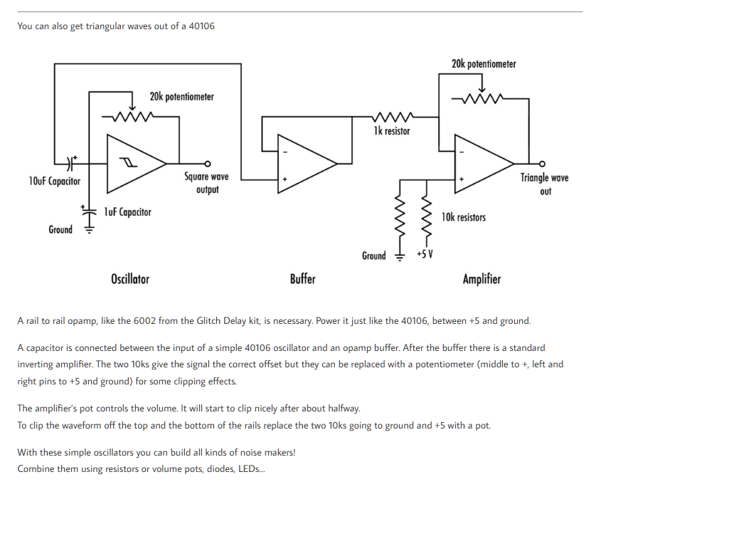

I found the answer here
https://bleeplabs.com/rad-fi-analog/
A 6002 op amp is used because it can go rail to rail. Here's their circuit first.

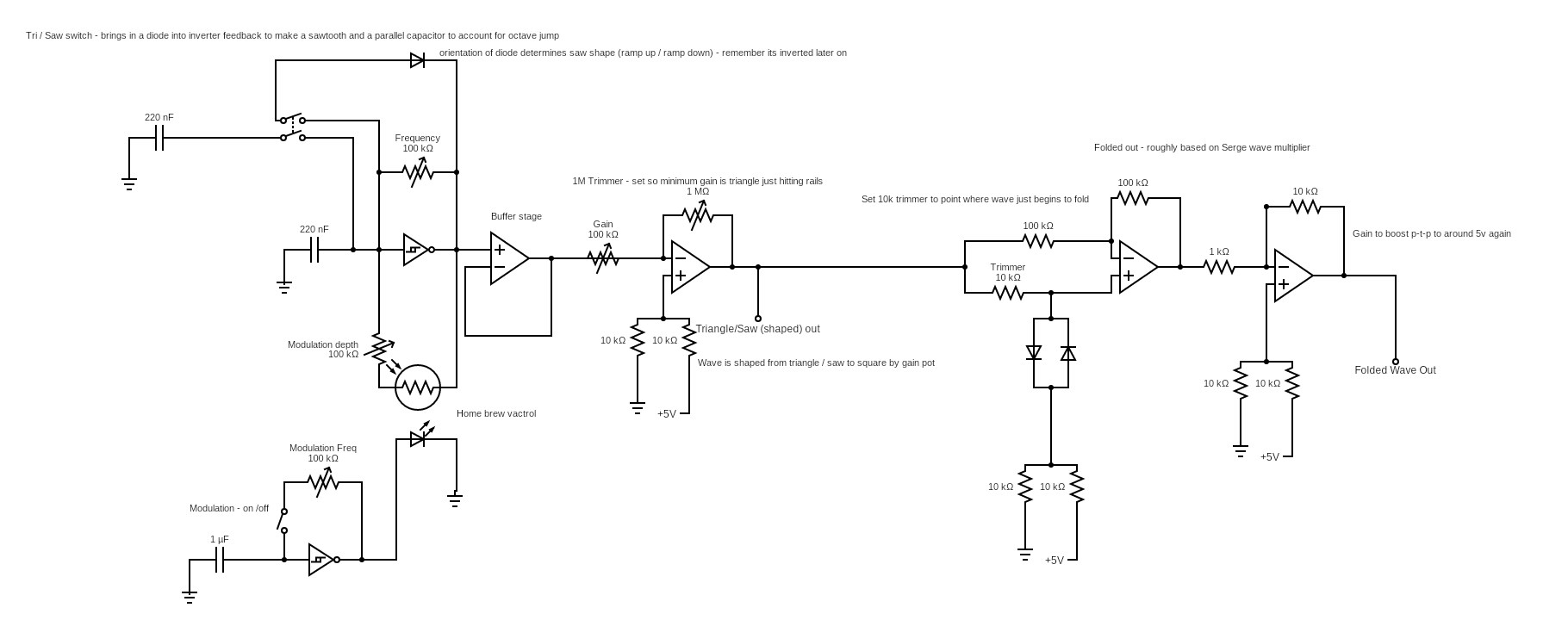

Then my modifications.
I swapped the gain control to be on the input of the op amp, rather than the feedback path. This way it can be vactrol controlled (because more light == more gain seemed more intuitive to me). I have a envelope generator that is a fading up and down led vactrol so it works with that.
The feedback path is a trimmer that can be set so the gain control shapes from triangle (or saw - see next point) to square wave. At minimum gain the triangle can be set with the trimmer to just touch the rails with a scope.
The wave is switchable between saw and triangle. A DPDT switch puts a diode in the feedback path of the inverter as per Elliot Williams:
BUT also puts an additional capacitor in parallel to the first to account for the octave jump that the diode creates (because the capacitor drains in half the time?)
The wave can be modulated by a slower oscillator - capacitor of 1uf gave me good FM type results that only just go sub-audio but it's just a suggested value. This is linked to a LDR-LED homebrew vactrol which goes 'across' the frequency pot of the first oscillator. I actually used a DPDT in my final design - to break the feedback path of the modulation oscillator and the connection of the LDR. The modulation depth pot in series with the LDR sets - I think - the maximum variation it can add to the frequency. This is important - put straight across the frequency pot the LDR swings min to max (100k).
Almost all these modifications are the results of hands on experimentation so my explanations may not be totally accurate!
Finally I tried to get the wavefolding with transistor working but it just didn't work (something to do with the op amplified wave already being 5v peak to peak???) as a last roll of the dice I tried the Serge op amp folding as explained by Aaron Lanterman:
https://www.youtube.com/watch?v=zL9ao3Uc3Yk
With a bit of tweaking - e.g. sending the diodes to an offset ground point I managed to get a bit of a wave folding effect - although it looks a bit odd on the scope. The 10k input trimmer had to be set to the point where the wave was just folding. At full gain it sort of goes into an odd spiky square. Aurally the 'overtones being added' effect is there so I was happy.
What I couldn't get to work was multiple stages...no idea why!
The final stage adds 10x gain (1k input, 10k feedback) to get the wave back to 5v peak to peak ish. You could be more sophisticated and add a trimmer here too.
Hopefully a fun circuit for someone. It was fun to breadboard up.

PostPosted: Wed Oct 30, 2024 12:29 pm    Post subject: Reply with quote  Mark this post and the followings unread
sorry I am late to the party,.. party!
I never really messed around much with the 4069UB (or 4049) but I don't think AC coupling would help you out.
As a matter of fact I believe that one of the reasons you see the 4069UB used as an amp in circuits like this is
that they are already correctly biased to work with a single supply. Assuming the signal you are working with
is biased around half that supply voltage.
The original 'triangle' signal will oscillate somewhere between 1/3 and 2/3 of the supply voltage caused by the
hysteresis of the 40106 schmitt trigger gates. (more precise values can likely be found in the datasheet).
With a 5V supply that would give you an amplitude of about 1.7V which is indeed a lot lower than a square
wave with a 5V amplitude. Also the average voltage is lower because it is a triangle (compare the surface area
of a triangle with the surface area of a square). And then there is just the sound itself which for a triangle
wave sounds much duller than a square wave (even if they have the same amplitude) so that would explain
why it sounds so soft.
Boosting it either with an opamp or one of those unbuffered gates works but I think that you're biggest problem
here is that with a 5V supply you don't really have much headroom. An LM358 is indeed very useful with a single
supply because the output can get very close to 0V however it can't get nearly as close to the supply voltage and
it gets worse if that voltage is already fairly low. Unbuffered gates like the 4069UB also have a limited output range
and I recall that it also has some weird non linear behavior above a certain amplitude.
(I think that's at least partially responsible for the characteristics of the WASP filter).
As you already mentioned the 6002 is a rail-to-rail opamp so that can help you out. Another solution could be to
use a higher supply voltage for buffering. If you keep the oscillator powered by 5V you could easily get the output
amplitude high enough with an LM358 powered by 12V. I am assuming you'd rather have everything powered by
5V though.
