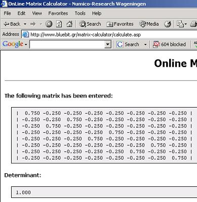

Fozzie
Joined: Jun 04, 2004 Posts: 875 Location: Near Wageningen, the Netherlands
G2 patch files: 49
Posted: Thu Jan 19, 2006 3:57 am Post subject:
Thanks Jan, I have already been studying matrix math voluntarily (this is quite extraordinary for me) a bit because of these patches. Unfortunately, a lot is still way over my head.
However, I won't let me stop by a bit of math of course, so I go for the practical approach. I found an online determinant calculator (see jpg for url), and tested wether my reasoning from my last post (householder stuff) indeed yields a matrix with determinant=1. Lo and behold .
I will soon try to make a real & usable reverb patch with this info. On a G2, an 8x8 matrix will be easily implementable, as it uses gains of .75 and .25 (which are easy to get with a gain knob on a mixer). Other matrices (10x10 or 12x12 need gains of .8 and 0.2 or .833333/and .166666/ respectively; this is harder to accomplish as the knobs cannot be set to these specific values). Ah well, 8x8 should be nice, possibly with some delay time modulation.
Does anyone know whether the delay outs are interpolated when the are modulated (this is necessary for succesful delay time modulation in this kind of reverb)?
| Description: |
| 8x8 householder matrix according to my functional math interpretation (well, at least it is a unitary matrix, hurray!) |
| Filesize: |
38.75 KB |
| Viewed: |
21510 Time(s) |
Joined: Apr 03, 2004 Posts: 24537 Location: The Netherlands, Enschede
Audio files: 299
Posted: Thu Jan 19, 2006 9:45 am Post subject:
When your determinant is not exactly 1 you can always cheat a bit by adding a gain amplifier/reducer stage before or after the matrix, this will need as many gain controls as the matrix is wide (or high) and you'll have to gang those.
This might ease things a bit as you'll only have to set the matrix coefficients ok relative to each other (and approximately to the right absolute value to avoid clipping).
This might be usefull anyway as a means to control the decay time ? _________________ Jan
