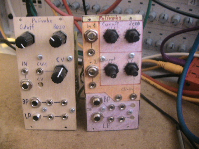

Hi there,
Bigtex asked me to post a Audiodemo when i have finished my Polivoksfilter,
so here it is.
It is my first Module made just out of a PCB.
After finishing the Module it din't worked because i forgot to solder a Bridge, so it took now some Time and help.
My Polivoksfilter is made with UAs776 instead of LM4250.
In the synthesizerforum.de they recommend to take this ones.
The sound seems to be much more character full
VCOs are two from Curetronic with 1Okt detune, and then just 1 VCA and the Envelop to the VCA. (both Doepfer).
I just tourned the Cutoff by Hand and sometimes i increased the Reso.
For Synths the Polivoks filter has a very Acidlike sound. The Curetronic VCOs also.
A soundfile i heard some days ago with Synthcom VCOs was complete different, but it was a modified Polivoks with Cv control for the Reso.
Must look if i can do this also to one of myne. ( i made two, but just one is in use. )
Attention: the Soundfile has very harsh Reso at some points. It's 256kb MP3, and a very simple prahse with no musical content, but ok to get an Impression for quick.
[Editor's note: see http://m.bareille.free.fr/modular1/vcf_polivoks/vcf_polivoks.htm --mosc]

That thing sounds great! So dirty and screechy. It barely sounds like a filter at all. Amazing.
When my next paycheck comes in, I'm ordering two of these and the parts! |

Yes, but anfortunatly the MP3 File is not the same as the wav.
I look that i can make some more Files.
But in the moment i'm not patching often, and when than with my BBD module from Doepfer.
Another one, good for a Demo  |

where did you order the UA776's from? conrad.fr?
michel _________________ Sneak-Thief - raw electrofunk |
synth_ollie
Joined: Sep 11, 2006 Posts: 149 Location: sweden
Posted: Thu Sep 14, 2006 2:31 pm Post subject:
| sneakthief wrote: | where did you order the UA776's from? conrad.fr?
I´ve used an ic called LS776CB (wich someone said is not exactly the same as UA776) that a friend of mine got from a company in u.k somewhere, however the vcf seems to work fine with that one too !
