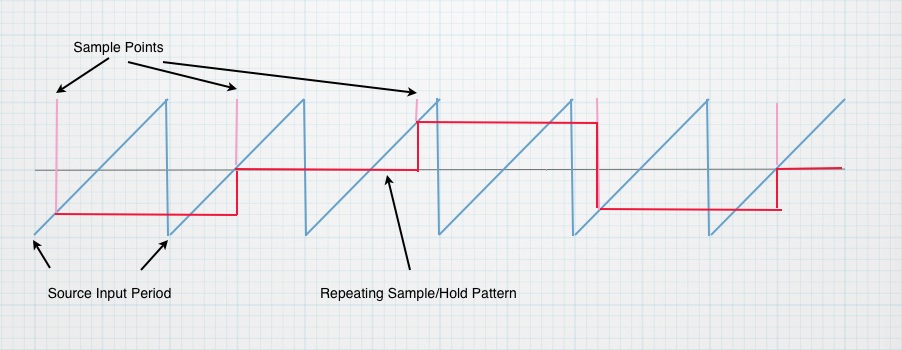

What I wanted to do with it, once I figured out it was rather stable, is to use it as a sample-and-hold source. Old hands here (should) know about regular pattern generation using sampling well (!) below the Nyquist frequency. Wink Razz Folks who are new to using a sample and hold, or have only used one with noise as the sample fodder, might find this interesting.
So instead of noise into a sample and hold, let's send a fairly regular and predictable source into a sample and hold, and let's see what the difference is. For my purposes, I use a sawtooth, as it gives us the greatest range of predictable source voltage. If you kind of know the ratio between your sample rate and the frequency of the input waveform, you can, with some theory, predict a S&H pattern. In practice, it isn't fully predictable, but Picture 7 should show why.

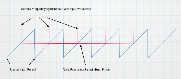

So as you can see in Picture 7, the S&H output voltage is a step function, because our sample frequency is close, but not exactly equal to, the source. If it was equal, the sample would be uninteresting (it would look like Picture 8...)
Anyway, it's fairly simple to explore, if you have a stable LFO, a stable clock for your S&H, and a fairly quick and accurate S&H. I don't need to belabour the technique, as it should be somewhat obvious from the pictures and the samples (oh yeah, here's what it sounds like). The sound sample has no extra delay at the beginning, but I pop some delay in the middle to add a shuffle to it, something to think about too. This is not like an arpeggiator. Trying to predict a S&H sequence would require a way to lock step the function generator and the S&H clock, and even then, visualising it is somewhat more like divining than really just doing it. Anyway, think about it, and enjoy your art.
