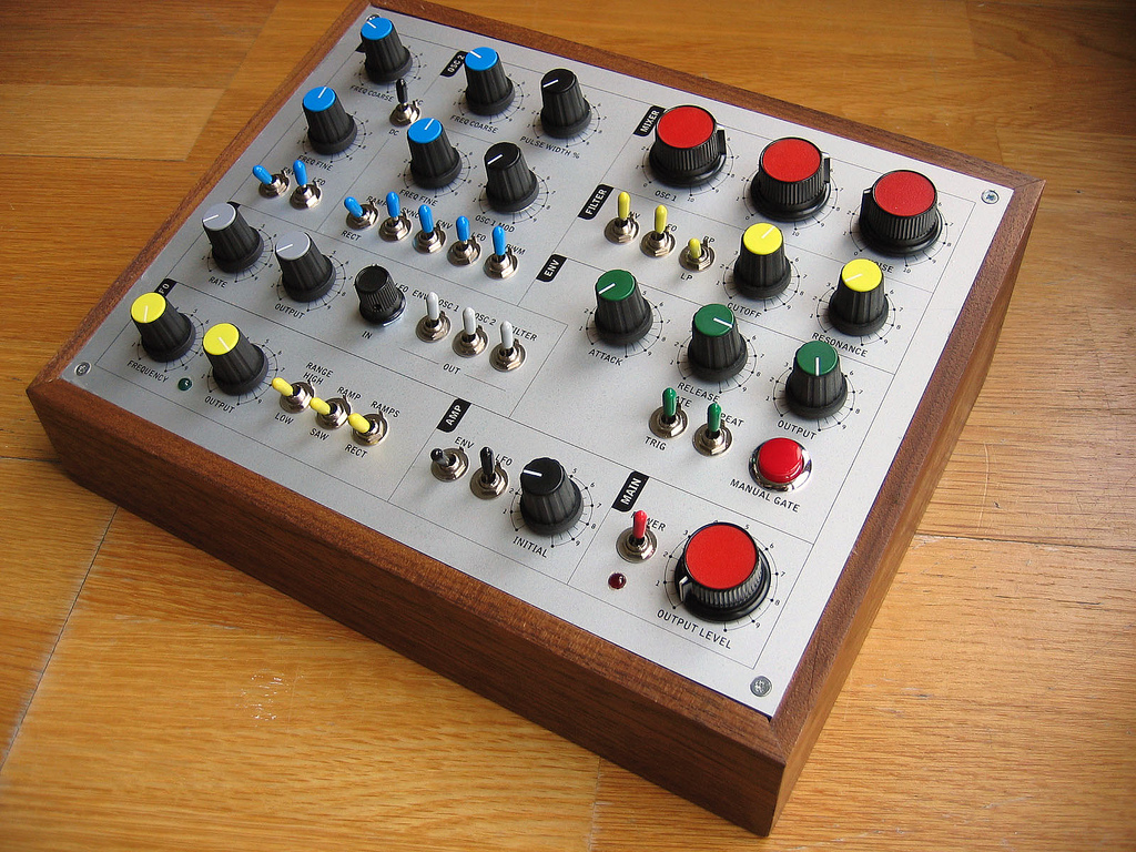

Finally finished my Soundlab
Page 1 of 1 [14 Posts]
Lemmy
Joined: Apr 12, 2007
Posts: 106
Location: London
PostPosted: Sat Feb 23, 2008 5:40 am    Post subject: Finally finished my Soundlab Reply with quote  Mark this post and the followings unread
It's a great sounding synth. Thanks Ray for sharing it with us!
I've also managed to learn a lot more about electronics thanks to this project and the helpful forum members here. (Specially Pehr, Randaleem, peterw, Zodiak and others. Thanks all. And Forrest Mims III Smile
In time-honoured tradition, here's a pic, and some audio - I put some Soundlab noises over an 808ish beat.
I made a Flickr set with a few more pics here:
http://www.flickr.com/gp/59792904@N00/9U6F0i
Phew. Well I think I might try to build something a bit simpler next time. Maybe one of those flashing LED Christmas trees? Wink

Very nice work Lemmy!
Is that a S&H you fitted in there?
Stylish, clean, professional lookin. Very Happy

PostPosted: Sat Feb 23, 2008 8:00 am    Post subject: Reply with quote  Mark this post and the followings unread
Yup, it's S&H Unkle. It adds a lot to the SL's sound range.
Bruce I know what you are saying, and I was thinking at one point of making a detatchable lid for the Soundlab with a sequencer built into it.
But for the moment I am going to put my feet up and bask in the glow of finishing the SL... And make some tunes... Not putting the soldering iron away just yet though Smile

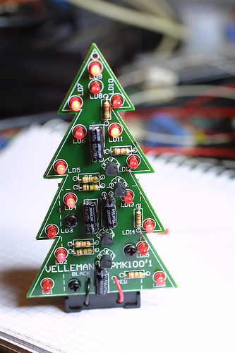

(Actually I'm thinking percussion once I've got time for a new project - DS8 or Thomas Henry? Any recommendations?)
My next project??

Nice one! What did you do the front panel with?

Hi Adam,
It's a Schaeffer.de aluminium plate without any engravings. The text is done with Lazertran water-slide decals that are baked on to the metal.
Lazertran is pretty fiddly but you can get OK results if you're patient. Here are my tips for using it.
1. Cut the transfer to be very slightly smaller than the plate. If the transfer hangs over the edge, it won't bake on properly.
2. Getting the transfer onto the metal plate in one piece can be tricky as its so fragile. The best way I found is to put the printed transfer into a basin of water upside down. Leave it just long enough for the water to soak through all of the paper backing. Then lift the transfer up, with it still on the paper backing. Put the whole thing face down onto your metal plate, then gently slide off the paper backing, leaving the transfer in place. If you need to move the transfer about on the plate, or smooth out bubbles, use lots of water. The tiniest bit of friction will tear it.
3. When the transfer is in place with all the bubbles smoothed out, leave it to dry.
4. Put it in the oven at the lowest possible heat for at least an hour - an hour and a half is better. I found if I closed the oven door, it was too hot and it started to bubble up. So I left the oven door very slightly ajar for the first hour and a half.
After that, the transfer should have settled onto the metal. Close the oven door and start increasing the heat slightly every 20 minutes or so for another hour and a half, or until there is a dull shine on the transfer. That tells you its baked on.
Having learnt all this the hard way, I think I'm going to look into screenprinting the next time. Smile

Thanks Lemmy, I though it might have been Lasertran but wasn't sure. I've tried to use it a couple of times but was not really successful. I had more success using press-n-peel but I've only ever done small panels.

What did you use for the Midi->cv part?

It was Marc Bareille's midi->cv circuit, on his site here: http://m.bareille.free.fr/
You can find some details about using the aux cv to control the filter cutoff in another thread I started.
