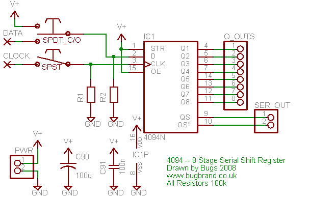

anyone have any schematics for the use of a 4094 8bit shift reg w/ storage? from the xTimer schematics via google it looks like its easily usable for a LED clock (maybe even its intended purpose originally?).. anyway I'm trying to decode what this chip actually does in plain english (so far I have shift and store registers (bits) and strobe function that 'replays' these bits??), seems like a very useful chip though, if i can figure out a good lunetta application especially!! gotta admit it gets really confusing with the EO, strobe, and serial outputs. i think i understand the basics of the chip.. basically at stage 0 the input (D) is latched, and outputs these registers (while EO is high) until the next D is received? im just thinking in terms of what youd want to do with an LED clock..
i see there are serial as well as parallel outputs, are these 2 4bit outs? this is where the picture gets muddy to me.. maybe ill just include this chip and patch every pin except ground and voltage+, although not knowing how it works exactly is gonna make it hard to use, but ups the randomness factor i guess..
how are people using this chip in a lunetta module?

I use the 4094 a lot in my patches.
I think I have a drawing Tom Bugs did of using the 4094 in a Lunetta - when I get home I'll post it if I can find it.
It's pretty much the same drill for most chips - run the in and outs to front panel jacks. I have 100K resistors to ground on all my chip inputs. On outputs I generally have an LED with a resistor (from 10k to 47k) to ground. The visual indication is very helpful in seeing what these chips are doing. (and besides, we like blinky lights.)
If you need to hold something high or low to enable a function on the chip tie it to V+ or Ground with a 100K - or perhaps run it to a front panel switch or jack - or both.
Clock the inputs (Data, Strobe, Clock) from other chips outputs, or from 40106 clocks, or your VCO's...and use the various outputs of the 4094 to clock other clocks, or for input to an R/2R ladder - (which is a simple Digital to Analog converter) ..which you run to a VCO.

Here's Tom Bugs drawing for the 4094 that he posted publicly some time back....
 Filesize:  124.14 KB
 Viewed:  1205 Time(s)

Bruce - are you using the Serial and Not-serial outs at all? Lemme know as I'll be building one of these soon. Smile

I use this as well, but I'm still trynig to get the most from it. At the best of times the QS and QS* outs give me nice meaty bits. I think a high value on strobe releases the latched data? It's funny that i was studying that last night. Smile

Yep - Although not in any intelligent way. Like drofset - just like other outputs..except they are sometimes 'meatier' Laughing
I was thinking today after I first replied to this thread that I should try using them for cascading to the next 4094... I think that's what they are there for but I've never even tried that.
I had the switches Bugs suggested on the first Lunetta I built - but I left them off most recently. Have not miss them at all.

Sweet just what i was looking for .. another good bug circuit =D Somehow I did not have this one and searched on the 4094 a number of times on E-M and Google.. Thanks RF!!! I'll be implementing at least one of these tonight!
