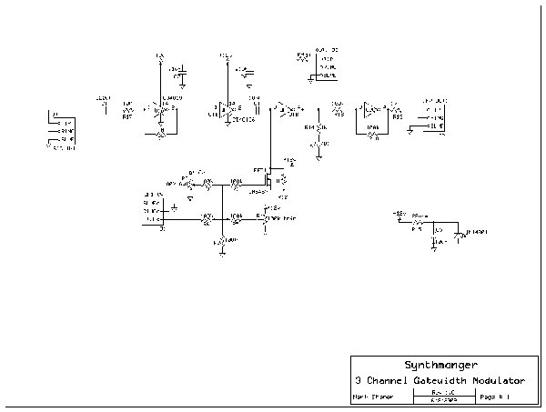

I redesigned my Lunetta-esque pulsewidth modulator circuit into something a bit beefier, easier to control and a heck of a lot more fun to play with!
I've been troubled for a while now getting good pulsewidth modulation out of the 40106 chip and I've found the solution today by using FETS over NPN/PNPs.
The controls for the PWM are as follows:
CV input and manual frequency control for each channel
Input for each channel
Output and non inverted output for each channel with LED indicator
It's finished now and I'm going to be working on the PCB/schem as well as a new scope/audio demo this week.
To make this thread worthy I've included an audio clip. The input signal is running through a frequency divider whose /2 /4 /8 outputs are running into each channel. I'm using one triangle or noise output from my triple Modulation source (think CGS Pyscho LFO but CVable and insane) to control the PW. The PWM outputs are mixed together at different levels through an external mixer. The levels sound like they're being faded in and out but thats just due to the width of the signal being hardly audible.

Added a schematic!
It accepts just about any input signal. Works splendidly for gate signals and low frequencies, not so good with mid-high frequencies.

so you are using a FET to creat a variable resistance!? great.
thanks for sharing. i almost missed it Shocked
synthmonger
Joined: Nov 16, 2006
Posts: 578
Location: flada
PostPosted: Sun Jun 14, 2009 3:39 pm    Post subject: Reply with quote  Mark this post and the followings unread
Yep! It works better than any PNP/NPN combo. I tried it with a few other circuits. One of them was the Resonator. I replaced the vactrols with two Fets and it worked kind of ok. I think my use of 4007's instead of the vactrols worked better.

Looks like this is what I need, I think.
Questions
Can it operate as a simple gate strecher if I left off the CV circuitry?
Should there be a dot at the junction of R6 - R5 joining them to the FET input?
I'm assuming R8 is the width control
George
synthmonger
Posts: 578
Location: flada
PostPosted: Wed Jun 17, 2009 2:34 pm    Post subject: Reply with quote  Mark this post and the followings unread
No but you can go here for that
http://www.musicfromouterspace.com/analogsynth/mmlogic.html
You can change the polarity of the width modulation by tieing the 1M resistor and fet D to ground instead of V+ which would do this also, but thats what the inverted output is for Wink
