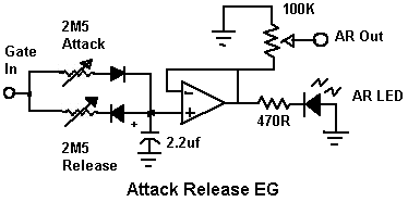

Anyways, I would like to create a gate/AR envelope for use with this VCO, so I've been trying to think of how I would trigger the AR... I guess I don't quite understand how I would use the trigger/gate and would love if someone could explain this to me in detail.

its a good idea to start building with simple circuits, so you are certainly on the right track. The 1st circuit you posted would be hard to control with a voltage source (like the AR EG).
The AR EG needs a gate signal to work, which is a (say) 5V voltage that stays at 5V for as long as you need it to, then it returns to 0V.
The simplest way to achieve this is with a momentary switch wired to +V on one side and to the gate input on the other (via a resistor, say 10k, would be nice)

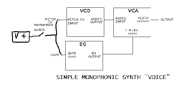

I think this is what you are trying to do...
Hope it helps.
Block Diagram of a Simple Monophonic Synthesizer Voice

So if I were to have a momentary switch would it look something like this?
i feel like this is wrong, so feedback would be nice

Well, I'd bet it won't do what you want it to do ... However, build it and see, perhaps I'm wrong.
What I see happening is this - when the switch is closed, the EG is started and the VCO pitch is set to whatever V+ means to it. while the switch remains closed, the EG goes through it's cycle. Once the switch is opened, the VCO pitch will do ??? because with the switch open it really has no input, so the pitch could be anything.

Okay, well this is what my understanding of the circuit is...
The voltage in sets the pitch of the oscillator
I also need voltage fed to the gate in to trigger the envelope which is sent to the VCA controlling the output level.
and just for simple learning purposes i want to use a momentary switch to do this
wouldn't the switch need to be able to send voltage to the oscillator (pretend there is a resistor controlling the voltage to the oscillator after the momentary switch?) and gate in in order to trigger both blocks?

PostPosted: Wed Nov 17, 2010 6:41 pm    Post subject: Reply with quote  Mark this post and the followings unread
What would be more interesting is to vary the pitch independantly from the gate signal. Even something like a pot delivering a voltage to the pitch CV input of the VCO.

Ah, I see, so I would have constant voltage to the VCO, and use the momentary switch for ONLY the gate, am I right?

Yes, but the VCO pitch CV doesn't have to remain constant. If you supply that voltage using a pot, if you change the pot while GATE is on, then the pitch will change.

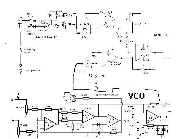

So far I have something looking like this:

The GATE is a voltage, but sort of special. It's either on or off. It is considered more of a logic signal than anything else and often it's input range is confined. Many systems use 5 volt gate, others use 10 or even 15 volts. However, as I stated, it is an "on or off" signal, meaning that the voltage is either "high" or it should be zero. "high" being what the circuit expects for gate - if it expects 5 volts, then use no more than 5.
For this example, let's assume the GATE needs to be 5 volts for "on" and zero volts for "off".
The diagram below is an example of how this is achieved with a switch. When the switch is OPEN, GATE is _ON_. When the switch is CLOSED, GATE is _OFF_
