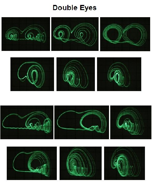

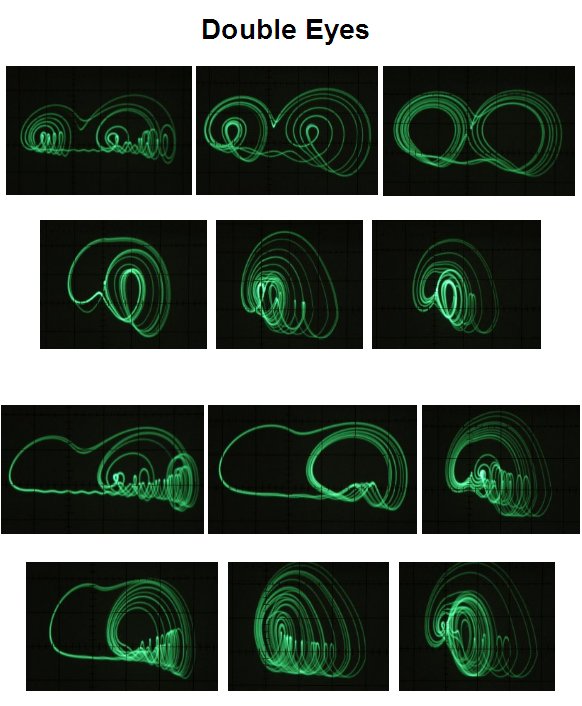

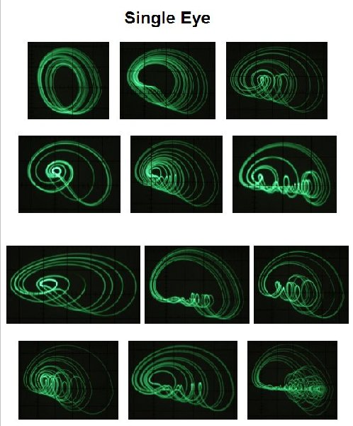

Chaotica is an expanded and improved autonomous third order chaos circuit. The features of Chaotica are:
1.) A third order system with a total of four nonlinear elements in the circuit path to provide a wide range of chaotic signals. One of the elements is a comparator circuit which can be switched in to provide double-eye signals, similar to Chua, Lorentz and ChaQuo.
2.) Expo VC of rate (frequency) over a wide range from creeping LFO rates to well up into the audio range.
3.) Lin VC of loop damping, gain and offset. Many interesting sweep and modulation effects here.
4.) A Reset/Inhibit input which allows the system to be set to zero at all stages. This has many interesting uses; eg, the chaos path's evolution can be followed by varying the reset rate.
5.) Output for all three system variables, x, y and z.
I am attaching a couple of composite photos showing a range of patterns I've gotten.

some of those single eyes look like brains and embryos. super cool!
inlifeindeath
Joined: Apr 02, 2010
Posts: 316
Location: Albuquerque, NM
PostPosted: Mon Jan 24, 2011 10:22 am    Post subject: Reply with quote  Mark this post and the followings unread
also, nautilus shells!

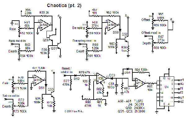

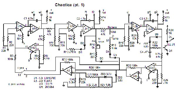

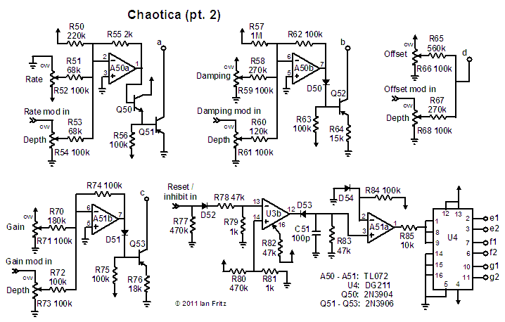

Here are the schematics. Part 1 is the main generator and part 2 is the control sections.
There have been a couple of changes since the OP. The comparator nonlinearity has been replaced with my x-x^3 circuit. And an overload indicator, lighting up when x>8V, has been added.
Ian

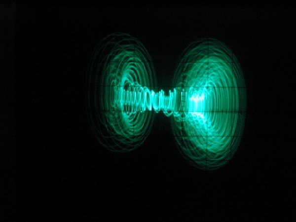

The scope shots usually seen for chaotic systems are projections onto a plane. IOW, if you see an x-y shot, like those above, it is as if the whole signal path (the chaotic attractor) had been squished flat like a pancake.
Poincare sections, OTOH are cross-sectional slices of the attractor, for example a map of all the x-y points where the third signal (z) crosses a fixed value. These are easy to extract using S&H circuits, such as the TGTSH.
The figure below shows an attractor from Chaotica with its z=0 Poincare map -- the dots -- superimposed. There are two sets of dots, one for positive-going crossings and the other for negative-going ones.
The mp3 has the x and y output voltages controlling the VCO pitch of two voices. The crossing plane is slowly ramped down with a Saw signal controlling the TGTSH threshold. Thus, the full attractor is traced out, one cross section at a time. The first part of the clip is the upward crossings and conversely for the second part.
It's always a surprise to see how thin the Poincare sections are. The attractors themselves are not big blobby things but rather thin sheets and ribbons that are wrapped around in three-dimensional space.

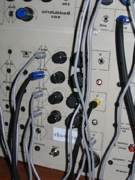

haven't got it quite working perfectly, removed the reset FETs when trouble-shooting, but so far it is proving to be quite a character (=mad)
added leds for X-Y outputs
Thanks for sharing this Ian
