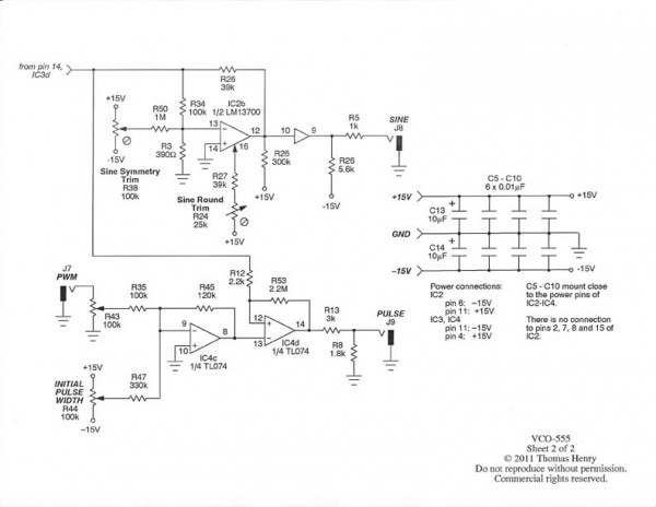

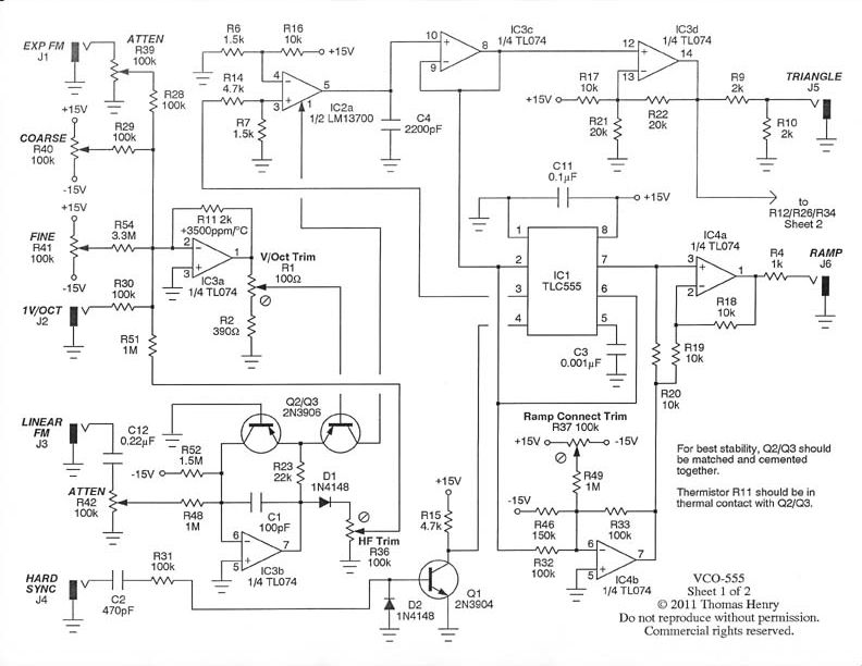

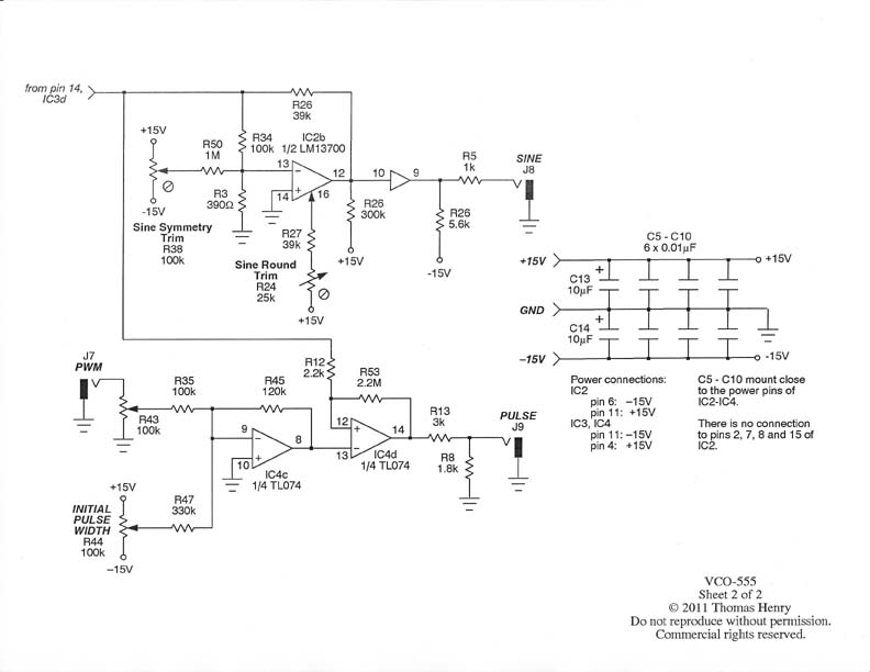

Hi all,
As alluded to previously, I have four projects that have been sitting around way too long and have been panting to get out the door for the past couple of years.
So, here's the first: a VCO using easy to find parts. If I may be so immodest, this is my best design to date. The waveforms look great and if you check the measurements, below, you'll see it's the most accurate I've ever come up with. If I were younger and had more energy, I'd turn this into an article and make some moolah from it. Unfortunately, my strength for such endeavors is ebbing, so instead I'll post it here for you to play with. All I ask is that you respect the rights and don't republish the design or rip it off for any commercial purposes. I'm not opposed to someone doing a PCB for noncommercial uses, but please secure permission from me first.
Okay, without that out of the way, here's the dope. My favorite VCO of all times is the CEM3340, and I've always wanted to approximate it somehow. After nearly thirty years, I finally have a design which comes the closest. The accuracy on my breadboard was very good.
There are ramp, triangle, pulse and sine outputs, all of which are decent looking. The sync is a real treat and basically comes along for free. And, of course, there are the usual VCO features such as coarse and fine tuning, exponential and linear FM, etc. If you're looking for cleverness, then be sure to check out how I did the sync, the ramp, and buffered the sine to keep the chip count down.
So there it is. Have fun with it and be sure to post your results here. Three modules are in the wings and should be out the door in the next week or so. And then school starts yet again and another year evaporates...
Thomas Henry

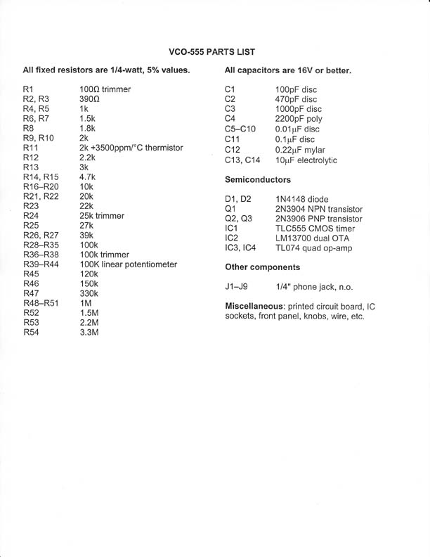

Parts List
 Filesize:  42.74 KB
 Viewed:  8268 Time(s)

following the schematic it looks like a normal OTA based VCO and then suddenly there is a 555 in the middle Shocked
Peake
Joined: Jun 29, 2007
Posts: 1113
Location: Loss Angeles
PostPosted: Tue Aug 07, 2012 12:00 pm    Post subject: Reply with quote  Mark this post and the followings unread
andrewF wrote:
its great!
Exactly Laughing
I've gotta build some of these just because it's the 555 turned into something entirely new. Yay Thomas!

andrewF wrote:
its great!
Yes, the 555 is being used as the current-reversing switch in a standard (EN) core design. The novel and very clever parts are the almost free reset and saw waveshaper.
Good work!

Been busy to get the schematic into Eagle, definitely non-commercial effort. I make too much money in my day job and value my family too high to start a half assed commercial business off of the work of someone else Very Happy
Let me know if you find any funny stuff (there will be plenty) or better yet, correct it yourself and post the file here Cool

Would like to mention that 'sync' (re-)sets the loading current here, not the entire waveform, so you don't have the usual hardsync.
If hardsync is desired some extension to the circuit would be nessecary.For inspiration have a look at the bassdrum of the TR909(sic!)!
