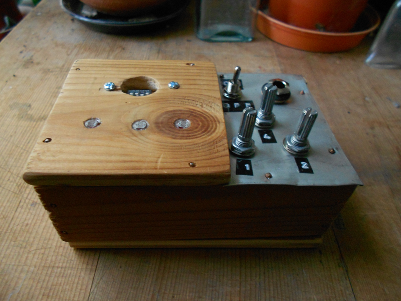

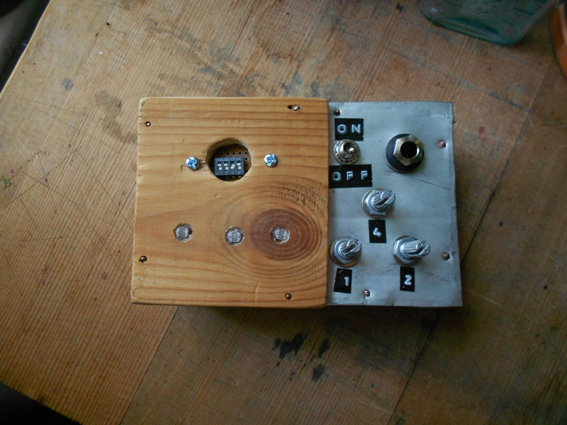

This is my latest simple sound machine, works on a similar principle to my logic multiplex but with slightly altered functionality and greater depth of LFO control.
Schematics and photos are attached along with a sound demo Smile
It utilizes a 40106 schmitt inverter to make 3 light controlled oscillators with LDRs (Light Dependant Resistors) and 3 LFOs which just use pots. These are connected to a 4051 multiplexer connected as a programmable gate or "ANY" gate. I had a DIP switch in some old electronics which I used as the switches in the diagram below. Scavenged wood and metal were used too, for the box Smile
P.S. it is also for sale!
