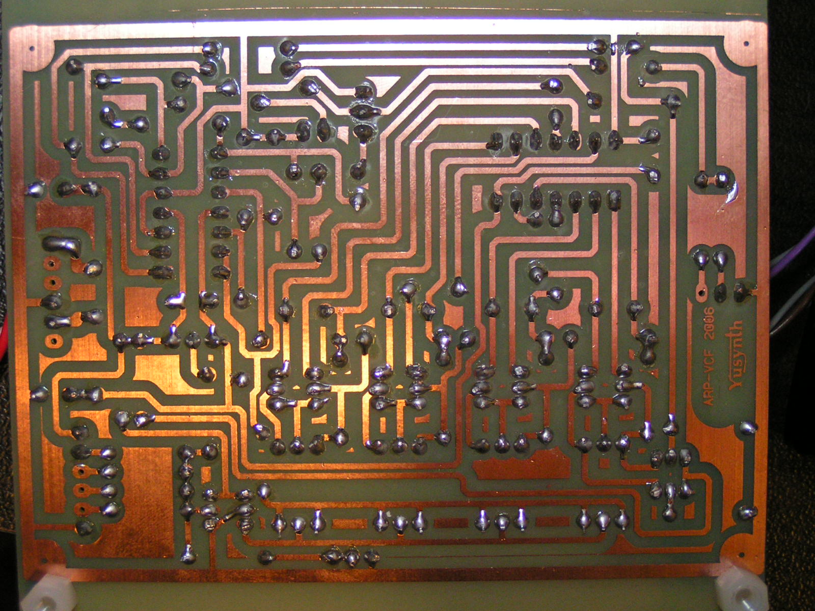

Hi
does the self osc suppose to clip when i put the reso all the way up?
it reaching to the red lines in my sound card, but hard.
is there any way to reduce the gain of the self osc?
one more thing...it seems i cant get more then 14.5khz when self oscillating.
can i get it to 20khz?
Isak E.

PostPosted: Wed Jun 19, 2013 4:19 am    Post subject: Reply with quote  Mark this post and the followings unread
1-No I don't remember it would clip, normally it's a nice sinewave but with a very large amplitude.
2-That's the normal behaviour of this filter

PostPosted: Thu Jun 20, 2013 3:11 pm    Post subject: Reply with quote  Mark this post and the followings unread
ok, i did some tests and pics..
this is the pic of the clipping..
and this is the sine wave in different freq position.. (no VCA, straight from VCF).
any idea or help please?

PostPosted: Thu Jun 20, 2013 11:16 pm    Post subject: Reply with quote  Mark this post and the followings unread
OK, therefore the auto-oscillation is not clipped in the filter but by your audio recording board. If you look at the scope you'll see that the signal level is something like 8 to 10V peak to peak, this correspond to an audio level of something between +10dBU to +14dB.That's completely normal, signals and CV in modulars are way up the so-called audio-range. That is the output signal of a module MUST be attenuated (at least 8 times) before being fed to a normal audio device.
Now I am puzzled by the waveshape you show for the highest frequency auto-oscillation getting a quasi triangle shape.
Which type of power-supply are you using ?

PostPosted: Fri Jun 21, 2013 1:56 am    Post subject: Reply with quote  Mark this post and the followings unread
Thanks.
So at the output of the VCF do I need to increas the output resistor (R42)?
I'm using the MFOS wallwart power supply.
15V.
http://www.musicfromouterspace.com/analogsynth_new/WALLWARTSUPPLY/WALLWARTSUPPLY.php
In another MFOS VCF it's all ok, no prob at all at high freq.

OK doesn't seem to be a problem with the probe. I am puzzled. Can you post photos of your PCB (good resolution) so we can check there's no mistake.
Yves
for sure! thank you for that.
i hope my old Minolta camera will do the job
