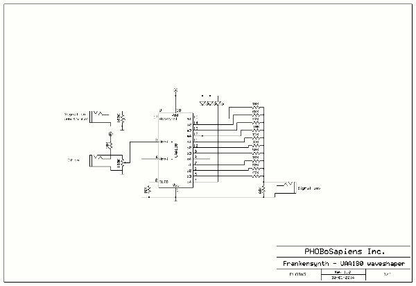

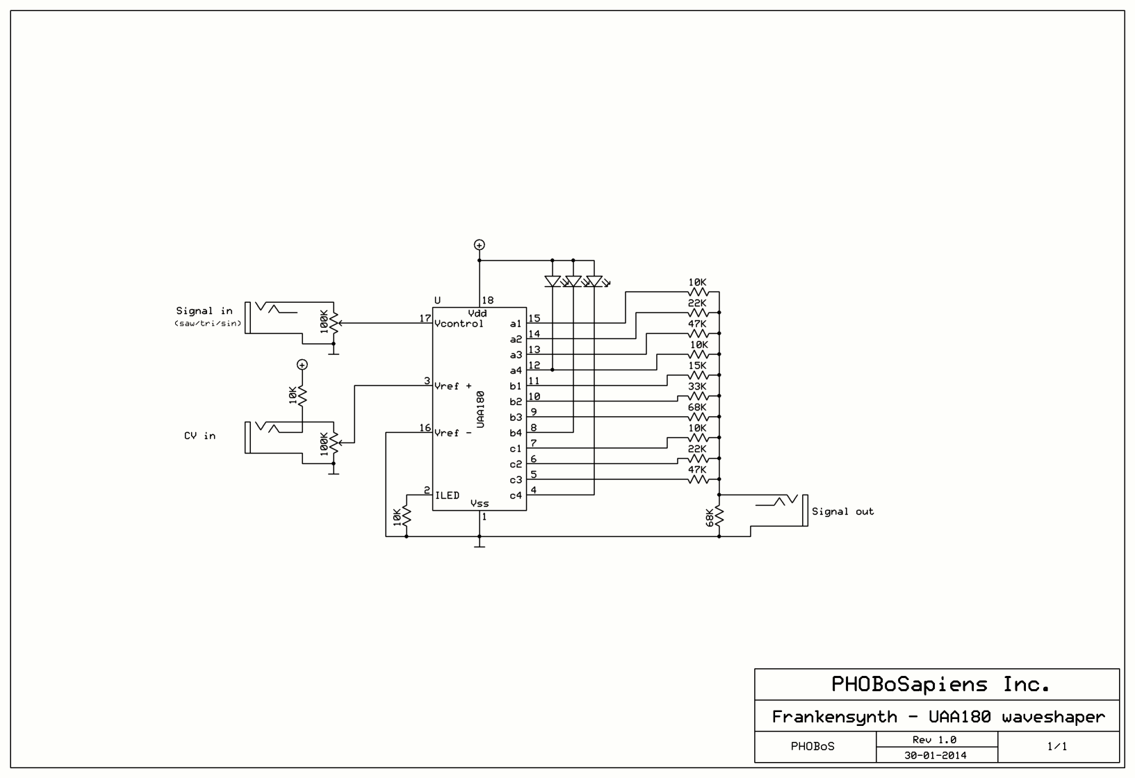

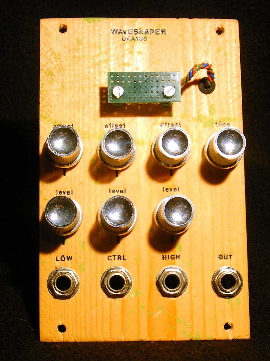

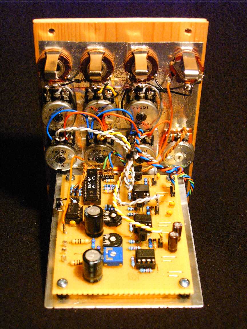

I have a box with old circuits, some are fully functional others are missing some parts (I suspect a lot you have a box like this), so I want to try if I can
make a synth using some of those circuits. A lot of them aren't directly audio related, but I have things like a light chaser which could easily be turned
into a sequencer by adding some potentiometers to the outputs. The LED matrix I used for the LED-O-SCOPE also came from that box.
One of the circuits is, or was, a 12 LED thermometer which was not much more then 1 chip, 2 trimpots, 2 resistors, an NTC and twelve LEDs. The
trimpots were allready missing and after doing a quick test I decided to just resolder the chip and plug it into my breadboard, instead of soldering
a wire to almost every leg.
The chip is a UAA180 12 LED bar driver, which is somewhat similar to an LM3914 but with 12 outputs which are connected to 3 groups of 4 LED's in
series. I could make some sort of voltage controlled sequencer out of it but that would require 12 pots and since the ouputs aren't simply on/off

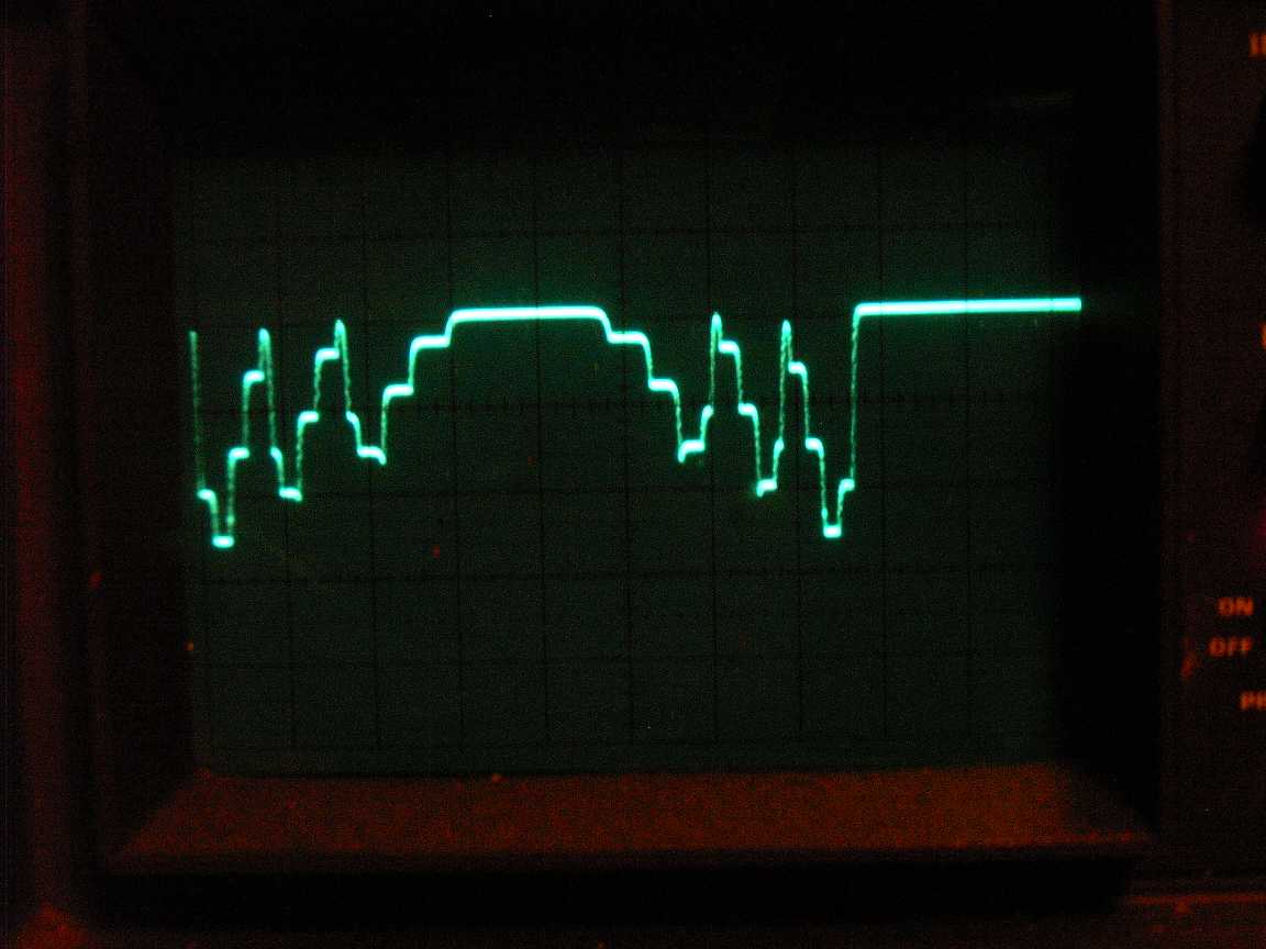

it's probably not so easy to do. Instead I tried if it would be useful as a waveshaper by connecting some resistors to the outputs and feeding it
with a triangle wave. Well, that actually works pretty good and by adjusting the range (Vref max) you get some very interesting effects.
I think it's probably similar to the 5-pulser, but I don't have one so can't say for sure and this one probably has a lot more steps.
I did start on adding a CV mixer but without having idea of what the voltage of the input signals will be that's rather pointless. And with just
two attenuators on the inputs (Vref max, Vcontrol) it actually works pretty good. Here's a screenshot from a test with a trianglewave input (I
thought it was only a positive voltage but turned out to be negative aswell, glad I didn't fry the chip with that Shocked )
you can hear it in action in Alien Spoonbending.
UAA180 waveshaper test with trianglewave input
 Filesize:  54.98 KB
 Viewed:  935 Time(s)
UAA180 waveshaper
 Filesize:  43.91 KB
 Viewed:  1316 Time(s)

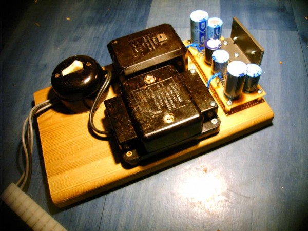

PostPosted: Thu Jan 30, 2014 3:22 pm    Post subject: Frankensynth PSU Reply with quote  Mark this post and the followings unread

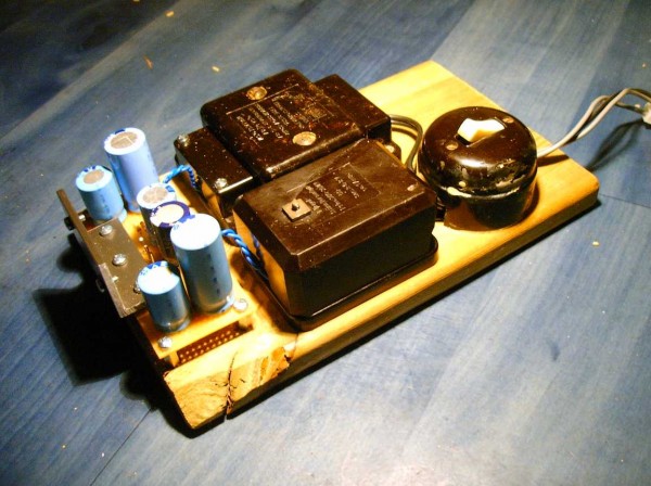

So I put the waveshaper aside for now and started with something else that's very important, the PSU. I'm going to use a dual supply but will
keep the voltage low enough so I can still power (CMOS) chips from the positive and negative supply rail (at least I think that should work). I
looked through some old transformers to see if there was anything useful, and I have 2 doorbell transformers that might work. The small one is
rated 1A the big one 0.5A and they both have 3V-5V-8V outputs (allthough the big one seems to be higher then that).
To regulate the voltage I choose transistor regulators using some older transistors (BD139/BD140). And with an 8.2V zenerdiode attached to the
base I get an output voltage of 7.5V, which is perfect Very Happy I used a bunch of old capacitors (I don't care that they might be dried up,. that'll just add
character to the sound clown ) and I found a nice power switch. I have an idea for an indicatorlight which I'll try to add tomorrow. There's also a big
gap in one of the transformers which gives access to the mains, so I need to cover that somehow. And I will probably need to add a bigger heatsink
so I made some threaded holes in the one that's on in it now which allows me to to just screw something on to it later.

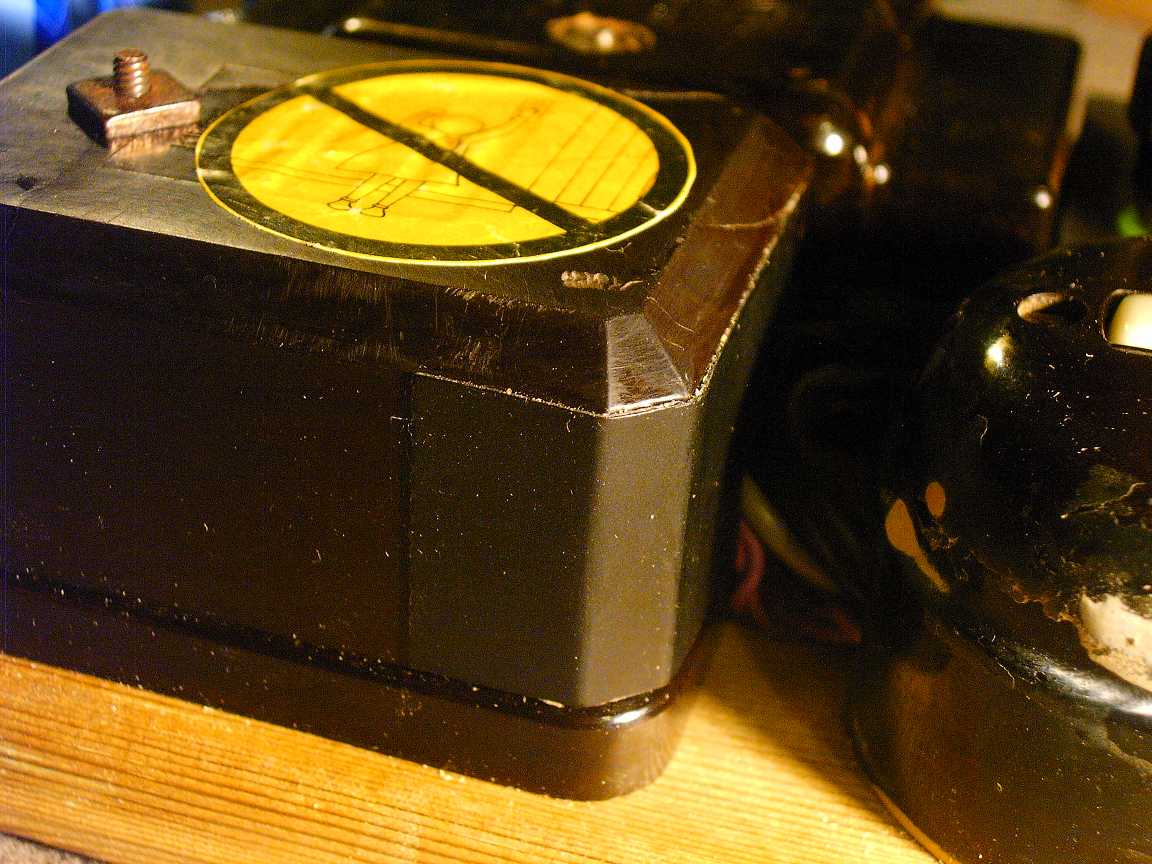

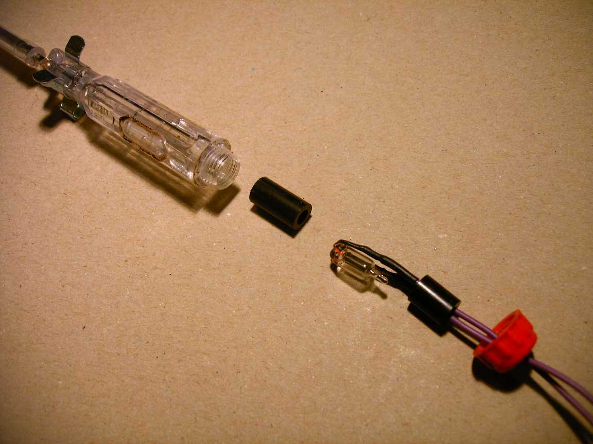

Posts: 5921

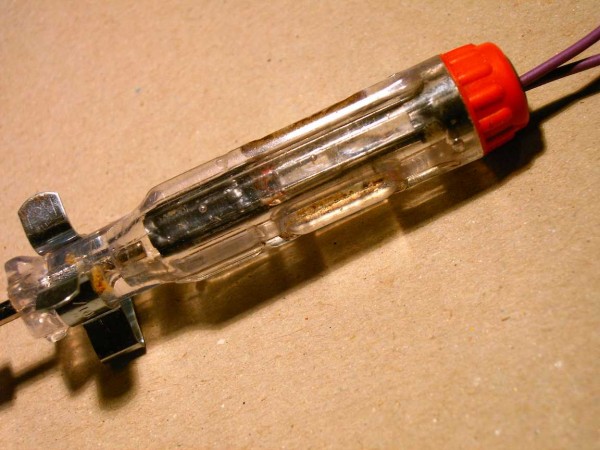

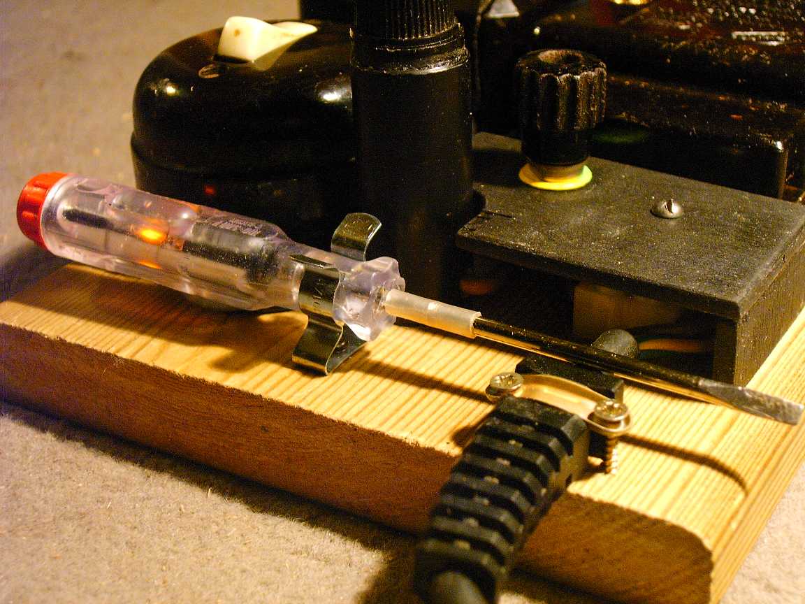

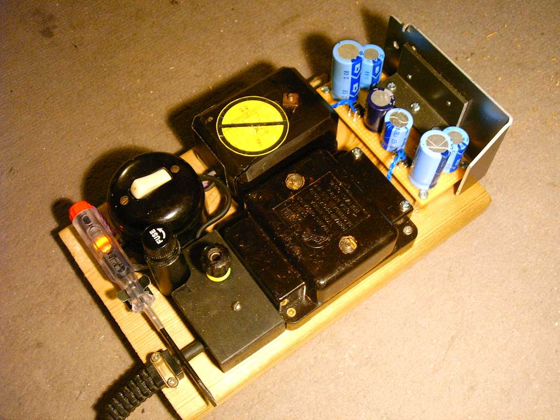

PostPosted: Fri Jan 31, 2014 1:14 pm    Post subject: Reply with quote  Mark this post and the followings unread
I installed the power indicator, made from a test screwdriver (with a neon light) Laughing I was trying to figure out how to connect the power to it and keep
it safe (was thinking of cutting a part of), untill I found out that you could easily take the light out. So I just soldered 2 wires to it and used some
plastic spacers to keep it from touching anything that could make it unsafe.

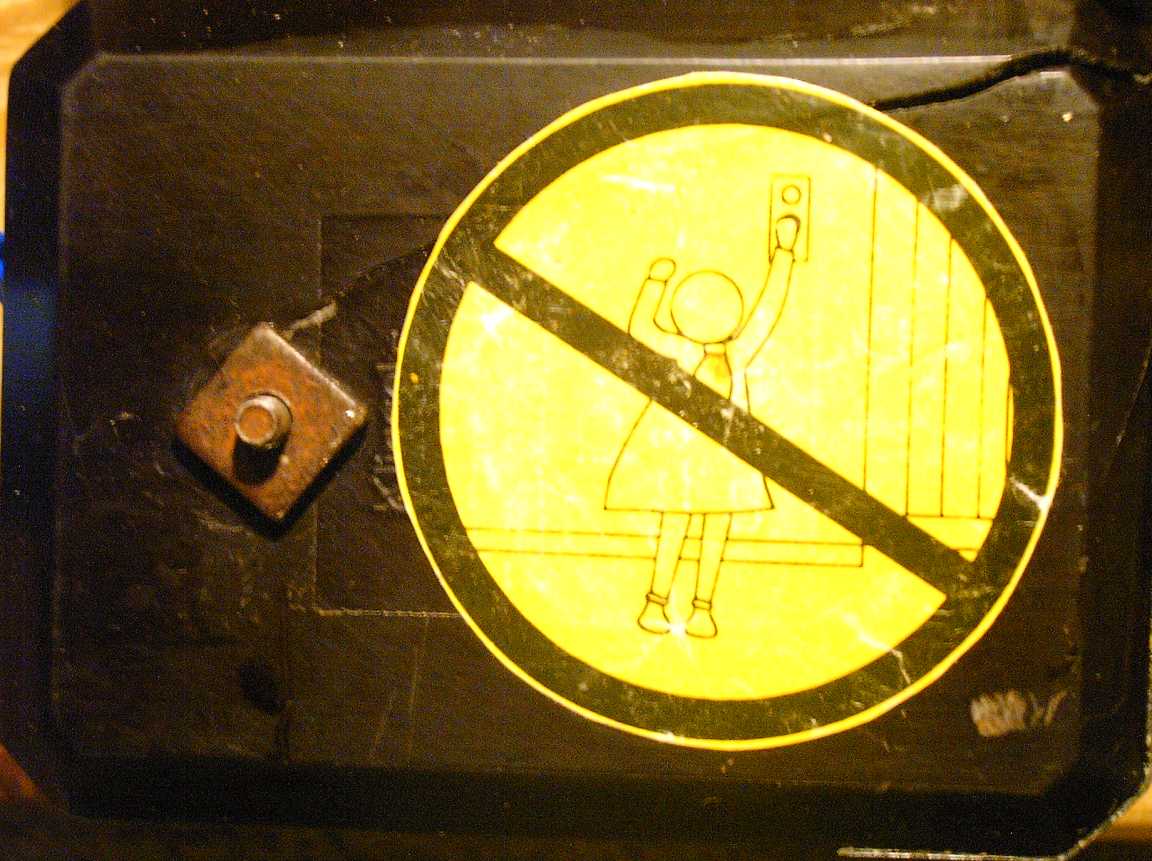

I fixed the gap in the transformer by attaching a piece of thin plastic. There is still a crack in it but it's pretty small and less dangerous then a standard
wallsocket. And I found a suitable safety sticker to put on it. Wink I also added a fuseholder and secured the mains wire. Oh and I attached a piece of
scrapmetal for a bigger heatsink.

Posts: 5921
PostPosted: Fri Jan 31, 2014 1:15 pm    Post subject: Frankensynth PSU Reply with quote  Mark this post and the followings unread
and here's a photo of the complete PSU Cool

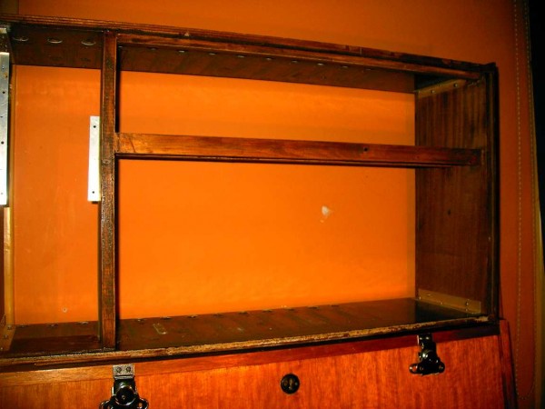

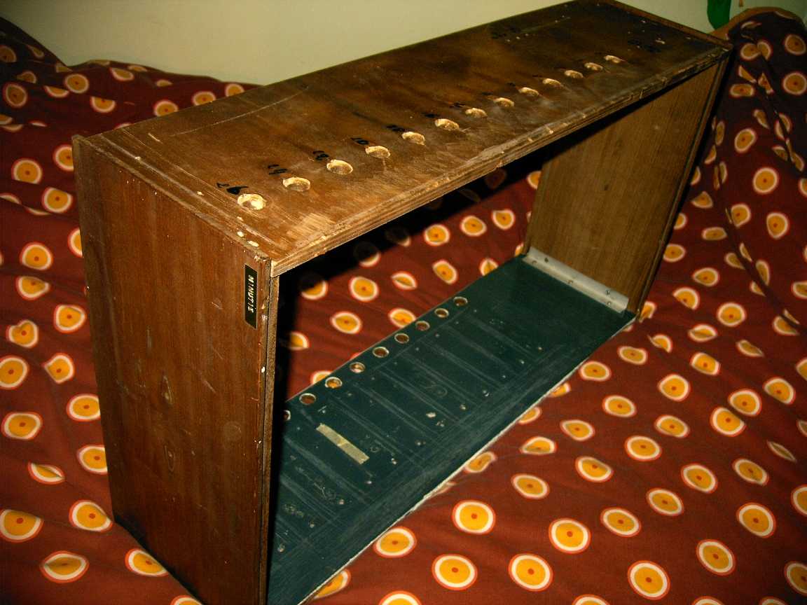

PostPosted: Sat Feb 01, 2014 10:48 am    Post subject: Frankensynth monster case Reply with quote  Mark this post and the followings unread
I put some scrap together to make a monster case (it's pretty big). The sides are old drawer fronts, the top and bottom are cut from what was the old
bellboard of the appartment building I live in (I asked if I could have it for the switches when they replaced it). So there are a lot of holes in it to provide
some fresh air. Laughing The aluminium corner brackets are also some scrap I had, and they were already cut and drilled.
Not sure about the backside, I think I have some hardboard that's large enough and the sides allready have some convenient slits that could hold it in
place. I will need to add some extra support, but I first have to figure out where to mount the PSU and if I am going to install rails to mount the modules
on, or just add supports along the way so I can use different sizes.

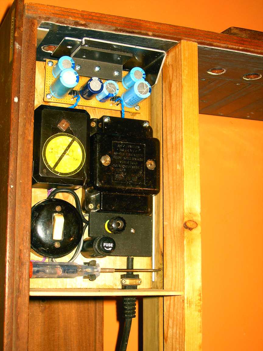

Posts: 5921

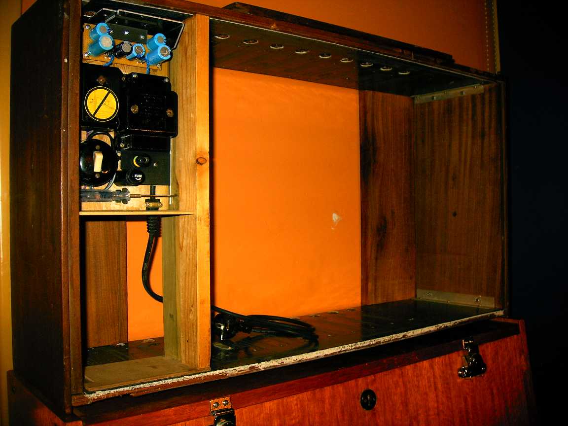

PostPosted: Sun Feb 02, 2014 2:01 pm    Post subject: Reply with quote  Mark this post and the followings unread

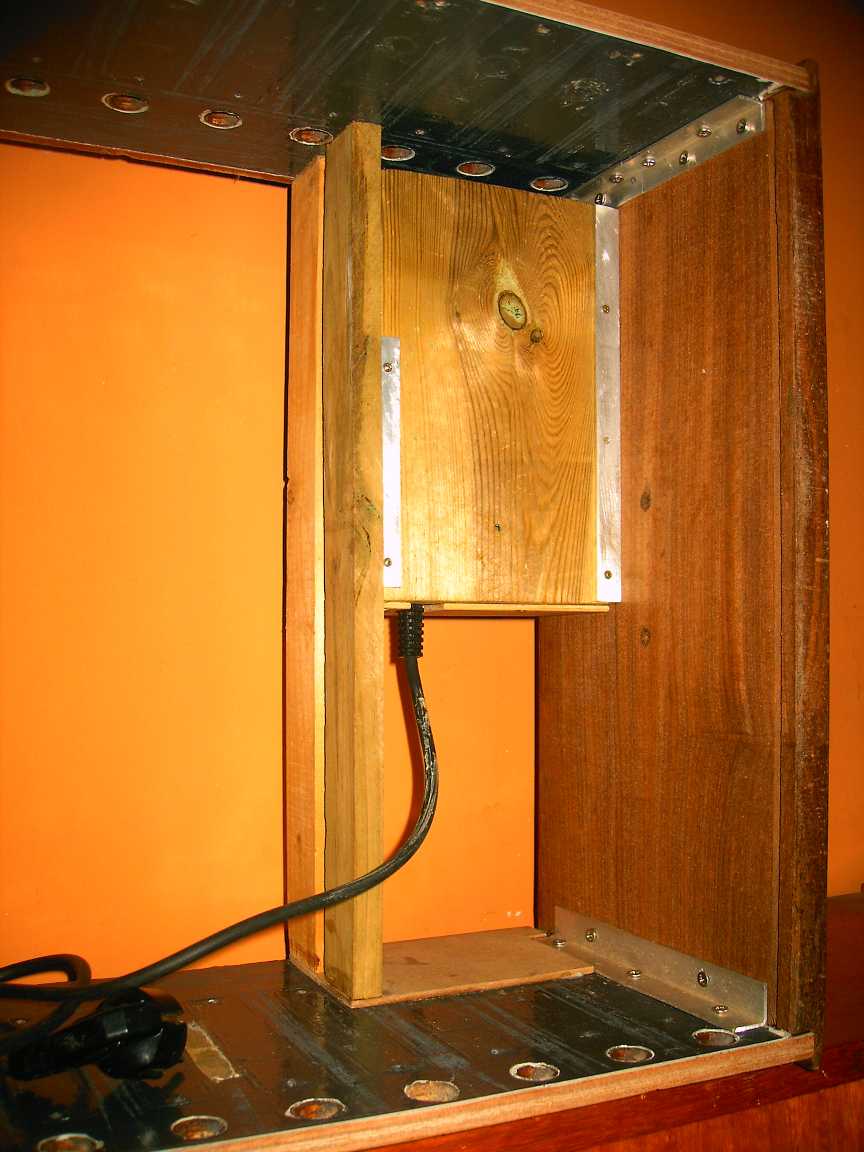

I installed the PSU today. I'll probably have to make more PSU's, maybe one just for LED's/lamps, and I have some nice space for that left. I have an
idea for a small spring reverb, and that might draw some current too, but I have a bunch of small transformers that could be useful to power something
like that. I also found a piece of metal mesh that fit's almost perfect as a cover. Maybe I'll make a small door with it or something.
At the moment I'm testing a sinewave generator, and I will try to use a vactrol to make it voltage controlled. I will make two and I have some large
transformers that might be useful for a ringmod. Cool

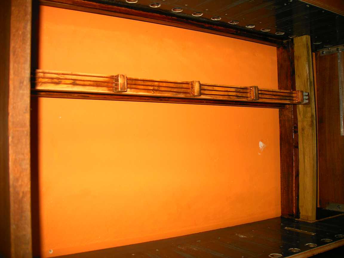

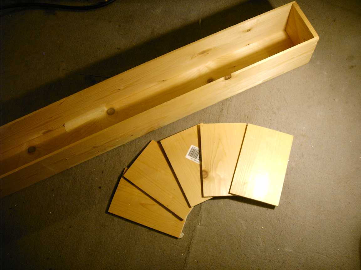

PostPosted: Thu Feb 06, 2014 4:55 pm    Post subject: Reply with quote  Mark this post and the followings unread
I cut some panels from a strip of wood which was the lid of a box for wine bottles. And it has 3 more sides that I can cut into panels Very Happy
I then installed some mounting rails which I treated with some very old darkbrown stain (I had the remove a very thick solid layer first), and rubbed
with some steelwool to make them less glossy. I also installed some busbars for the powersupply, inspired by this. Cool

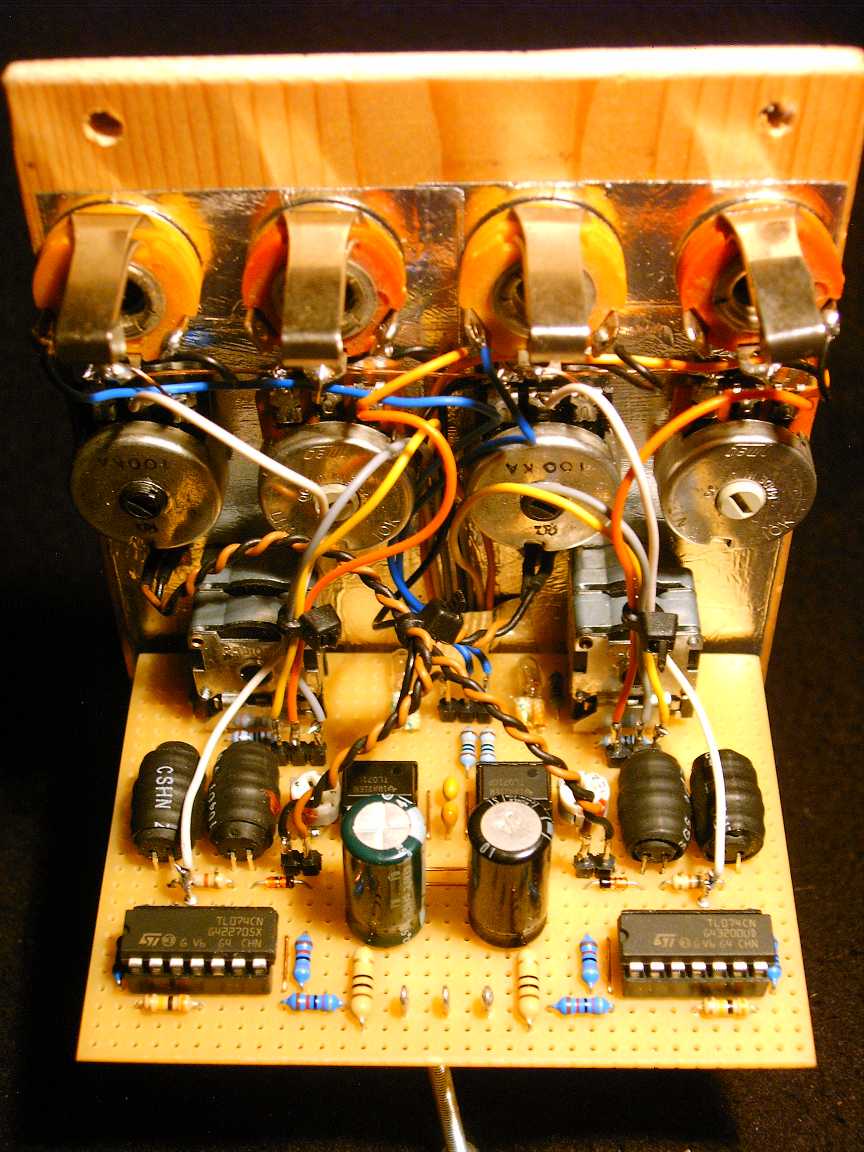

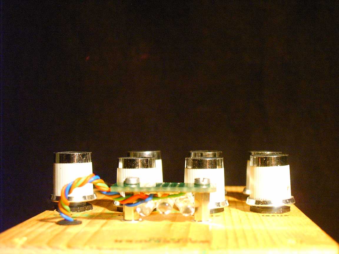

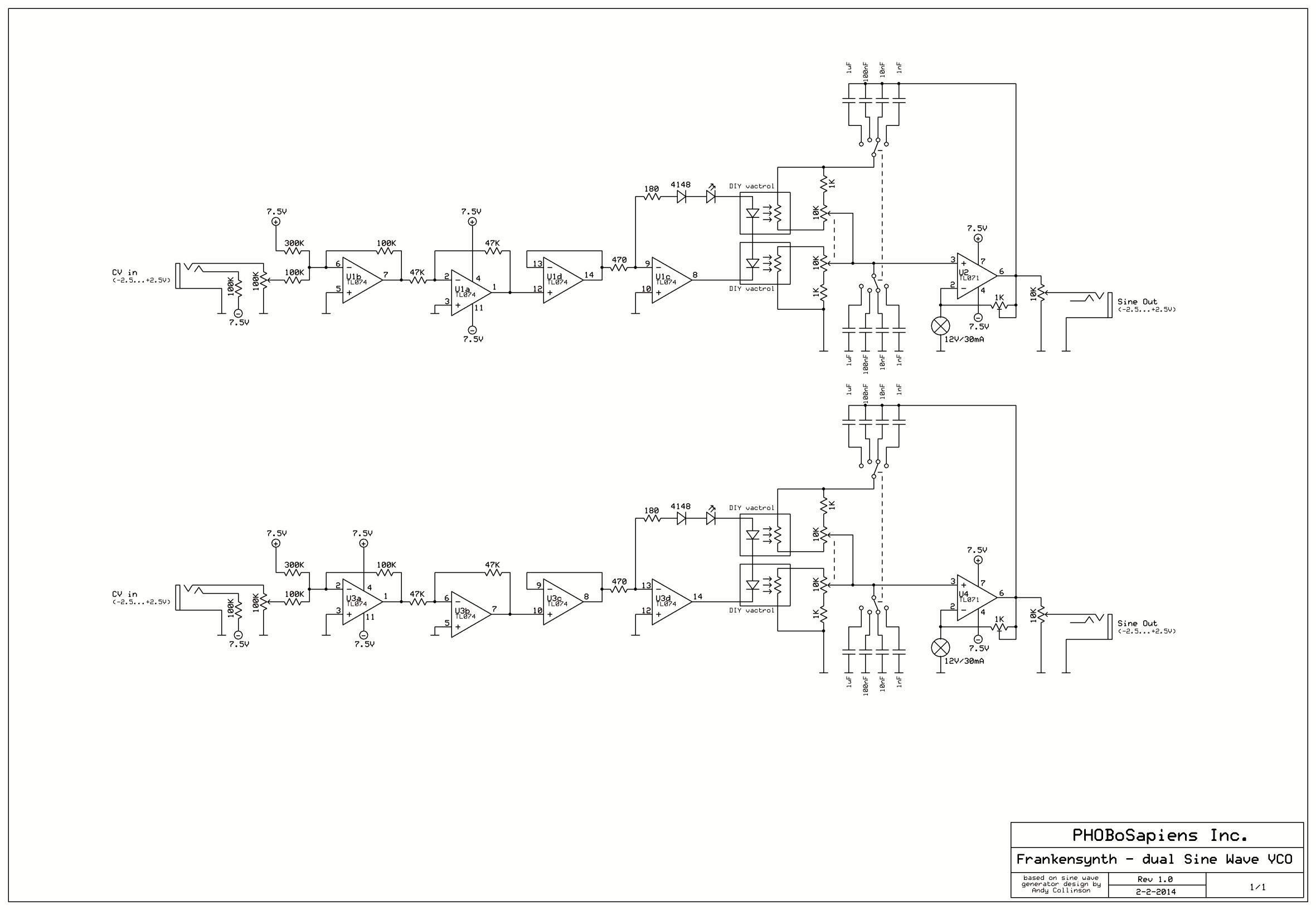

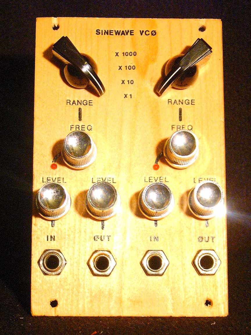

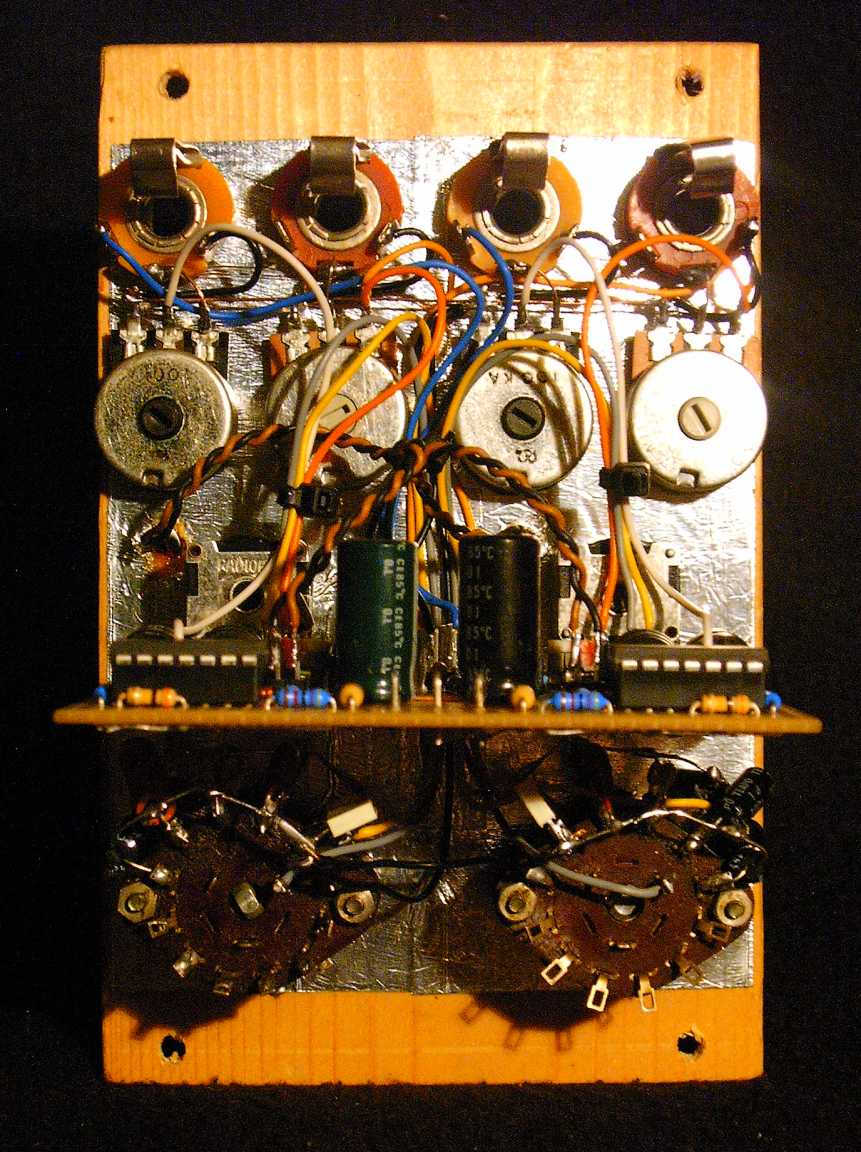

Posts: 5921
PostPosted: Thu Feb 06, 2014 5:51 pm    Post subject: Frankensynth dual Sine Wave VCO Reply with quote  Mark this post and the followings unread
The first module is finished; a dual sine wave VCO. Not an old circuit I had laying around, but I needed something to use with the waveshaper and I
had 2 10K stereopots, old rotary switches and useful lamps. I got the original design form here and I added some vactrols to make it voltage controlled.
I connected them to the other (unused) side of the pot so I didn't need an extra switch. The maximum output voltage I could get with the dual 7.5V supply
and the lamps I used is 5Vpp so that will probably be the range I use for the whole synth.
If you look at the schematic (from left to right) then the first opamp adds an offset of 2.5V and it also inverts. So with an input voltage of -2.5 to +2.5V
the ouput will vary between -5V and 0. The next opamp inverts it back to get a voltage range of 0 to +5V. Then it get's buffered and the last opamp (of
the TL074) is used as a current controller for the vactrols. I also added a diode and a resistor in the current loop for some extra protection, and
another LED that functions as an indicator. What I didn't think about is that with no input connected (0V) the LED's will be on (they turn off at -2.5V)
and as a result you can't get the full range manually. So I used the switch contacts on the jacks to provide a negative voltage. (for this to work
it needs to be unattenuated with no input signal)
The rotary switches are twelve position (without a stop) and I only needed 4. I did add an extra lower range using 2 10uF caps (not in the schematic),
so the total range is ± 1.5Hz to 150Khz in 5 steps, but they still have 7 unused postions. If you turn the frequency knob (or use CV) it doesn't
react instantly but wobbles a bit, which also causes some clipping. Exactly what I want for this synth. Laughing
The text on the panel is done using some old rub-on letters which worked surprisingly well. To protect them from rubbing back off I added some
spray lacquer. I don't have enough of them to do a lot of panels but I don't want those to look the same anyway.

PostPosted: Sun Feb 09, 2014 1:45 pm    Post subject: Reply with quote  Mark this post and the followings unread

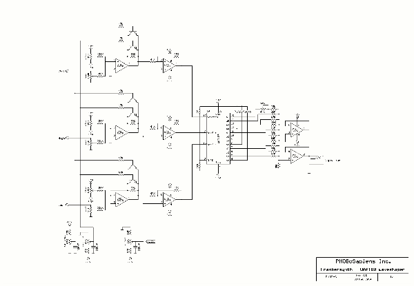

I finished the waveshaper. For the test I recorded I just hooked up what I had already breadboarded to the new PSU (I tested with a single 12V
before). I noticed that it didn't work as it should (although it sounded nice) but for some reason changing the upper level didn't have much
effect. So I checked the datasheet and saw that the max input level for all 3 inputs is 6V. Since I'm using a dual supply (+/- 7.5V) that corresponds
with -1.5V. The signal from the sinewave oscillators is -2.5V ... +2.5V so it makes sense that it didn't work.
Another thing is the input range:
Voltage difference for smooth light transition min. 1.0V
Voltage difference for abrupt light transition min. 4.0V
So I wanted a range of 4V. It could be 6V max. but that would set the lower voltage at -7.5V which is the same as the supply and beyond the
limit of the opamps. So with 4V the range is -5.5V ... -1.5V. I used 2 opamps, one to adjust the range from 5V to 4V and the other one to add
the offset voltage and get it to -5.5 ... -1.5V.
I also added offset control to the first opamp, but because of this it can go beyond the range that I wanted. I mentioned in the chatroom that I was
working on the waveshaper and needed to limit the voltage, which resulted in Fredvard posting the following simple circuit for a limiter.
I tried it and it works perfect. Laughing (thanks again Fred!) And it also makes it possible to set the levels of all the 3 inputs (Low, Ctrl, High) at once.
I also tried if I could use it to connect the Low and High levels to eachother, so that the Low Level can never go above the High level and
the other way around. But because of the voltage drop over the transistor this didn't work and the crosslinking caused some weird behaviour.
It actually worked better with a simple diode to short the ouputs of the opamps together. But controlling it turned out more confusing that way, so
in the end I just left it simple with level and offset control for all the 3 inputs. There's also an extra opamp on the output as a buffer. (I used a
TL072 because it was easier to design the PCB for then a TL071)

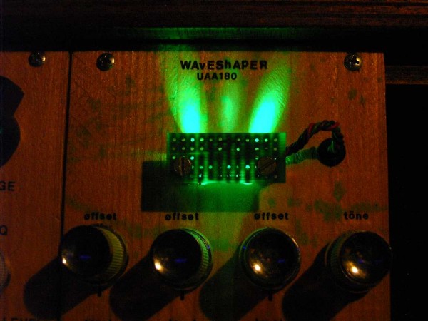

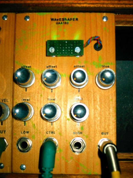

I used bright green LED's but since I don't want to be blinded by them I bend them 90 degrees and mounted them on a piece of perf. This way
they shine across the top of the panel,. but there is also some light going downwards. I used some splashes of neon green (UV reactive) paint to
spice the panel up a bit but that's not really visible in the photo,. So I'll try to take a better one with LED's and UV light on.
Frankensynth UAA180 Waveshaper V2 schematic
 Filesize:  83.03 KB
 Viewed:  1133 Time(s)
 Filesize:  93.45 KB
 Viewed:  809 Time(s)
 Filesize:  130.4 KB
 Viewed:  799 Time(s)
 Filesize:  79.84 KB
 Viewed:  731 Time(s)

some better photos of the neon green paint and the LED's Cool
alien jizz
 Filesize:  86.86 KB
 Viewed:  949 Time(s)
bright green LED action
 Filesize:  72.94 KB
 Viewed:  728 Time(s)

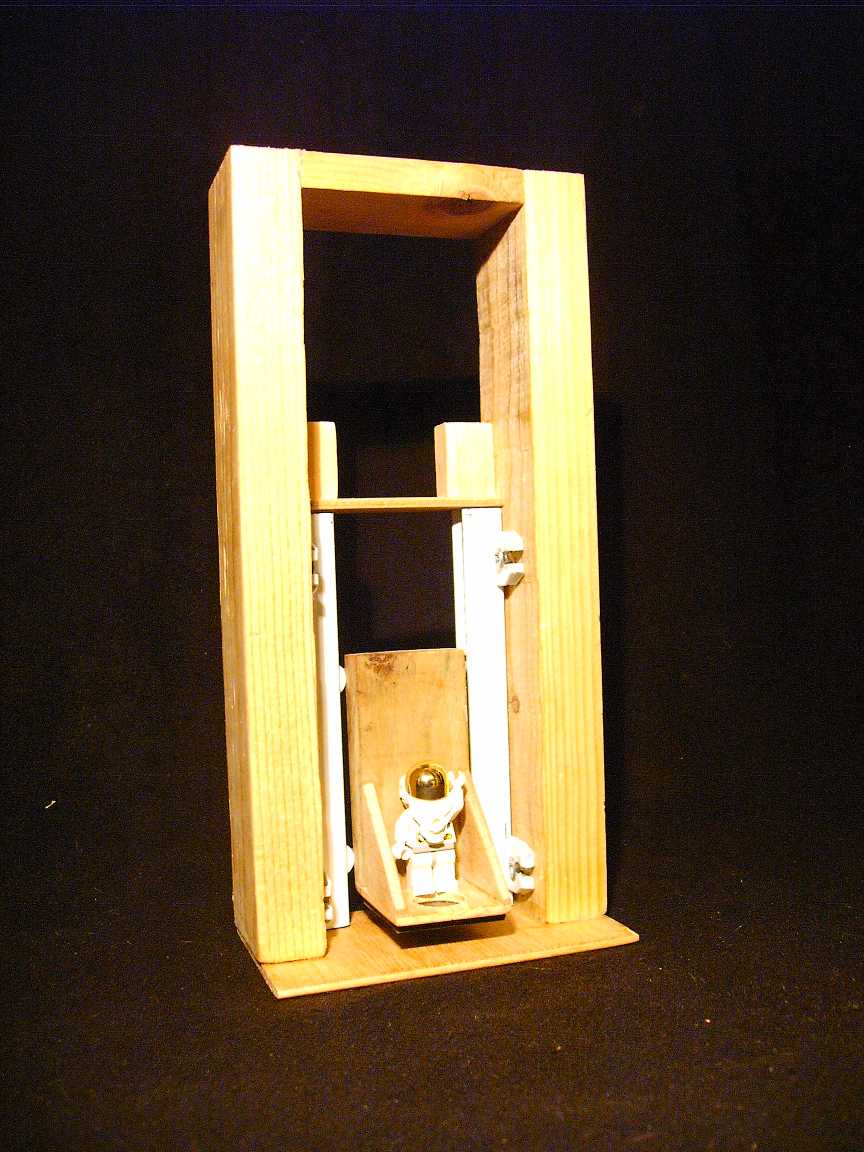

PostPosted: Mon Feb 10, 2014 9:03 am    Post subject:   Reply with quote  Mark this post and the followings unread
Question
 Filesize:  89.61 KB
 Viewed:  791 Time(s)

PostPosted: Mon Feb 10, 2014 10:18 am    Post subject: Reply with quote  Mark this post and the followings unread
Ah, a space elevator module. Never leave the planet without it.
I love the way this is turning out! Very Happy
Posts: 5921
PostPosted: Mon Feb 10, 2014 1:56 pm    Post subject: Reply with quote  Mark this post and the followings unread
Thanks bob, I'm having fun building it. Very Happy
