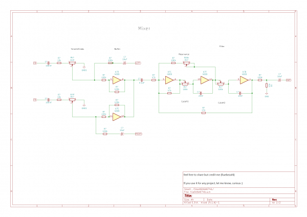

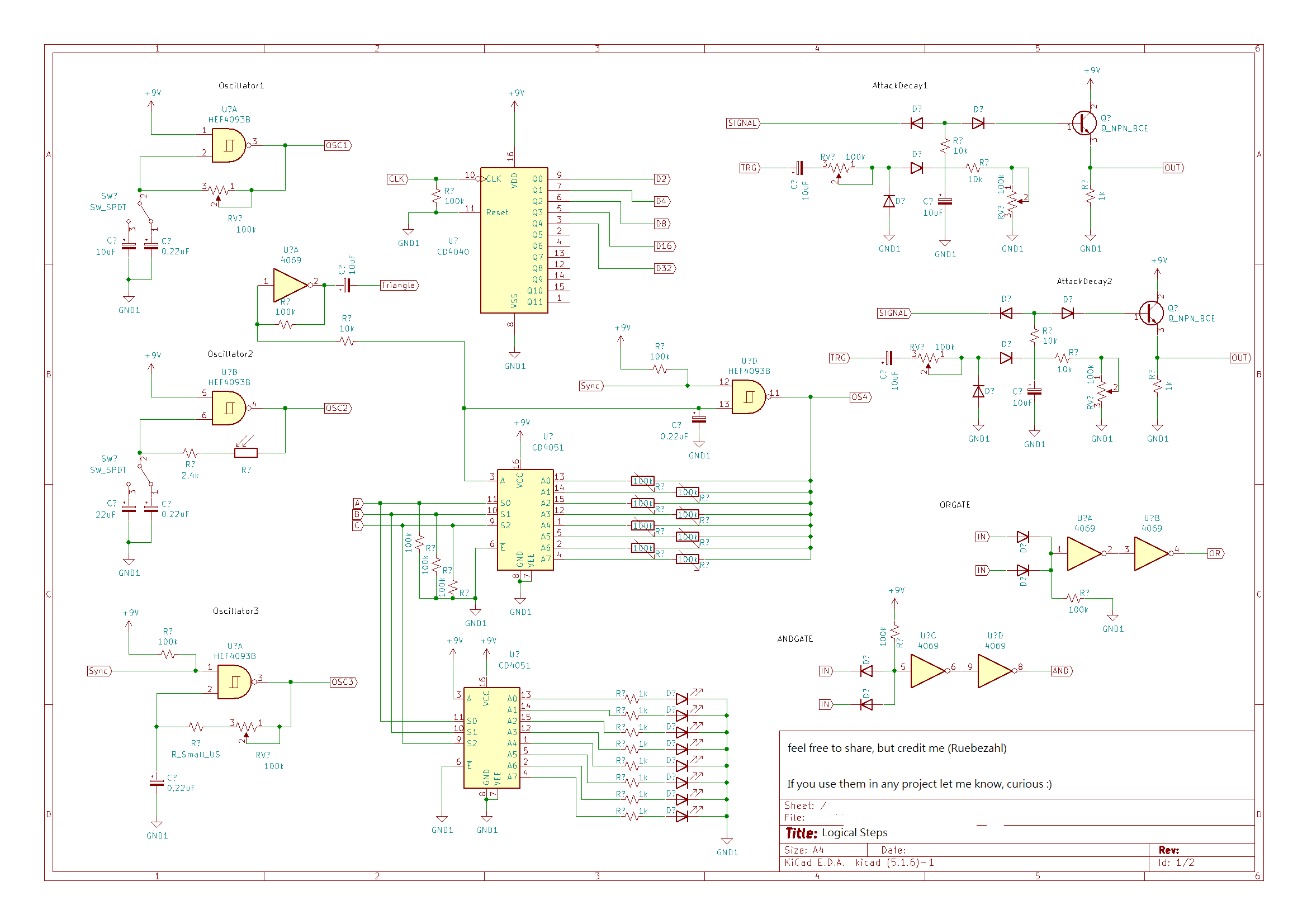

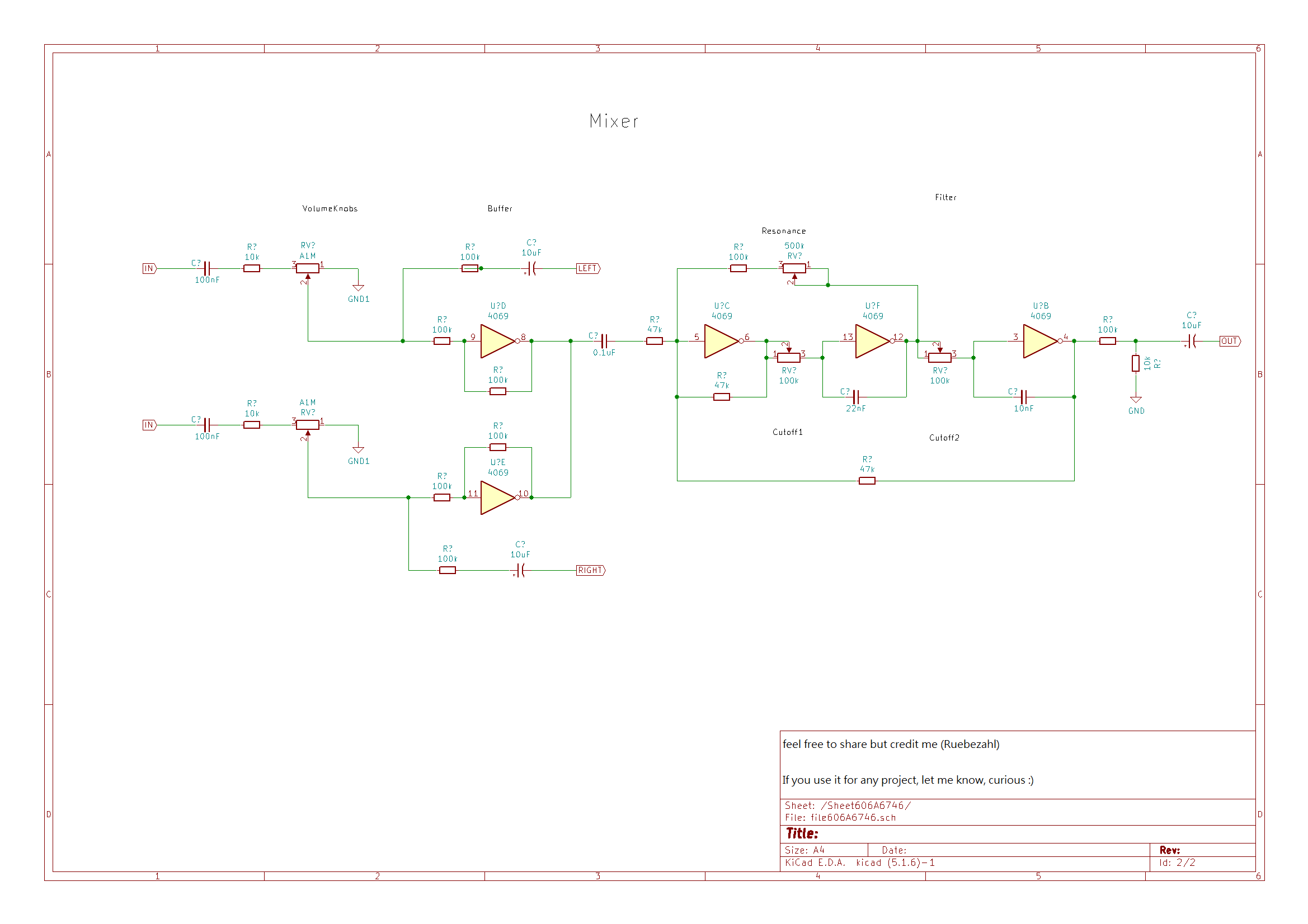

Here are the schematics, without any guarantee. I mean i built it and it works, but it's very possible there are some errors in the schematic, and i actually built it a bit different Very Happy If you are a beginner and want to attempt something like this, i recommend just reading the original article on hackaday, and perhaps go through the whole series, it is really worthwile!
 Filesize:  129.84 KB
 Viewed:  734 Time(s)
 Filesize:  61.39 KB
 Viewed:  584 Time(s)

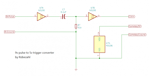

PostPosted: Fri Jun 25, 2021 8:34 am    Post subject: Reply with quote  Mark this post and the followings unread
Ah, i also came up with a circuit to sync this sequencer with LSDJ. LSDJ needs short 5V pulses (15ms), as opposed to the 9V pulsewaves the CMOS chips put out. So i had to see how to lover the pulse to 5V and also if i need to make it shorter. I tried a lot with Voltage Divider, which didn't work at all. As soon as i turned on the gameboy, a clean pulse (between 0V and 3V, 5V, 4.5V or whatever) turned into a pulse that never really goes back to 0, oscillating between for example 0,3V and 3V or 0,6V and 5V, which didn’t really work anymore to trigger the clock of the gameboy. Seems like some resistance at the gameboy input seems to influence the voltage divider.
So i decided, since i still had to test if i can trigger the gameboy with pulsewaves instead of short triggers, to try something i can do with parts i have lying around. I created a clock from a 40106 schmitt trigger, but this time running the chip from the gameboy power supply's 5V. So i have a clean 5V pulsewave, that didn’t get compromised by the gameboys input. But it still didn’t properly keep the gameboy in sync, so i searched for a way to transform this pulse in a trigger of a certain length. I found a really simple solution by Ray Wilson (MFOS), which only consists of a resistor, capacitor and a schmitt trigger. So with the same chip i could build this gate to trigger converter. And after playing around with some values, i settled for a 0,1uF cap and a resistor of 50k (it worked down until 23k, but let’s play it safe). If the resistor is bigger it still worked (i checked until 500k), but the short pulse actually becomes a short oscillation (probably due to the simplicity of the design), so i sticked with 50k. I checked the length of the pulse and it is only around 5ms, much less than the 15ms of the volca series. So it seems LSDJ is not THAT picky after all Smile
So this problem is solved, and it’s good to know the gameboy can actually power a chip through the link cable. But of course i won’t power my whole machine through the gameboy in the end, also because it runs on 9V. So i thought a feasible solution would be run a 40106 from the gameboy’s 5V, and feeding it a 9V pulse from my sequencer. Since the power supply of the chip is 5V it should give out a pulse of 5V instead, which i’d turn into a 5V trigger with the next inverter. It’s not the most economic version, and takes quite some space, and i still have 4 schmitt triggers left, but i could pull it off with parts i have lying around. And, yippieh, it works! (at least on the breadboard with a mockup sequencer clock, i yet have to connect it to my actual sequencer!)
Perhaps i could try a similar version with a transistor later. I could also imagine using the remaining inverters to do the opposite version, so i can have an clk in and clk out with one chip, but for that i would have to use a 4069 and power it from the 9v instead i guess...
 Filesize:  9.85 KB
 Viewed:  239 Time(s)
