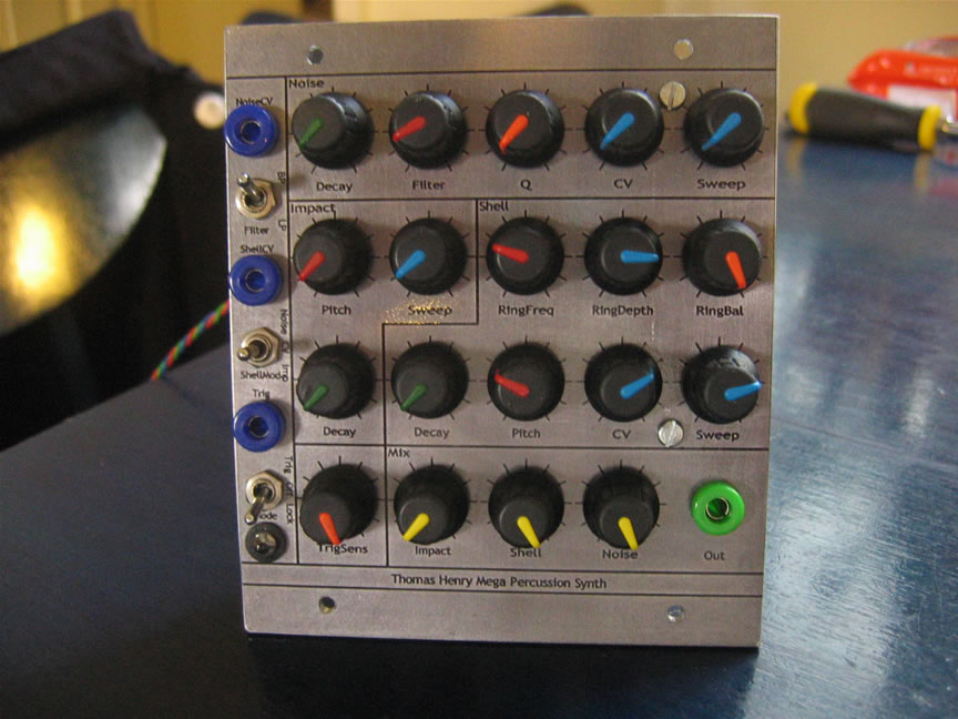

I don't know what the situations are... But just to maybe make Andy's comment clearer -- we'll be testing for the next 2-3 weeks and then the PCBs have gotta be ordered and then got to Mosc for the EM store.
Oh, here's a couple of pics too:::
-- getting on with building the prototypes - should get to sounds before too long. Once I'm a bit further down the line I'll put up the .fpd file and other docs I've gotten together on it.. I'm still amazed that all this can be fit into 3 Frac width!
Panels -- raw aluminium, cut to size and then covered with laser-tran-decals
 Filesize:  86.72 KB
 Viewed:  702 Time(s)
Hardware mounted, but not wired up yet....
 Filesize:  83.95 KB
 Viewed:  641 Time(s)

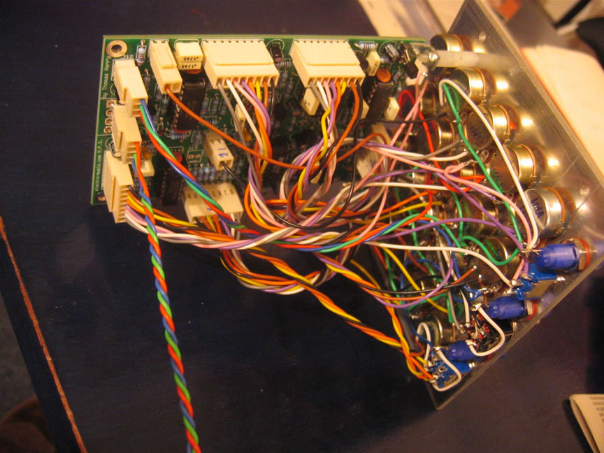

I've got one of the prototypes up and running - still got to do some more investigations, but thought I'd post up some pics & details.
It is GREAT fun to play with - the scope of sounds is really fantastic! The Shell section, in particular, is very powerful - with the RingMod plus Cross-Mod from the Impact you can get some freaking amazing sounds out! I measured the freq range of the Shell section -- 27Hz to almost 19kHZ (which I can actually still hear - just!).
Still some more checking to do - and need to do some more playing! Shall do my best to record some demo sounds too....
But, right now, here's the FrontDesigner panel file and a document to help with the (pretty involved) wiring -- gotta say that it was a squeeze to fit everything into 3-frac-width, but you know I like things compact.
A couple of notes --
Switches -- the Cross-Mod is optional (but recommended) - I used one of those OnOnOn switches because I'm a banana-man but people with switching jacks could do some Normalisation here.
For the Trigger Mode I used a DPDT C/O switch to allow for the Trig to be switched off -- but, once I did the initial tests I realised I'd made a booboo and the Centre/Off position left the input comparator floating -- oooops - still gotta check this with TH, but my solution was the simple addition of a 10M pull-up resistor.
Hmmm, all this will become clearer / more use once the pcbs become available!
 Filesize:  97.38 KB
 Viewed:  635 Time(s)
Quite a lot of wiring!!!!

Wiring diagram for the Bugpanel

Lots of knobs 'cos of lots of functions! There's so much versatility pack in by TH!
