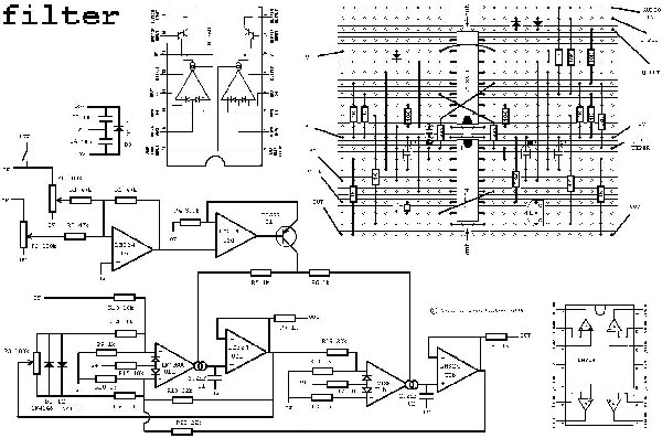

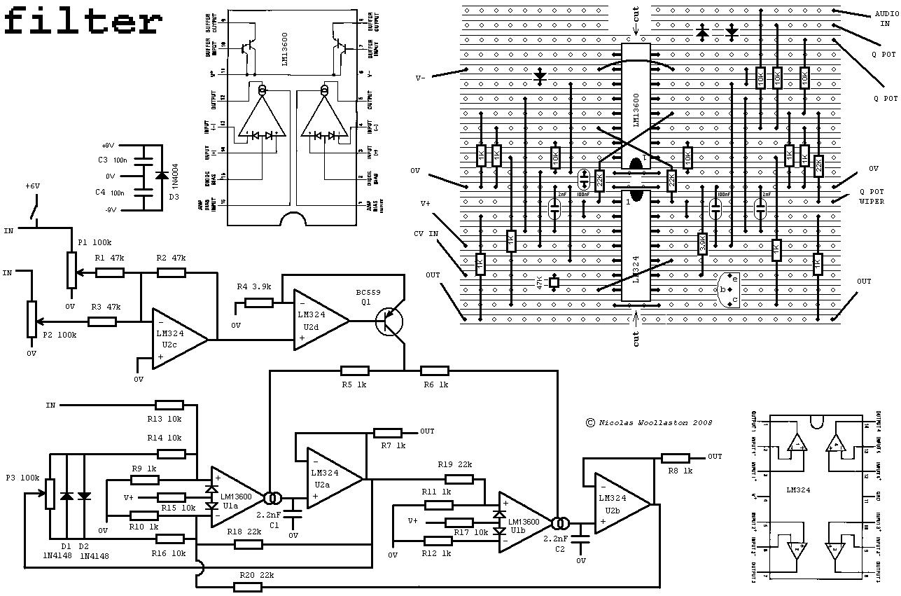

Here is a filter to match the VCO http://electro-music.com/forum/topic-32689.html and ribbon controller http://electro-music.com/forum/topic-32651.html
This circuit is pretty much the standard state variable design from the LM13600 datasheet, but with a Q pot and diode clippers added that allows it to oscillate reliably so that it can be used a sine VCO as well as a filter. It has bandpass and lowpass outs.
A fairly basic circuit that sounds okay and is simple enough to understand and be built in a couple of hours on stripboard. It runs off +/-9V (ie two batteries). It expects a CV in the 0-6V range. The output is about a volt or so which won't blow anything up if you run it directly into effects pedals, etc.
It is V/Hz which means that if you set it up to give you C at 1V, you should get C an octave higher at about 2V and an octave higher again at about 4V.
I built mine last year, but have only finished tidying up the drawing, so if you notice anything amiss, please let me know.

Thank You for sharing this Nicolas, these circuits are really nice work.
I haven't got round to building any of them yet, but this filter was the last straw, im gathering parts now...
i'm not shure i understand the +6v switch on the input tho. Is it just to boost the signal so the resonance behaves well?
Does it tolerate +/- 12 volts, or do i need to raise some resistors?
(Of course i'll try it, but a firsthand answer really won't hurt my ego.)
is there more of these? Smile
thank you a gain
róbert

That switch to +6V is my crude way of showing a switched socket that sees +6V when nothing is attached. It doesn't really need to be +6V, any stable +ve voltage would be fine.
To run it on higher voltage up to +/-15V should be fine, but increase the value of R4, R15 and R17 proportionally (say 6k, 14k and 14k or similar).
Nicolas

Built the filter today. But ran in to some problems.
The q pot does not work properly Sad
It just work a little bit of the pots axel. I use a 100k pot just like in the schematics but should it be 10k?
What could else be wrong?
nicolas3141
Joined: May 25, 2007
Posts: 185
Location: Christchurch, New Zealand
PostPosted: Thu Jun 11, 2009 2:14 pm    Post subject: Reply with quote  Mark this post and the followings unread
I am not quite sure what you mean. When I turn the Q pot to 100% my filter rings (oscillates if there is no input). If I back it off a bit to around 70-90% the filter has that resonant wah type sound. Then as I turn it down further it loses the resonance and becomes more like a tone control type filter. Between 0-70% the changes in the sound of the filter are not very dramatic.
Perhaps a log pot would be better here so that we could get better control over the high resonance end and waste less rotation on the low resonance end.
This general type of filter is quite common, but what distinguishes one from the next is the feedback arrangement to provide Q control. So I encourage you to experiment with different pots and types of feedback. Let us know what you find that works.
Nicolas

PostPosted: Sun Jun 14, 2009 1:57 pm    Post subject: Reply with quote  Mark this post and the followings unread
It works now. I have the same result when I turn the Q pot now. I think that was what puzzled me was that there was not much action until you get to 70% turned Q pot. After 90 it goes crazy... Smile
I will try later on with a log pot....
So that is number 4 of your designs Very Happy

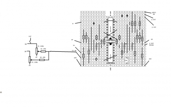

Does anyone have the wiring layout? Stripboard layout has only one potentiometer (Q pot) which is P3, in schematic, they're 3 total pots right? I am missing something?
Once again, thank you nic for you layouts. I'm slowly building my rig. Ordering a MFOS psu soon Smile
gabbagabi
Joined: Nov 29, 2008
Posts: 652
Location: Berlin by n8
PostPosted: Wed May 02, 2018 10:50 am    Post subject: Reply with quote  Mark this post and the followings unread
dude, u should know it better by now Wink

To apply that +V, can i just hookup the +V from the power supply to give it a stable voltage? Where's the easiest place to find that +V to that switch socket. Thats the only confusing part for me.
gabbagabi
Posts: 652
PostPosted: Wed May 02, 2018 9:57 pm    Post subject: Reply with quote  Mark this post and the followings unread
we need to know on what voltage u run
and
the resistor-value of the pots u use
Project_2501
Joined: Jan 31, 2018
Posts: 68
Location: Los Angeles
PostPosted: Wed May 02, 2018 10:08 pm    Post subject: Reply with quote  Mark this post and the followings unread
I'm going to be using a +V/-V 12 wall power supply by mfos. For pots, I guess 100k lin, but I have 10k, 25k, 50k lin available.
