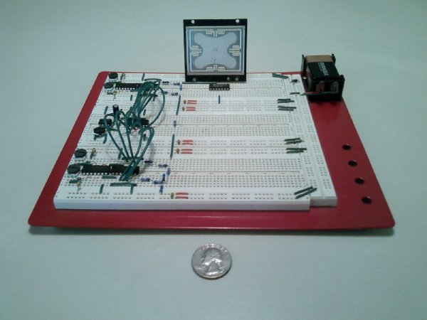

Here is an updated photo with Beginner's Lunetta projects one and two completed. Note that there is more stuff on the right side of Project #2 (the larger breadboard).
Les

PostPosted: Wed Mar 03, 2010 3:01 pm    Post subject: Summary and remarks on "4-oscillator-lunetta" show Reply with quote  Mark this post and the followings unread
Bill "State_Machine" came into the chat during the show 5 minutes before the ending.
Well, I missed it completely, tuning into Bill's soldering musicians radio stream half way.
Summary of information, unfinished.
On Inventor's breadboard (from Digikey.com)
1M thumbwheel pots, a value often used in Lunetta's , especially with 40106 oscillators, costing $1.25 , something like that.
Inventor's Breadboard Speaker
The flat speaker: ("pricy but good quality") is from digikey.com, where Les buys most of his parts.
It's a piezo speaker with Frequency Range 150Hz ~ 100kHz. It's high impedance, meaning it can be driven directly from an opamp, or even directly from the CMOS
outputs.
After soldering two little pieces of 24G wire it's great for breadboarding says Les, and during the show it was miked and the sound directly sent to the stream.
I noticed no difference to my 4-osc-lunetta heard directly through headphones.
Digikey Part number P11124-ND

Next the show discusses reading the 4-osc-lunetta schematic:
The four triangles with the little circle on the right side are the invertors.
Each invertor (oscillator) has a capacitor to ground at the input, and a potentiometer between it's output and input ( the "feedback loop").
There's a fixed resistor in the feedback path in series with the pot. Pitch rises with lower resistance. And higher resistance lowers pitch .
The 4.7K resistor thus limits the upper range, preventing the pitch to reach inaudible frequencies. (adjust to taste)
These extremely simple oscillators are used quite a lot in Lunetta's.
Next: the Voltage Followers.
An opamp with the signal to it's positive input and it's output connected to the negative input is voltage follower. Two of those are at the upper right of the
schematic.
The voltage followers are buffers used to reliably drive all kind of external amps , line in's etc, protecting your lunetta circuit and your external equipment from
harm or signal degradation.

I didn't have any 1M potentiometers though (only 5M but that didn't really work well) so I used LDR's. /.../ Next thing I did was making a second R2R ladder and connected the right. channel (or the left,..ehm,. the one that was directly connected to the oscillator) to it. Then I connected the LSB to the MSB of the first R/2R ladder and the MSB to the LSB of the first R/2R. I used the 2 spare inverters to make 2 more oscillators to drive the remaing inputs of the second R/2R. great stereo sound!
Cool. I built the QOL on a piece of perfboard. Lack of 1M pots had me use 250K, with 0.47 uF caps. Works fine for audio range.
I've been poking at the circuit with other components, and one of my LEDs between pin 7 and 2 of the opamp was following the levels of the HR2R DAC very nicely. Makes a nice randomish LFO. LFO speed is not always predictable, but a multitude of waveforms are available.
Next time, for LFO function I'd like to use some bigger capacitors.
I was thinking to drive the spare invertor sections with this LED, but unfortunately I have misplaced my LDR's.
Also the spare opamp sections want LDR's for sequenced filtering. Mine do.
Anyway, with this simple two IC Lunetta a lot can be done.
The opamps are an addition I'll definitely be using more.
And I want more DACs as well. Very inspiring fun little schematic.

Oh, about the LED, maybe I should mention, I had 1k resistors in the feedbackpath of the opamp.
That's why I said my LED is between pin 7 and 2 specifically. With + side to pin 7.
Response varied with different LEDs, your milage may vary, as they say, but worth giving it a try.
