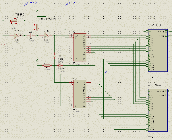

And now for something completely different. I want to make an electro-acoustic drum machine wherein a sequencer drives a number of actuators that can be attached to objects to make percussive noises.
Attached is the high level schematic I have in mind. The 8 switches of the DIP switch represent the 8 steps of the sequence, the one-shot turns the falling edge into a sharp pulse, and each actuator would be attached to a different drum, e.g. actuator 1 = kick, actuator 2 = snare.
So far I have 2 issues I'm stuck on:
1) Assuming a 4017 is a good base for the sequencer, What can I use for a 1-shot? I tried using the one in the top right of this image, which works when it gets the signal directly from the 4017, but stops triggering if you include a diode on the 4017 output. The diodes are there because I don't want to connect any of the 4017 outputs directly together, right?
2) Any suggestions for actuators? I'd like to use a speaker cone with some sort of mallet attached - I wonder if anyone's had any experience with this? My experiments resulted in several melted components so any direction would be appreciated. The closest I've gotten to success is using a darlington to drive the speaker with a good sharp whump, but I can't seem to get full extension of the cone. (Touching a 9v battery across the speaker terminals is the effect I'm going for.)
Edit: Here's the effect I'm going for: http://www.youtube.com/watch?v=MRvmrP8xIDk

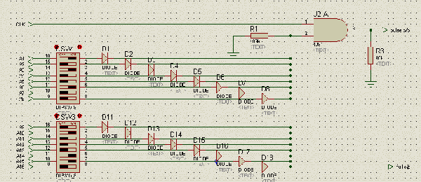

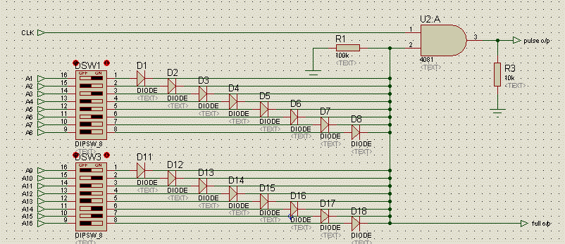

I found the answer to my own question, in case anyone's interested: you can AND the 4017 outputs with the clock signal to get pulses, instead of using a 1-shot. Got my info from casper electronics and ken stone.
Note these are untested circuits but they work in simulation, hopefully I'll get it built over the weekend.

That looks great, I made a very similar circuit for one of my projects and the addition of the AND gate really makes a lot of difference. Another cool thing to try is using different signals with the AND gate. I see you still have 4 gates left on your 40106, you can easily make a different clock and offset it to the first, causing all kinds of note lengths.
And Im not really sure why you used a pulse width oscillator, the only place where it has any affect at all is with the AND gate, the 4017's should work fine on just a normal squarewave.
This might be a step too far but look around the forum for the 4029/4051 sequencer, that one can also switch to reverse and you can create weird patterns with the JAM inputs.

What is the use of the 4081 in your circuit?
rich decibels
Joined: Apr 01, 2010
Posts: 60
Location: Wellington, NZ
PostPosted: Sun Feb 27, 2011 1:06 pm    Post subject: Reply with quote  Mark this post and the followings unread
The output of the 4017 is ANDed with the clock signal to give a half length pulse. Without the 4081:
Code:
1: --______
2: __--____
3: ____--__
4: ______--
With the 4081:
Code:
1: -_______
2: __-_____
3: ____-___
4: ______-_
This way when I set consecutive beats to be 'on' I get distinct on pulses for each beat, instead of a continuous high.

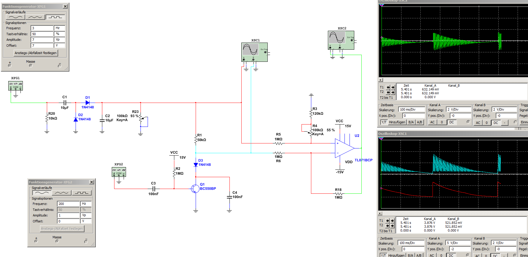

Oh, crap. One thing I noticed... The position of C1 is different from what I am actually using. This was a mistake I noticed a while back but forgot to update here.
Here is the updated schem:
The main difference in sound between this and the other is that in this one, you can get more of the weird "crackle" with higher cap values in the C1 position. Worth at least checking it out if it's on the breadboard.

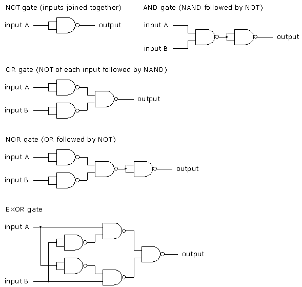

Yeah it's an excellent way to get more variation out of your baby10 sequencer. You can also try to gate it with other signals, I tried it with the output of the VCO in one of my builds and that was very nice. I believe casperelectronics first came up with the idea in his baby9 sequencer.
Did you know you can make all of the gate types from just the 4011 and some jumpers?
I used a 4011 for mine and that give me 2 extra gates, one of wich I used as a cheap and dirty filter. I just used a 1m pot and a 0.47uF cap between one input and the output of a NAND gate, just like you would with a NAND oscillator and just feed your signal into the other input. Simple but very powerfull, I used it in this video, it comes in around 0:52.

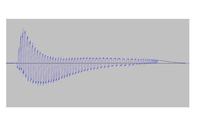

OK, believe it or not, I still have it on the breadboard! I made the change. The only difference I thought I noticed was a slight gain in output, but I'm guessing that is due to the crappy little amp I used on my workbench. It sounds a hundred times better on my studio system.
Just for grins, I mixed 6 40106-based oscillators tuned at various freqs into the junction between the third transistor collector and the 1N4001 immediately above it and it gives a more metallic feeling to the sound. The oscs have 100K ohm output resistors which are connected together.
I thought about a pot to vary the mix but decided a simple "metal" switch may be more appropriate for a lunetta.
Also while testing this, I accidently leaned on my keyboard and was blown away by the volume of a synth sound. The output level of this noise voice is quite a bit lower than my synths. I'm tempted to add an output amplifier. I suppose if I add both the 40106 oscillators and an output amp I'm getting out of the realm of lunetta. I suppose I'd better not bring up the subject of a filter either! Embarassed

Old thread I know.. possibly everybody has moved on. But I just build Eric Archers Mini Space Rockers (they are awesome btw) with 3 rotary switches to choose between caps. Everything works fine. Only thing I've noticed is that, when triggered with a slow gate, there is a little lift at the end of each beat. Now I'm wondering if I messed up somewhere and if there is anything I can do to change it, or filter it out somehow..
 Filesize:  14.54 KB
 Viewed:  1153 Time(s)
msr.mp3
 Filename:  msr.mp3
 Filesize:  452.99 KB
 Downloaded:  1289 Time(s)
Posts: 5881
PostPosted: Sun Jan 20, 2019 7:56 am    Post subject: Reply with quote  Mark this post and the followings unread
ah the mini space rockers, I actually started on a drum machine once with 8 of those all with different component values, someday I'll finish it Embarassed
I honestly don't remember if it is supposed to sound like that, could very well be so I am not much of help there. But the waviness you see in the
signal is most likely the result of an AC coupling cap. It's always bit of a compromise, a small cap will filter out the low frequencies, a large cap has
a slow responce.
edit: had a look at the schematic and I think it's normal. The sound is generated by an AMV and the frequency depends on the supply which
is how it is triggerd. So it will be higher as the voltage decreases.
