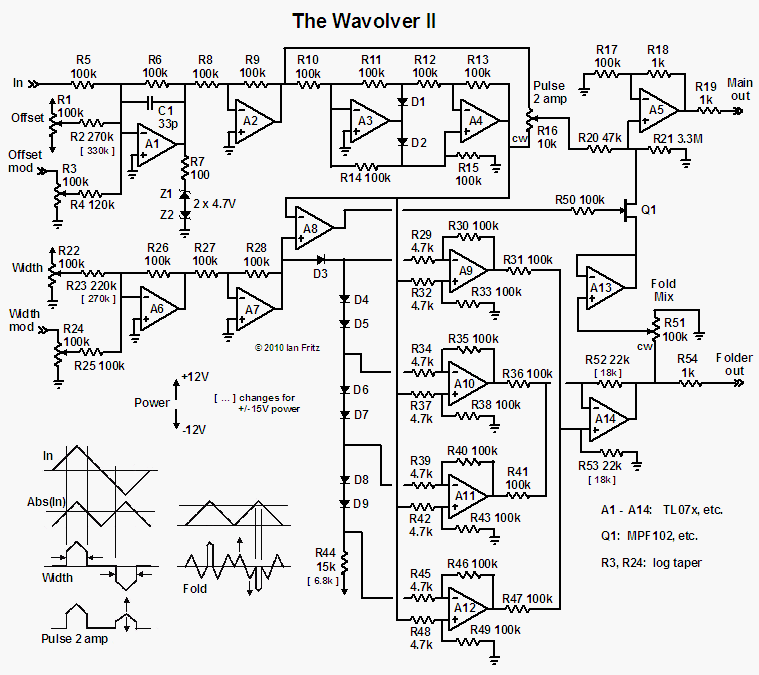

PostPosted: Thu Feb 24, 2011 7:19 pm    Post subject: Re: Wavolver II Reply with quote  Mark this post and the followings unread
drapdap wrote:
Schematics only with a board right? No peeking?
Actually, I don't mind having this one public (close enough to the old version.)
Edit: schematic updated 4/28/11
Ian

PostPosted: Thu Feb 24, 2011 8:58 pm    Post subject: Reply with quote  Mark this post and the followings unread
Any considerations for us +/- 15v heretics? Or should it operate happily as is?

PostPosted: Thu Feb 24, 2011 9:50 pm    Post subject: Reply with quote  Mark this post and the followings unread
Edit: Please see updated schematic, which includes changes for 15V power.
Ian

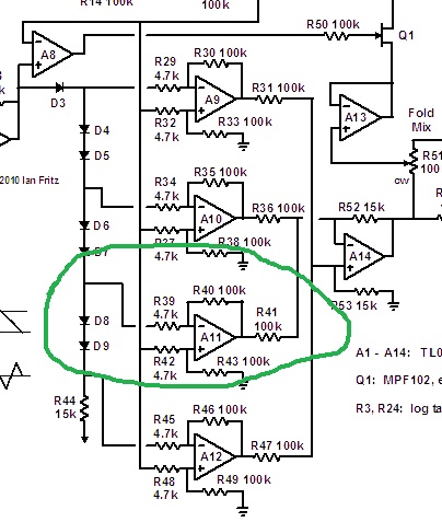

PostPosted: Sat Apr 23, 2011 5:16 pm    Post subject: Reply with quote  Mark this post and the followings unread
Howdy there Ian,
Presuming space and extra parts/cost/complexity is mostly no object, any estimates on how soon I'd get diminishing returns by adding more stages (as seen circled in green)?
Maybe rephrase that as "When would it stop having an audible effect?"
And I suppose the answer is to build it and see/hear, but I figured it couldn't hurt to ask first anyway Smile
Also, would matching the diodes (say either the pairs in series, or all of them) have any benefit?

PostPosted: Sat Apr 23, 2011 8:22 pm    Post subject: Reply with quote  Mark this post and the followings unread
Thanks for your interest! There are lots of experiments you could do with the folder section. As it's designed, it spans 7 diode drops, or ~5V, so it matches up with the CV range. It's also reasonably symmetric with respect to the range. Since it makes triangular sections its sound comes in quite smoothly. So if you add more stages, you'll want to think about those aspects. I did some initial experiments with six stages and single diode drops between the stages. You certainly get more harmonic content that way!
Another way to experiment is to change the gain of the differential amps (R39 R42, etc.) Higher gain will give trapezoidal folder waves. Since the circuit was developed with Tri drive in mind, the smoother sounds are better to my ear. Of course, you can drive with any waveform you like, so that's another way to vary the module's sound.
Not really. It's just a waveshaper, so precision doesn't buy you much.
Ian
de_engineered
Joined: Jul 16, 2009
Posts: 18
Location: USA
PostPosted: Sun Apr 24, 2011 10:52 am    Post subject: Reply with quote  Mark this post and the followings unread
Welcome sir, and thanks for responding!
Hmm. If the voltage drops are the limiting factor, maybe some Germanium diodes might yield interesting results, or at least allow for more stages. A stage select switch to dial down (or up Very Happy) the hairyness might be called for too then.
I'll be sure to give the other hints a try too. More when I hit the breadboard...!

PostPosted: Wed Apr 27, 2011 8:18 pm    Post subject: Reply with quote  Mark this post and the followings unread
Edit: Please see updated schematic above.
Ian

PostPosted: Fri Apr 29, 2011 4:01 pm    Post subject: Reply with quote  Mark this post and the followings unread
Bump. To be sure everyone notes the revised schematic.
