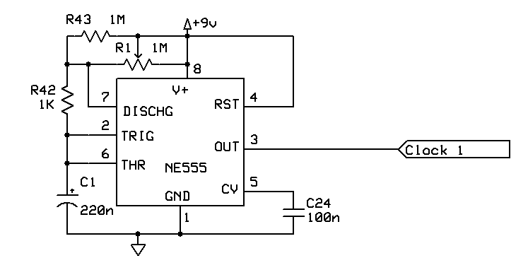

PostPosted: Mon Nov 05, 2012 3:23 am    Post subject: Reply with quote  Mark this post and the followings unread
Okay,
I've updated the design with a couple of these ideas.
The 1M trim with the 1M fixed gives the functionality of a 500K log pot.
1K discharge resistor widens the pulse a bit. The cap will need to be changed for the final range (once we work it out). The 1K can come up if need be to scale the trimmer.
100n from pin5 to ground. Pin4 to +ve.
I'm looking at an upper limit of about 8khz and a lowest frequency of .5hz
What do you think?

PostPosted: Mon Nov 05, 2012 8:17 am    Post subject: Reply with quote  Mark this post and the followings unread
Just to let you know, I am thinking about this still, but I'm coming to the conclusion that this range of frequencies is very hard to acheive using one capacitor. In theory, I can put values in which seem to give the entire frequency range, but they don't work well (or at all) in practice. One problem is that the duty cycle tends towards 100% at one end of the pot (i.e. the output goes high all of the time). Steering diodes could be used, but then you'd need a dual-gang pot to keep the duty cycle constant. The other problem is that of fine frequency control. If the pot value is much larger than the resistor between pins 6 and 7, the frequency increases slowly as you turn the pot, but then rises very quickly towards the end, so is very hard to set accurately (almost impossible, in fact). If the pot value is closer to the resistor value, you get much better control, but a much narrrower frequency range (a bit of a Catch 22). One way around this problem could be adding a second smaller 'fine tuning' pot in series with the 'coarse' one.
So, at the moment, I can only see a solution by adding capacitor switching and possibly a second pot as well for fine tuning.
As an aside, I think that your original idea for the circuit does work (to some extent) because there is some inherent resistance inside the 555 chip, so the equations do make sense. If you put in even the smallest resistance between pin 6 and 7, the equation doesn't have a divide by zero situation and so gives a meaningful result.
Sorry I haven't got an instant answer - let me know if you want to proceed with the way I'm thinking at the moment.

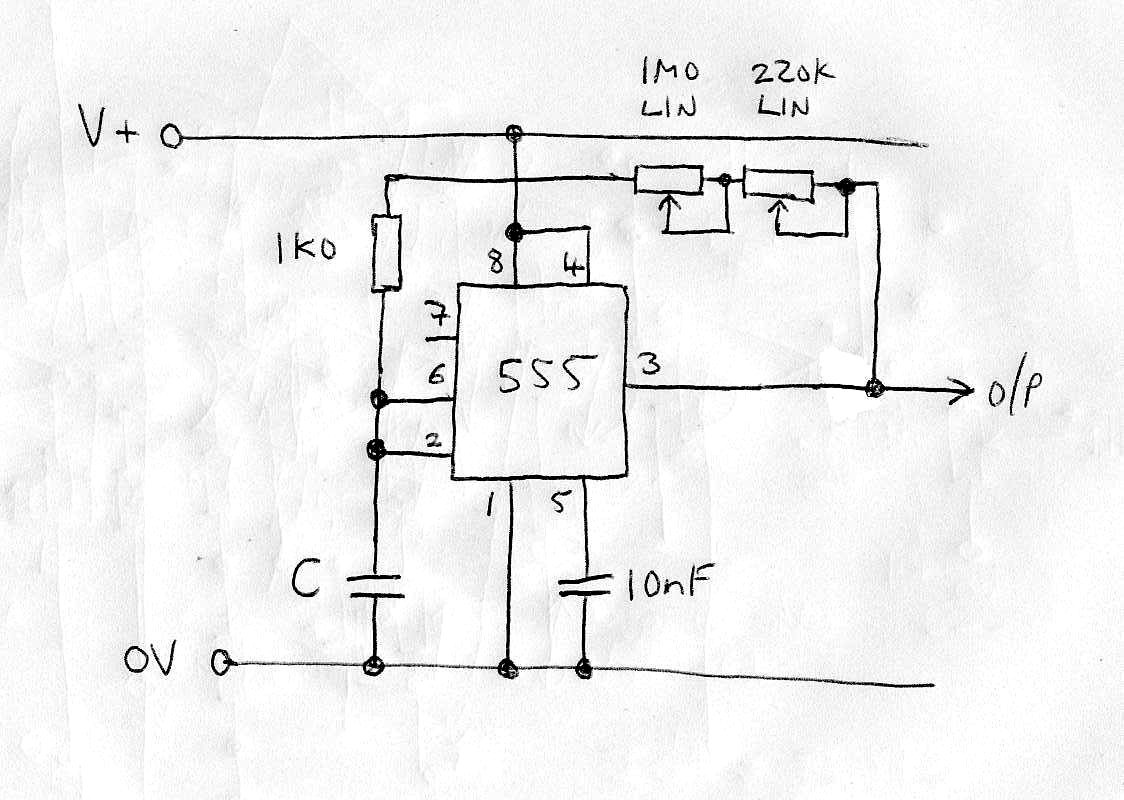

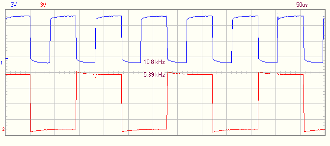

PostPosted: Mon Nov 05, 2012 5:35 pm    Post subject: New Idea? Reply with quote  Mark this post and the followings unread
I've tried a different approach to this problem and I've had better results. The circuit below has a different (and simpler) arrangement to the "normal" astable (note that pin 7 is not connected to anything). Also, I haven't shown any supply decoupling capacitors here. It has the advantage that the duty cycle doesn't change much with frequency. I've still needed to add a second pot for the fine tuning (the 220K lin - I just happened to have one at hand, you could try a 100K). Officially, the frequency is given by:
f = 1/(1.44 x R x C)
R will be the sum of all 3 resistances between pins 2/6 and pin 3. My actual measured values did not agree exactly with this, but were in the same ball-park. They also seemed to vary somewhat with supply voltage (I can't remember the voltage that you plan to use). With a 12V supply, I got the following results:
If C = 100nF, f = 8.9Hz to 11.2kHz
I C = 1uF, f = 0.46Hz to 635Hz
The duty cycle ranged from about 54% to 60% (that is the signal level was high for 54-60% of the time for each high-low cycle). The tuning was still a bit fiddly, but was much easier than my attempts on the original astable design. To get from 0.5Hz to 8kHz, you would need switching in the current set-up.
I also checked that the output was OK for CMOS, so I used a 4024 to half the frequency. I did this at two different 555 frequencies and it worked well (see traces attached). You can see that at the higher frequency, the waveform gets a little out of shape, but this is common at higher squarewave frequencies. The important thing is that in both cases, the 4024 successfully halved the original signal frequency.
You might like to play with this circuit yourself and see what you think, but I think that it is more promising than the original idea.
Gary

PostPosted: Tue Nov 06, 2012 4:00 am    Post subject: Reply with quote  Mark this post and the followings unread
My biggest problem is that it's already built, so I pretty much want to stay with the original config, and I want to stick with 500K trimmers, or higher so I have the option of touch sensors later.
But another thought occured to me.
There are four of them.
I should set up each one for a different frequency band, by keeping the resistors the same across all four, to get a range of just over an octave, and then just use a different sized cap for each. Which is kind of what the schem hints at anyway.
Keeping in mind that it's more percussive than melodic, I'd say 0-200,200-400,400-800,800-1600hz bands for the four clocks.
(No, this is wrong, I'll correct it when I've worked it out! Laughing )
Yeah, I think that earier design just charges through the resistor, but having (virtually) none to discharge it just produces spikes. Luckily they clock 4017s which can pick it up. If R2 is larger does that make tuning easier? Cos I could just as easily have it at 500K as well, but the cap would be suddenly very small, and inaccurate. Remember this trigger just clocks sequencers and is not heard, I reckon R2 could be 20K or so.
