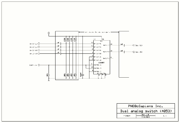

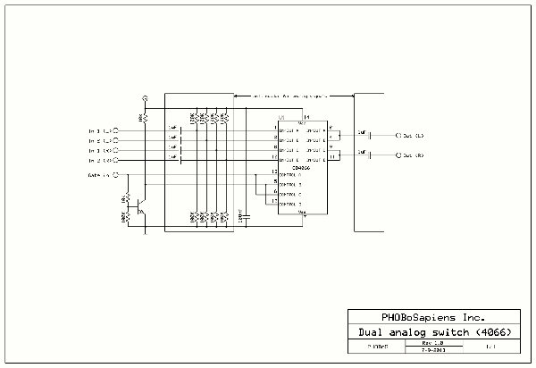

nathanxl
Joined: Apr 24, 2012
Posts: 77
Location: Wa
PostPosted: Sat Sep 07, 2013 5:43 am    Post subject: Reply with quote  Mark this post and the followings unread
Hi.
I have a need to switch 2 inputs out to one output from a gate trigger.
Say two different oscillators that alternate at the output to a single channel on a mixer when the gate trigger is high/low respectively.
Is this circuit what I need?
Cant really get my head around what is happening in the schem... Basically because Im stuupid.
Can some one dumb it down for me and explain what I need?
Posts: 5881
PostPosted: Sat Sep 07, 2013 6:42 am    Post subject: Reply with quote  Mark this post and the followings unread
nathanxl wrote:
Hi.
hmm let me see, please correct me if I'm wrong but from your question I get that you want a switch to select between 2 audio inputs. But instead
of a mechanical switch you want to do it with a gate signal ?
That can be done pretty easy, and you don't need the full circuit posted here, allthough with some small adjustments it could be used for that.
here's something that is more like what you want:
This version is for 4 stereo signals. and with the switch you can step through all 4 channels. But you don't need the control circuit (made with
FF1, FF2, N1..N4). All you have to do is invert the gate signal for one of the switch control pins. And you only need 1 CD4066, which gives you 4
switches so could switch 2 stereo channels or 4 monochannels.
having said that, this is the lunetta section so if you just need to switch the signal from 2 squarewave oscillators it can be done easier Rolling Eyes

Posts: 5881
PostPosted: Sat Sep 07, 2013 9:50 am    Post subject: Reply with quote  Mark this post and the followings unread
yes, you could also do it with a 4053 (4066 was just the first thing that came to mind). So I've drawn 2 schematics:
one using a 4066 and a transistor as in inverter, the other one using a 4053 which doesn't need in inverter.
It also has one spare switch (if you use it for stereo signals) which you could use for some indicator LED's.
you can find some more info on the biasing for analog signals here
note: for the 4066 version a high gate will select input 1, for the 4053 version a high gate will select input 2. (can be changed of course)
