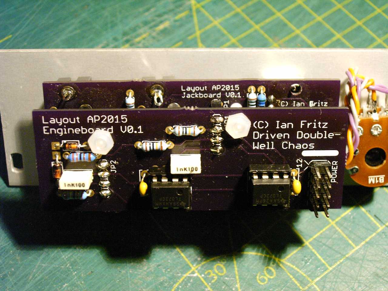

I had been thinking about using the other case for a synth with some chaos modules and maybe some (VC)LFO's.
I wasn't really planning on starting on it yet and first finish up some other stuff but for xmas I got a PCB set
from AlanP (thanks Alan! Very Happy) for a "Driven Double Well Chaos Module" (Ian Fritz design), to be used as a euro module.
I also designed a PCB set for the WaveWiper to be used as a euro module as well. And to test those

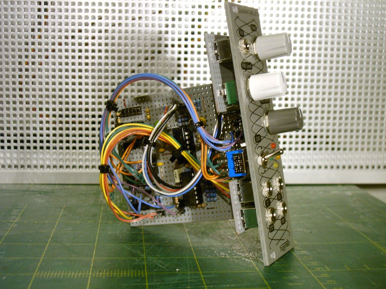

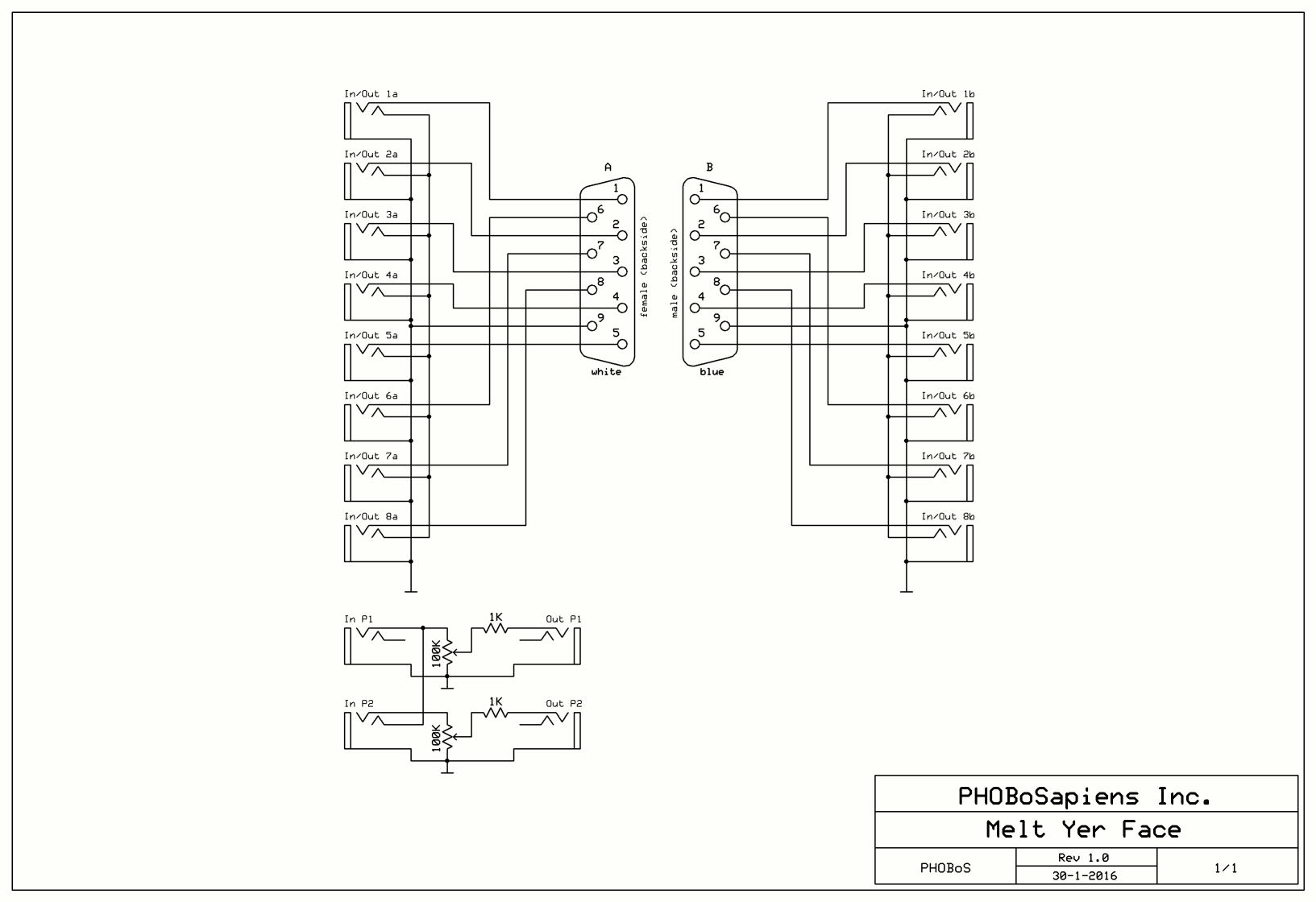

All my other synths use 1/4" jacks so I need something to convert those to 1/8". My initial idea was a panel
with both 1/4" and 1/8" sockets but you can't get a lot of 1/4" on a panel. So instead I made a panel
with 8x 1/8" sockets connected to a 9P sub-D connector. This will plug into a breakout box with 1/4" sockets
which, as an added bonus, I can put next to my synths. when nothing is plugged in on the other side it
also acts as a multiple. It can also be used as a multiple when something is plugged in but than I have to
leave a minimum of 2 sockets unused. Since there was some panel space left I also added 2 attenuators.

Hi PHOBoS, I have a question. Looking at your MeltYerFace module, I see you mounted jacks with solder lugs on a perfboard. They seem intact so how did you manage to squeeze them through those holes?
Posts: 5881
PostPosted: Wed Mar 09, 2016 4:42 pm    Post subject: Reply with quote  Mark this post and the followings unread
I drill 2.5mm holes for 3 of the pins, the 4th one can just be pushed through.
You can probably use a smaller drill but that's what I have and works.

And another one finished: the Yusynth Quadrature VC-LFO.
It didn't go a slow as I wanted it to be so I replaced the 10nF caps with 100nF ones.
After I had done that I wondered what the trimpot was for. doh So now it can go
very slooooooooooooooooooooooooooooow.
I should get some new sharp drillbits so holes will actually be where I want them.
