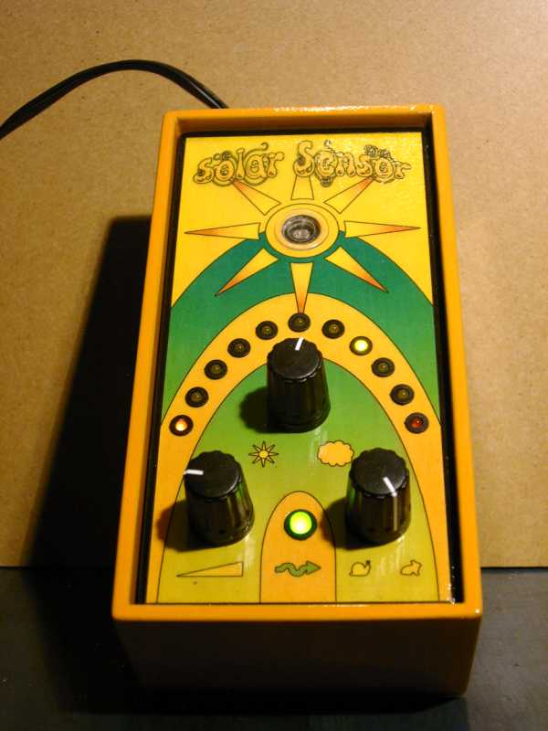

speaking of sensors and LDRs here's a circuit I designed a while ago.
I thought I'd posted it before but can't find it right now.
(some more photos can be found here)
