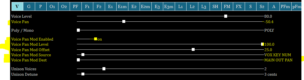

Some time ago, I acquired an Ensoniq-ESQ 80 for like 80 bucks -- and was in love with how wide and stereo rich the sounds were. I realize it was because with most patches, the lower notes were left panned. And the upper notes were right panned. So, each note/voice essentially has it's own unique space in the stereo image.
I sought to recreate this effect on the Andromeda, and was happily blown away.
- set voice pan to "-50"
- enable voice pan modulation
- set voice pan modulation lvl to "100"
- set voice pan modulation offset to "25"
- set voice pan modulation src to "vox key num"
- set voice pan modulation dest to "main out pan"
I went back and updated some of my pads, and was REALLY happy with how wide, phat, and stereo everything became. This is why the Andromeda is the king of all analog polysynths.
Try it out!

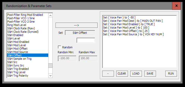

p.s. This also gave me an idea for a feature for my Andromeda Editor. I'd like to have lil customizable 'batches' of settings that people can create. Like, one could create their own groupings of parameter changes that are saveable, and then easily applicable to any Andromeda Patch they have loaded. They could save the above setting changes as "Stereo Pan Modulaton" -- it would get added to a menu somewhere, and when selected, it would apply all those settings easily and quickly. BOOOM.

p.s!
For anyone with my Andromeda Editor, I actually got around to implementing my idea above, "Parameter Sets" !
And also added the ability to constrain the Randomization with "Min"/"Max" values -- check out the screenshot attachment Smile
