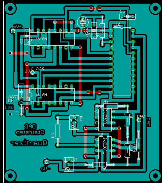

PostPosted: Mon Nov 26, 2007 1:52 pm    Post subject: Reply with quote  Mark this post and the followings unread
well finished it, um havn't tested it. Need an AD7245!
posting it to see if anyone wants to try it out/test it, or look through it for errors. the clock is not on this board though as it will be on the channels board! heh
all red are links, J1 is the link between AGND and DGND .

I may be able to spare a 7245 'cos I just checked and found I'd got two as samples sometime last year (yeah, its a shame they seem to have changed their sample methods now - guess that was a golden age of many good free chips!)
- also, I think you've forgotten to connect the pin4 v-s of the 072s to the main V- used on R5.
I'll PM you..
