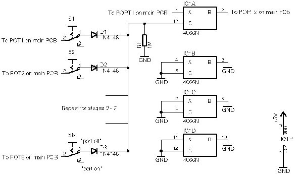

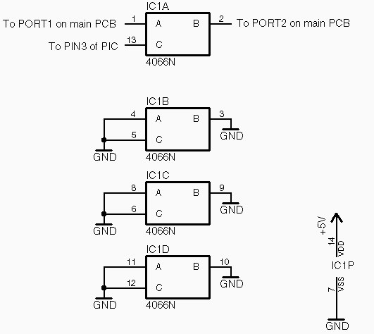

Here are some details for the programmable portamento mod I have been
working on.
There are two options for this mod.
OPTION [1]
This requires the V2.1 software, and means you will relinquish the CV stage
control functionality, but you do get the new mode4 "fixed length sequence
mode" !
The portamento is set via programming each stage, using the "hold reset"
switch method described in the docs.
The settings are retained on power off.
OPTION [2]
This doesn't require new software, but you will need to add 8 1P2W switches
to the panel, and a bit more spaghetti wiring !
Option [1]
First of all if you have already built the PCB then remove the following
components:-
Q6, R13, R16. R19, R21
If you haven't built the PCB yet then do not include these components.
Then wire up a 4066 chip on a small piece of veroboard, using the
"Portamento mod opt 1" schematic diagram.
The mod board is connected to the main PCB via the GRND, +5, PORT1, PORT2
connectors, and PIN3 of the PIC chip.
Make sure the 4066 mod board is insulated and attach to the main PCB.
Option [2]
Wire up a 4066 chip on a small piece of veroboard, using the
"Portamento mod opt 2" schematic diagram.
You will need 8 1p2w toggle switches, 8 in4148 diodes, and a 1M resistor.
The switches are wired from the POT1 - POT8 connectors on the main PCB,
and to the mod board via the diodes.
The mod board is connected to the main PCB via the GRND, +5, PORT1, & PORT2
connectors.
-ryk

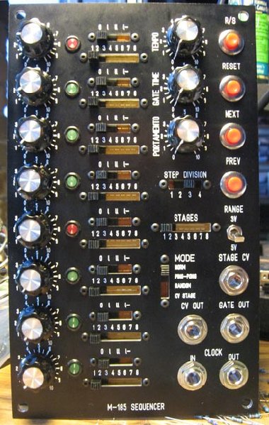

Here is my version of the M-185 sequencer, it's based on Ryk's design but in MOTM format. It was a tricky build but well worth it Smile Those little switches are a tight fit! I managed to get it running without too much trouble. Thanks again for offering this excellent project Very Happy Very Happy Very Happy

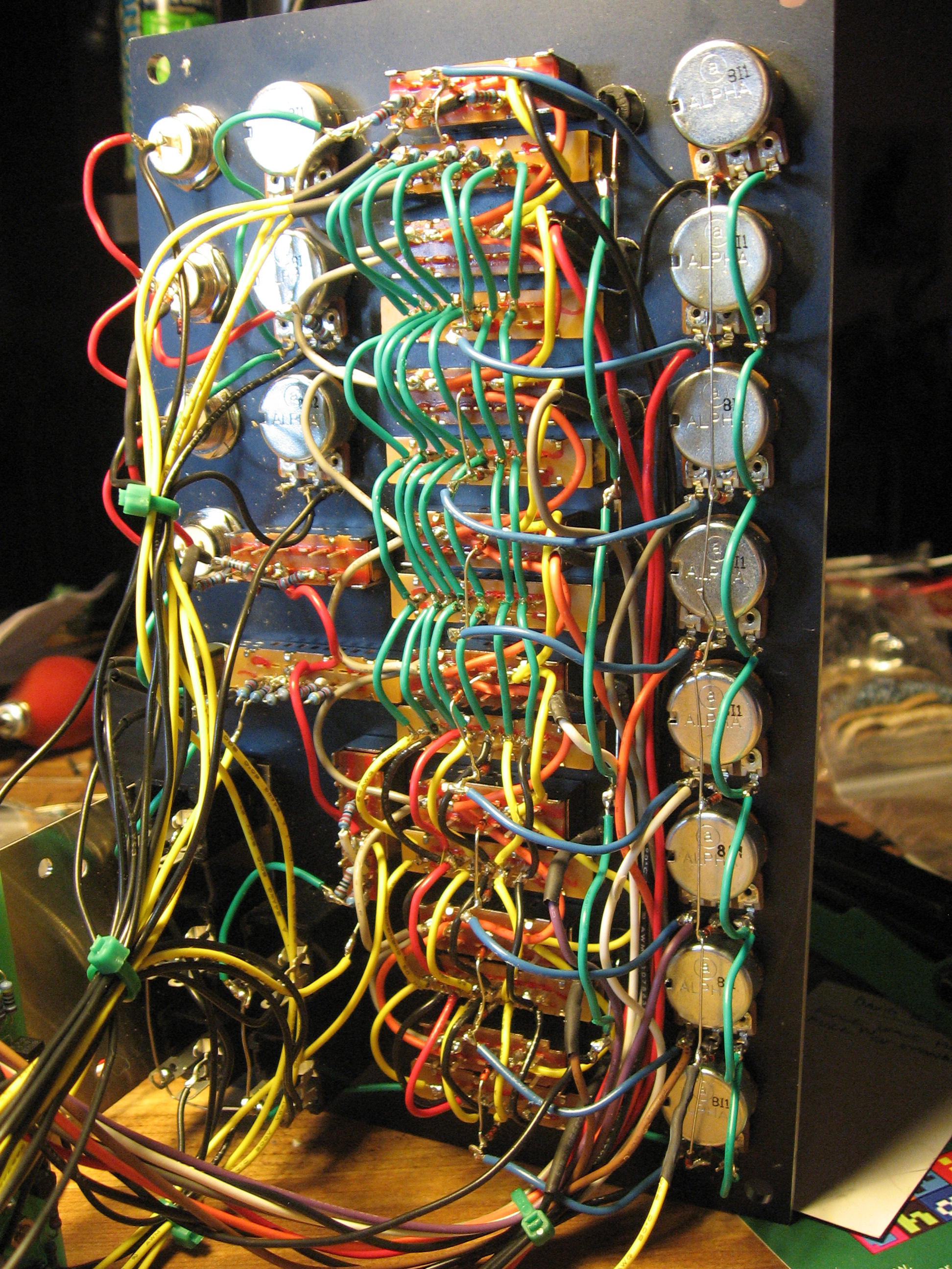

PostPosted: Mon Apr 20, 2009 4:47 am    Post subject: Reply with quote  Mark this post and the followings unread
Hi Dave,
lucky you Smile i am still working on mine. Short question which you might be able to answer which is correct:
(a) wire up all P1-P8 1:1 and then add the resistors on P1
or
(b) add resistors on P1 and wire up P2-P8 and then connect it to the "resistor" points as well.
or even easier: show me the back of your frontpanel.

PostPosted: Mon Apr 20, 2009 11:01 am    Post subject: Reply with quote  Mark this post and the followings unread
Hi Unit-sound,
(a) is what I did, connect all the switches (1-8 ) in parallel and the resistors go on switch one only as shown on the diagram. I was initially confused at this too, actually at first I thought I was going to have to add resistors to all the switches Shocked Shocked then I read though the construction guide and carefully followed the diagram and after a lot of wiring got through it Very Happy although i think the portamento pot is shown wired backwards on the wiring diagram, it's an easy fix anyways if you have to fix it.

PostPosted: Mon Apr 20, 2009 6:09 pm    Post subject: Reply with quote  Mark this post and the followings unread
I would also love to see a shot of its backside, the front looks kickass! Real NASA vibe.
Also, where did you score your screws for the switches? Awesome look there as well.
Thanks Very Happy I worked hard at getting it right, I had some help from Krisp1 and unit-sound for getting the fine details right Cool
I've attached a large JPEG file so you can see the detail. There is probably an easier more efficient way to wire it up but this is how it came out Rolling Eyes the resistors were a pain to get on the switches but in the end it was actually kind of fun, I felt like I was building a sculpture or something Surprised
I got them from smallparts.com, even though they are sized M2.5 I found for my switches that I got from Ryk that the 4 position switch the holes were too small for the M2.6 and for the 8 position switch the M2.6 fit but the M2.5 also fit and all I could find for M2.6 were the larger hex head or socket head screws that interfered with using the switch. 5-6mm length should work fine any longer and you won't be able to switch to the first and last position.

PostPosted: Tue Apr 21, 2009 7:18 am    Post subject: Reply with quote  Mark this post and the followings unread
WOW thanks Dave. Looks great, pretty much I what I had envisioned for the vertical columns of wiring. And double thanks for the link to the screws, I am very bad with such things.
Time to order my panels.
