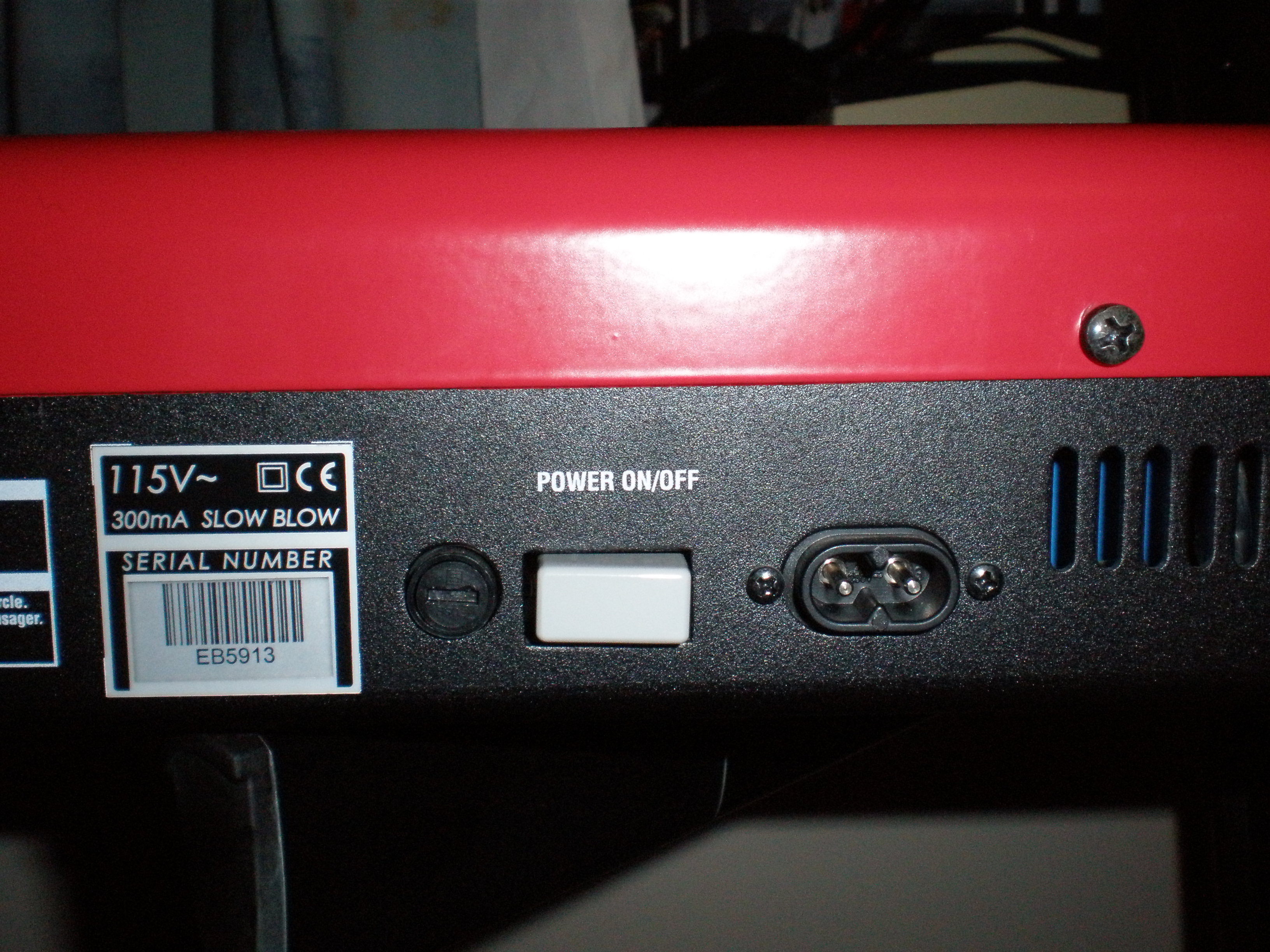

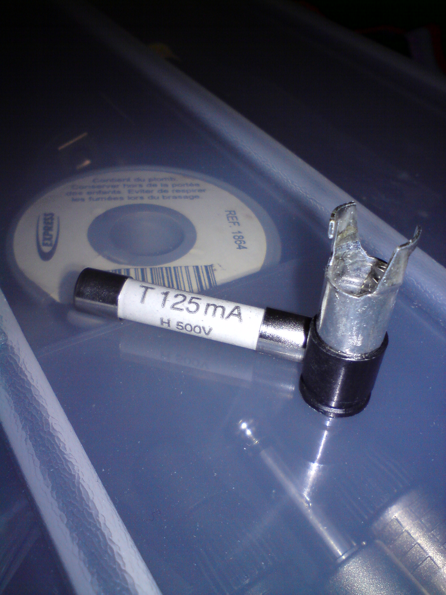

Replacing the fuse:
Locate the fuse holder on the back of the keyboard, just left of the power switch - see picture.
Using a flat head screwdriver, gently open the fuse holder: a fraction of a turn should release the holder, which can then be removed.
For this conversion (115V to 230V) the old fuse (250mA) must be replaced with one rated for half the current (125mA).
The Electro 2 takes 1¼" (31mm) fuses, see picture below.
I had trouble locating the fuses, so I had to order online, leaving me with 9 more than I needed Rolling Eyes .
If you have the same trouble, pm me and I'll post you one. Smile
And it may seem stupid, but glass fuses will break if you're careless.
I found that out the hard way when I dropped one on a tiled floor mad, short circuit
Anyway, replace your fuse and you're ready to switch voltages inside the board.
Back of keyboard showing fuse holder.

OK, here's my experience:
My mint US Nord Rack 3 came with a Ø6 x 32 mm 300mA (3/10A) slow blow fuse.
So I replaced the 300mA with a 125mA model for 230V operation [Ø6 x 32 mm 125mA Time Lag Fuse (Slo-Blo®)]. Then switched the PSU to 230V... Did some cleaning and organization under the rack... And decided to add Zalman heat sinks to the 6 120MHz DSP chips... I'm thinking about adding 1 more (bigger) heat sink to the blue power transformer to help it cool down (adhesive thermal pad needed + heat sink needed).
Finally, replaced the original power cord with a brand new one (IEC C7 connector/2 pin EURO) and powered up the Nord... Works!
Great synth!!!
Nord Rack 3 US - Ø6 x 32 mm 300mA slow blow fuse

Nord Rack 3 - Ø6 x 32 mm 125mA Time Lag Fuse (Slo-Blo®)
