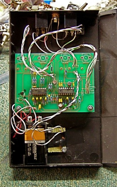

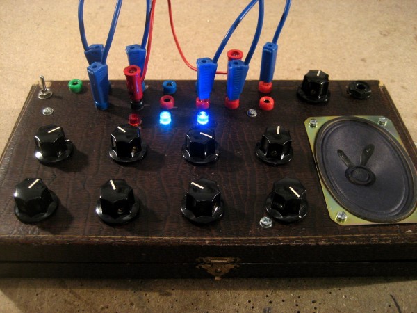

A kind of super-Benjolin... “Catjar in the Rye” (or “Betty”, as she is know to her friends) is an experimental sound instrument built for Swedish composer Andreas Catjar. It combines a chaotic Benjolin synthesizer, extreme fuzz distortion unit, a speaker/contact-mic feedback system and “circuit-bending”-style body contacts into one rugged flightcase. The Benjolin features several modifications, including patchable routing banana jacks, LED lights for the three stages of its analog shift register and an external audio input.
My thanks go out to Rob Hordijk for providing this circuit, and to Pete Edwards/Casper Electronics for his help in working out the modifications.

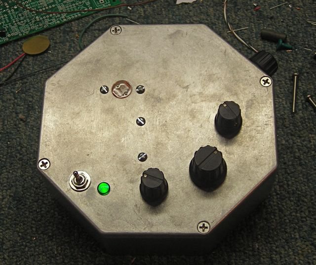

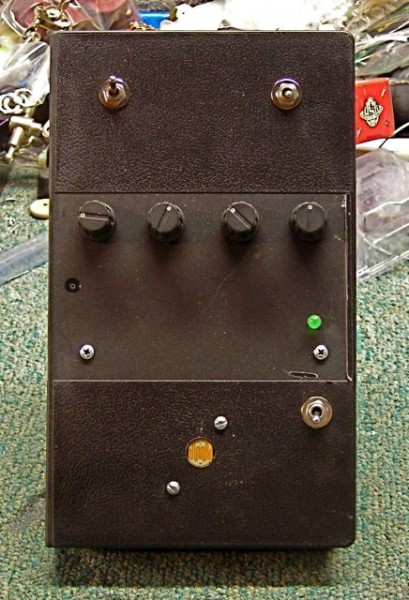

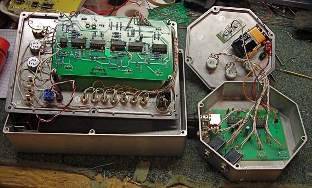

new zeitgeist. awesome audiofuckery. modified the board layout to allow for mounting the pots on the front or the back. NOTE: the footprint of the 1702 regulator is NOT THE SAME as a standard 7805... released some majic smoke finding that out, check your data sheets. gonna live with it for a bit, but may add an attenuator on the cv in, could use a little taming
