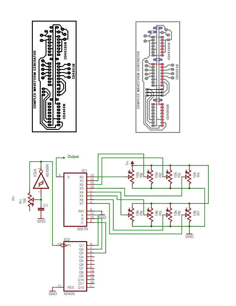

akrearke
Joined: Sep 08, 2008 Posts: 53 Location: US
Posted: Thu Dec 10, 2009 9:51 am Post subject:
Lunetta designs |
I post a lot if things here on electro music. Unfortunately, limited finances does not allow me to build most of the designs or finish them. However, I like to share... Here are my lunetta foils if anyone is interested. Most of them will be found on this site and others. The schematics are often included. as always they will have to be sized using the DIP pins. Thanks to everyone that provided the information. All remain untested...

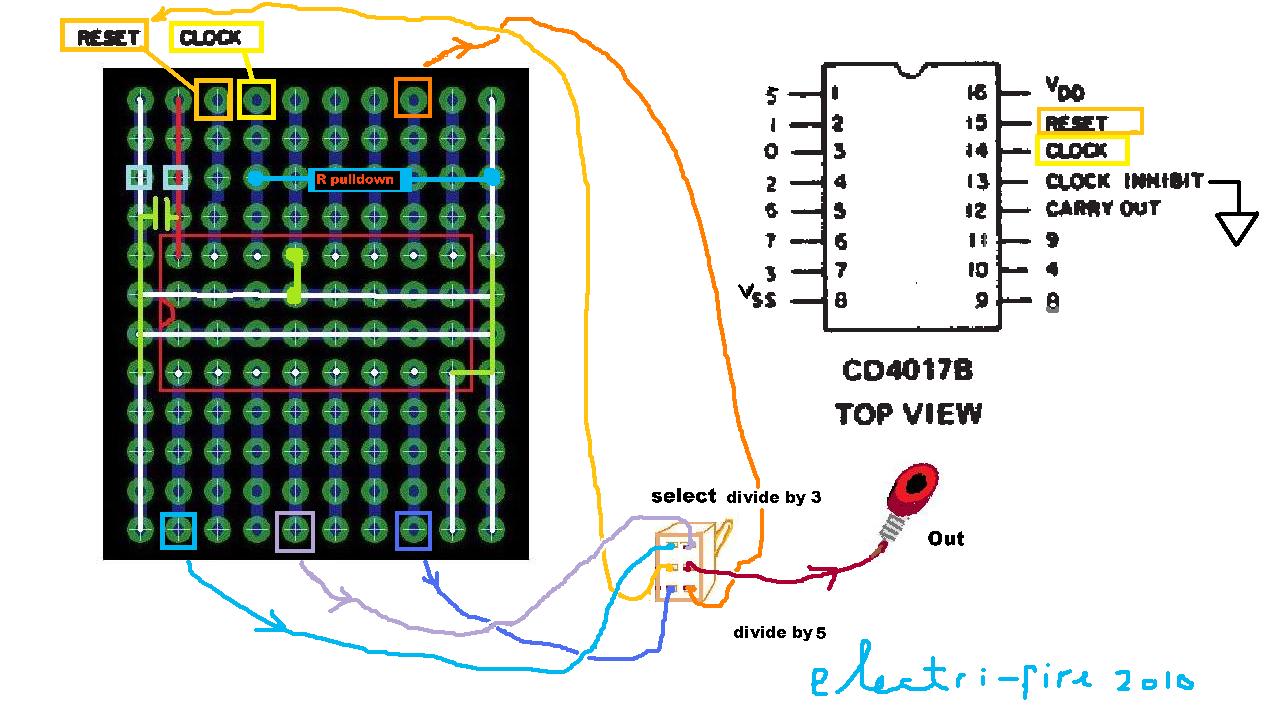

electri-fire
Joined: Jul 26, 2006 Posts: 536 Location: Dordrecht NL
G2 patch files: 4
Posted: Mon Feb 22, 2010 4:47 am Post subject:
Subject description: Some Lunetta modules on e-chuck boards |
Some CMOS on Invertor's E-chucK boards.

electri-fire
G2 patch files: 4
Joined: Oct 13, 2007 Posts: 6221 Location: near Austin, Tx, USA
Audio files: 267
Posted: Mon Feb 22, 2010 6:21 am Post subject:
electri-fire, thanks for posting these! Its nice to see those boards getting some good use now.

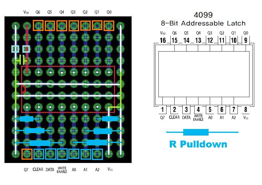

Posted: Tue Feb 23, 2010 4:40 am Post subject:
4021 8-stage static shift register |
It's all in the datasheets, not exactly rocket science. But ok, one more then.

electri-fire
G2 patch files: 4
Posted: Tue Feb 23, 2010 5:04 am Post subject:
4031 updated |
| I had a pulldown on the 4031 drawing that shouldn't have been there. Please reload if applicable. |

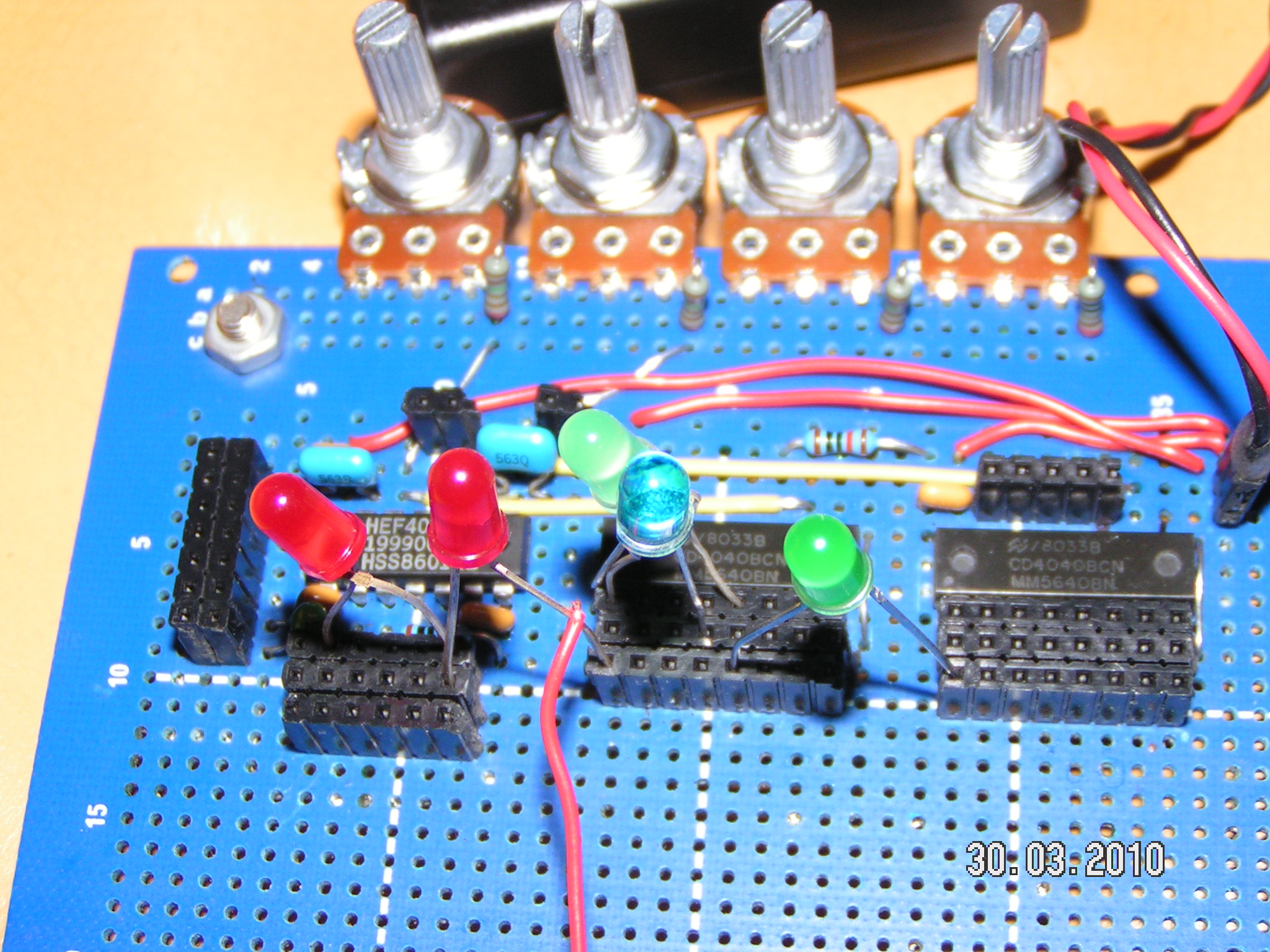

Posted: Tue Mar 30, 2010 3:02 pm Post subject:
Use of multiple in/out's with Mickey Mouse Logic LED's |
So I built these one-chip modules, and droffset asked me in the chatroom recently how I get these organized. I had to admit I had these on the lap, pots, wires and batteries dangling all over the place.
Inspired by droffset's latest build, I decided to go a similar route, building a No-Frontplate-Lunetta, that can host my CMOS modules and have some generic stuff hardwired on board.
I mentioned wanting multiple out's, wich I have indeed, and they are great fun.
This being the design section, not the Show-Your-Lunetta thread, here's an interesting observation. You may have heard of Mickey Mouse Logic:
http://www.musicfromouterspace.com/analogsynth/mmlogic.html
I have a 40106 with 4 osc's, two of them hardwired to 4040's.
Playing around with LED's between random outputs (three of each) and picking of the sound from the LED's intermodulates the frequencies nicely. With multiple LED's, the sounds are different from each LED lead, but obviously rhythmically related. Nice for stereo. I'm starting to wonder why I'd even bother with this Gate stuff at all.
I will definitely add more output headers to accommodate interconnections with LED's. Maybe I best make an array of LED's near the in/out headers, some of my LED leads are too thick for the in/outputs, and having different color LED's is fun. Also my LED leads are bent all over the place now, and have to be forced in.
All LED's would need double (ah, make that triple) header in-out's to be able to send the sound to my mixer (a TL062, chosen for it's low power use).
This setup beats any rude words out of my CMOS Gate modules. It's fast and versatile, cheap, needs little space on the board, is easy to build, and could replace your fixed LED's.
electri-fire says: Recommendable.

droffset
Joined: Feb 02, 2009 Posts: 515 Location: London area
Posted: Tue Mar 30, 2010 7:51 pm Post subject:
Cool that you're using the LEDs that way. So the 1 or 0 value at each side of the LED is doing its own gating? Pretty sweet.
Multiple outs is a good idea, I've had to splice together Y-splitter cables to get mults.
EDIT
Posting this image in this thread to show how I did the overall design for mine.

| droffset wrote: | | So the 1 or 0 value at each side of the LED is doing its own gating? Pretty sweet. |
Exactly. All connections are made between outputs. I have 5 LED's in the posted picture with some leads sharing an output. So there's seven different sounds going on there. Doing this with gates takes two IC's at least.
I figured a bunch of patchable LED's might benefit from multiple in-out's but there's no need for that. As the LED leads are plugged into CMOS outputs I better make more of those.
Hmpff, I never seem to make up a layout and actually pursue finishing it as planned. I had already soldered part of a potmeter assembly consisting of 8 trimpots. These will have DIP switches to switch them in series. The wiper will have two inputs, straight, one through a resistor.
The idea is to have this configurable as single pots, adjustable R/xR DAC's, and whatever comes to mind later, probably disrupting any conceptions of what it should be able to do later : : .
So between this row of trimpots I had room planned for three E-chuck-Lunetta boards, but that's not going to happen. My little mixer is screaming for more inputs. I had 8 Normally Open Momentary to +V, plus one "engage switch" planned, for use with a 4021 shift register and 4042 S&H module, but eventually wising up I'll refrain from soldering them up for now.
I think this will have to be a relatively low chipcount Lunetta. |
