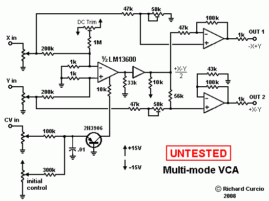

My way is simpler.
http://www.sdiy.org/richardc64/mmvca/index.html

Oh that *is* elegant! Response is linear, isn't it? Maybe better for CV crossfade than for stereo audio output...

Haha thanks for the reminder i must post the schematic
as i said i would, my apologies , completely forgot about it Embarassed . will try and get it posted before the weekend.

Never seen my stuff called "elegant" before. I'll have to remember to keep a pinky raised whenever I post Laughing
Yeah, it's linear
diablojoy wrote:
It does indeed look good
I think i could get 2 on a smallish board, would make a nice ancillary module might try and test out the lm13700 version
as long as it's ok with richardc64 ?
Go for it. Might need a different current source than what my untested schema shows.

If you work that one out, please let me know. I have a ton of dual OTAs sitting around. Can you explain why the LM13700 version needs a different current source than the 3080? Couldn't the op-amp buffer used in the single arrangement also be used in the dual? This part is a bit beyond my understanding...
Mine too, actually. But no, the op-amp and diode trick supplies the 3080 Iabc (the control current), AND -V. In the LM13700 -V is common to both OTAs, so this method can't be used. That's why I show the simple one-transistor current source in the untested '13700 version, but that might be too simple, and something better -- like a current mirror -- could be needed.
Someone more knowledgeable could perhaps offer some advice, if we could get that "someone's" attention.
That's interesting, since I was recently asking about the differences in OTAs in another thread. I was assured there wasn't much, now you're here to prove them wrong!

First, this is really a brilliant design. I'm surprised it hasn't been pick up on before. I think lots of folks would be interested if boards were available. People seem to be getting more and more interested in modules with lots of features.
Comments on the original design: The reason for the oddball resistors around A4 is most likely that the left side of the 47k sees a finite impedance. If this point were buffered then the three odd resistors could all be 47k.
The unknown R below the Init control is there so the input CV (eg, envelope) can be burried below zero. I think it could actually be omitted, depending on how you like to use the CV In. IOW the Init pot can go across the +/- supply.
On the OTAs: When the 3080s were going away I suggested everybody stock up on them because of all the designs that use the Jung trick of driving through the power pin. I have a pretty good supply myself and I could probably let a few go for projects like this.
The question of whether the same drive configuration could be used on the 13600/13700 has been asked but AFAIK never resolved. Would it still work if only half the chip were used, or if the two halves were connected in parallel???
The untested current source would probably work, but I would prefer an active (opamp) summer approach. See the pt. 2 drawing here:
http://home.comcast.net/~ijfritz/Chaos/ch_cir6_chaotica.htm (lower left)
So at the cost of a dual opamp you could make the circuit a bit more precise. A matter of taste, for sure.

Most brilliant, IMNSHO, is that it doesn't need switches to select the different functions. Less brilliant is that, since it uses just one OTA, it can't function as two normal VCAs, like the more common panning method.
Not sure what that means scratch
I think I remember now; without the "unknown resistor" the init pot had to be rotated far off-center to make a single input come out at roughly equal levels on both outputs. Rather than figure out why that should be, I went for the expedient fix.
THAT's something that might be worth exploring. Wish I had the facilities.
Yeah, that does look better. Besides being more precise it's simple enough to make trying to apply the Jung trick to the '13700 unnecessary.

Hmmm... Let's try looking at it from a different angle. The outputs are not linear functions of the input pot settings, ie the gains of the two output amp circuits depends on the input pot settings. If you buffer the pot wipers, then the behavior is ideal. But maybe that's not the main issue here, especially if you do all the setup with the input pots full up or full down. So the needed R values might need a bit more explaining.
That's odd. It was OK at the endpoints but not the middle?
I should have written "...had to be rotated too far clockwise..." The unknown resistor allowed the 2 outputs to be equal when the init pot was centered. In other words, without the resistor the CV was "buried" over much, much more than half of the pot's rotation.

So I finally tested the power-pin biasing on the LM13700. Using one half of the pair works exactly the same as the original. Using the two halves in parallel also works. I've started a new thread on the circuits.
http://home.comcast.net/~ijfritz/Chaos/ch_cir5_twc.htm

OK, my eyes are starting to swim a bit here, let me see if I understand what is being suggested. The op amp summer shown in the attachment below (Picture1.png) should replace the transistor arrangement in the lower left of this image:
Where "c" in Ian's drawing connects where the 10K resistor enters the LM13600. Right? What pin on the IC is that, Richard? In your first, tested VCA layout you are using both 4 and 5 for the biasing. So in the second, you use which? Or does it depend which half of the OTA IC you are aiming at?
Help me connect the last dots please!
Also, do I understand you correct Ian when you say this arrangement has been tested now? Thanks for sharing your time with us!
Ian Fritz op-amp summer from http://home.comcast.net/~ijfritz/Chaos/ch_cir6_chaotica.htm
macumbista.net

Last question: the CV for this VCA would be bipolar, or positive only?
Pin 1 or 16, depending on which half of '13700 is used.
The original, with the Jung current source, was intended to function with either, with proper adjustment of the "initial" pot. As for Ian's method, I think I might've gotten in a bit over my head, here.
Maybe I should've kept quiet.

Also, do you think there is any way this circuit to could overall voltage-controlled gain (like the Serge X-fader)? Maybe more CV summing tricks? Or another VCA needed? Hmmm....

This circuit shouldn't be any different with am LM13700, should it? See again my thread on differences between OTAs...
