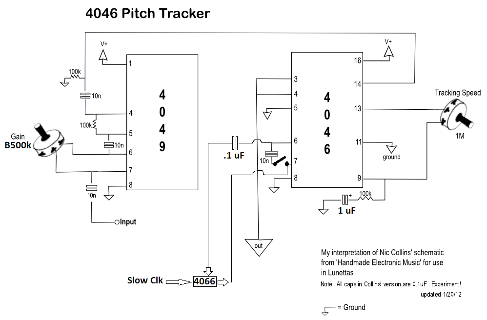

Heavens! I never posted the schematic!
Updated layout for clarity...I hope :)

Despite this circuit looking pretty simple, I had a lot of trouble with it. I can't really figure it out. Without the 4049, I got nothing. If I don't adjust the pot on the 4049 just right, I get nothing like the lasers. My chips are CD4049UBE and SCL4046BE.
Why is the even 4049 necessary? A 9-volt square wave as input to the 4046 should be fine, no? I need to do more tests, because this isn't the first time I've had problems with both these chips.
Nevertheless, after much tweaking, I did manage to get some really cool sounds from this circuit. I really want to work out the bugs so that it's easier to use, but in the meantime... here's me trying to embed some soundcloud tracks...
In "Capsirrither", there are also a melody generator and a VCO going... the 4049-4046 is making the castanet sounds.

Sorry to hear you had troubles with it. No, the 4049 isn't essential in our case. I have been able to get pitch tracking just by running your typical lunetta outs/gates through it.
I left the 4049 in because I love the variation in sounds I get when I crank up the gain pot. I've had my troubles with ic's that others had no problems with; so I understand your frustration completely.

Thanks for fixing the circuit, but I still can't really get this to go.
I think something is wrong with my 4049's... it's frustrating... I went back to Nic Collins' book and tried those circuits, and can't get the 4049 to amplify anything, just like when I tried those last year. Thing is, I tried a 4069 (rewiring for the different pinout) and that didn't work any better. Maybe I'll try a different brand of 4049 if I can find one, but for now, I put those aside again and move on to something else.
Mine are 4049UBE... maybe it needs a 4049B? The U would indicate that it's unbuffered, right? Which is strange since the chip is an inverter-buffer, so how can one have an unbuffered buffer?!

This is indeed strange. I'll take a look at my mass of wires that my lunetta currently looks like to see what 4049 I'm using. That said, this chip shouldn't be so essential that the pitch tracking effect doesn't work.
I am almost done with my lunetta rehouse project: I have 2 Pitch Trackers in mine now. One as shown above and one without the 4049. When I get my last module installed hopefully by this evening, I can give them a test run.
I know for a fact this circuit works and is a cool setup to have. Here's the breadboard version from Google Books:

Quick check: mine is a 4049UBE too Shocked ! At least you can eliminate that as a culprit.

Thanks for checking the chip. I just don't get it... Using my oscilloscope I can see that the signal coming out of the 4049 is definitely not amplified. I bypassed the input/output caps on it and still no. The chip otherwise seems to work... e.g. I can see that the signal is inverted coming out of the first inverter, and then back again after the second. Mysterious, mysterious.

I've experienced similar problems and every time it was just one wire mis-connected or loose. Quadripple check your connections to a circuit diagram!

I played with this circuit for a while and here's what i came up with...
I liked a .1 uF cap between pins 6 & 7 of the 4046 best. I noticed a cool effect when i removed that cap and then placed it back in. So, I rigged that cap up so it could be automatically switched on and off by a clock (I used a 40106 w/ a 10uF cap and a 1M pot) through a 4066 chip.
I later found out that it was also cool to put Draals original 10nF cap between pins 6 & 7 while my .1uF cap was switching on and off. So, I wired that back in and put a hard switch on it to shut it on or off depending on which effect is desirable. (see attachment)
This is an awesome circuit and it makes a real nice addition to my lunetta. I've almost finished the panel for this module and i'll be sure to post pictures when it's all finished. Thanks again Draal.

Hey, glad you're playing around with Nic Collins' circuit. Smile ! I could not see my lunetta without one. Getting creative with the caps at pin 6 and 7 as well as the loop filter opens up more tonal options. I'm adding one to my mini lunetta, so I plan on taking a closer look at the tweaks you mentioned. Pins one and two can also be wired out to jacks for even more noise.
Pin 5 will be experimented with; Slacker's 4046 VCO notes mention pin 5 offers modulation possibilities Twisted Evil .

I'm going insane. I just can't get this circuit to produce the cool sounds like Draal. Have others built this circuit successfully? Am I cursed? Does it not work in Canada?
I really want this circuit to work, and it's a pretty easy one, too. I've breadboarded it several times, starting about 2 years ago when I got the Nicolas Collins book. I have tried 3 different brands of 4046.

Sorry to hear you are having a hard time with this circuit Sad . I have built 3 and I get the sounds I've posted. I will build another one on bread board and see what gives.
If we can't get to the bottom of this in a week, hell, I'll build ya one on perf. Hope to breadboard tonight.

More data, grasping at straws: I power my Lunetta mess with an unregulated 9V wallwart (which tends to give more like 12V). I also tried a 5V one. I've successfully built VCO's using these 4046s I have (Motorola MC14046BCP, Harris CD4046BE, and Solid State Scientific SCL4046BE).
I also tried the ol' 100nF on the power pin to ground, as well as a 100k pulldown on the input pin 14.

I built this guy on breadboard this evening and got it up and running despite some goofs. I had no lasers for a bit and I scratched my head. I went through all my wires and noticed the ground connection fell off the board Rolling Eyes .
I run my lunettas off a regulated 12v wall wart as well as a switching supply and I have both active and passive mixers at the output. No difference in sounds to my ears.
I got "wormsign" when I turned it on again and said, whew, I know this circuit works. The other goof is a schematic error I need to correct on the lugs of the pitch tracking pot. Nic Collins has the middle lug going to pin 9 and the outer lug to pin 13, my layout has em' switched. Doesn't make a difference Wink ; lasers still generate regardless of lug orientation. Now for the proof:
