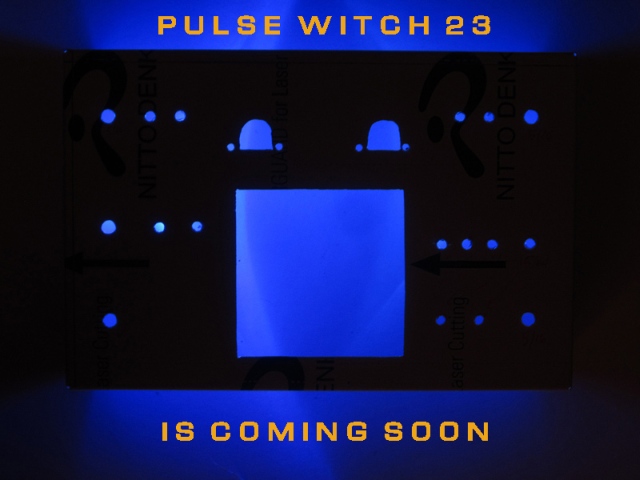

PostPosted: Tue Oct 01, 2013 7:57 am    Post subject: Reply with quote  Mark this post and the followings unread
One year later, and a couple of time-consuming massive projects done, I finally figured out all the circuits and putting this thing in a box. With what I hope is a good mix of playability and standalone options.
Some of the soldering is done, but at the moment, I'm stalled due to trying to work out technical details involving the enclosure... there's a special thing I'm trying to do, which I think is going to be quite cool if I can pull it off. It's secret right now Smile.
In the meantime, here's the box drilled and cutout...
James.
