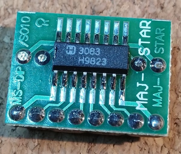

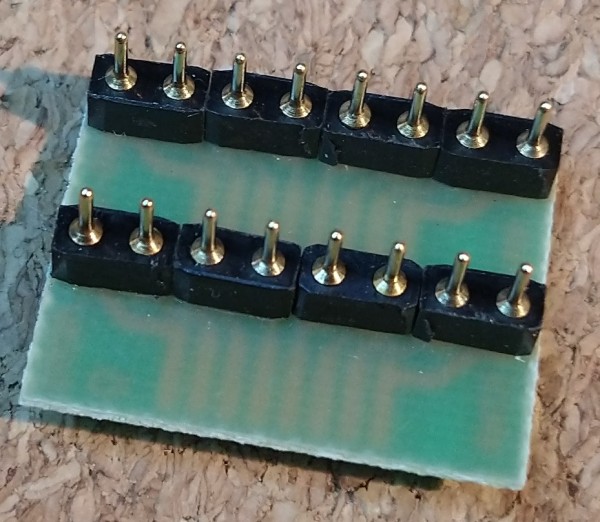

1. Simple adapter.
This adapter is cheap and simple to make - only drawback is asymmetric look and footprint.
First solder pins. To get pins in line you may put them into IC socket before soldering. Remember about correct diameter of pins. Cut out soldered pins from the IC side. Wash pcb with isopropyl alcohol. Then solder IC. Wash pcb again.
