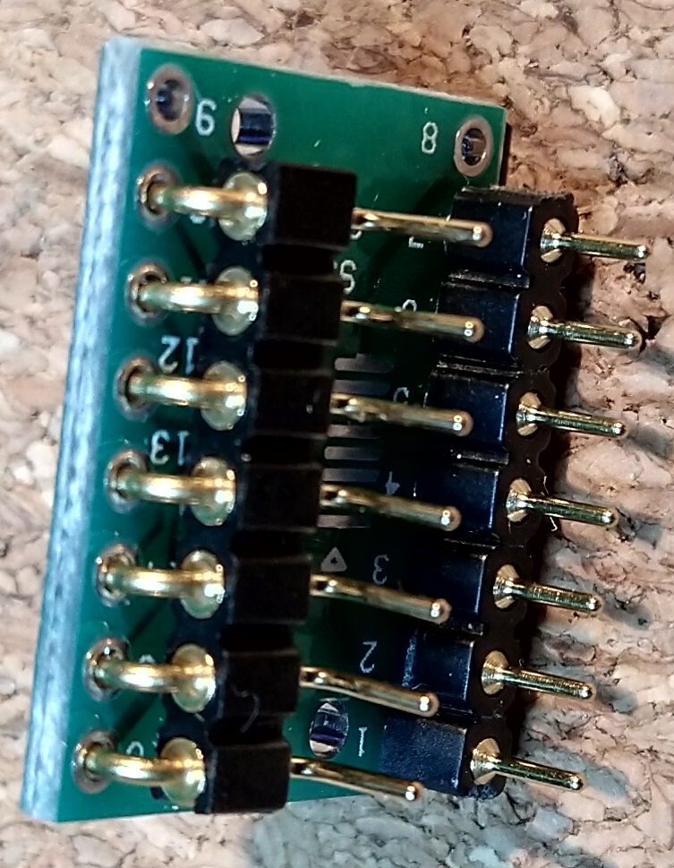

2. Cheap adapter.
There are a lot of cheap adapter SOP14 and SOP16 pcbs widely available at aliexpress or from local dealers. But they have one drawback - they are designed for the memory programmers rather with wide pin distance (0.5" or 12.7 mm). For the first look they are unusable for the 7.62 mm IC sockets, but with angled pin connectors we can do it. The drawback is obvious - larger, asymetric footprint.
Angled connector pins must be bent with a pliers (carefully to not broke the pins). Which way - you can see on the photo. Before soldering, put pins with pcb into the IC socket, then solder. Wash pcb with isopropyl alcohol.
Pins from the IC side may be cut off or may stay as a testing points.

Cheap adapter - bent pins.
 Filesize:  265.65 KB
 Viewed:  289 Time(s)
Cheap adapter - top (SOP16 used as 14)
 Filesize:  244.12 KB
 Viewed:  290 Time(s)
Cheap adapter, side view. Pins from one side cut off.
 Filesize:  179.18 KB
 Viewed:  274 Time(s)
