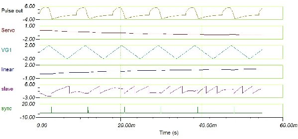

I have been thinking about better ways to integrate digital and analog synths. In part this is because the digital gives such accurate control of
scales, but also because I have wanted to explore cheaper ways of getting
MIDI-to-CV: something where multiple units were affordable.
Here is what I have been playing around with. The Extractorator is (simulated in SPICE, not built yet) a linear frequency to voltage converter with a sawtooth VCO synced to the input.
The output of the VCO always exactly tracks the input oscillator, so the synth can be tuned exactly. (The system is similar to the analog oscillators of the Roland JX-3P. ) The linear CV is not intended for
high accuracy driving VCOs, however a servo configuration is possible (see below.)
Bob Moog's patented Peak Picker is used to provide input-level independence and should be capable of handling many more input
waveshapes than other systems (since it won't latch onto higher higher
harmonics from multiple zero-crossings.)
Because of the syncing and intended use, there is no sample and hold mechanism: no input, the output of the VCO will freewheel at some slow rate. The use of the sync mechanism means that slow tracking response will not show up as glide, but as a slight attack (for any new notes and notes that are higher than the previous, since the integrator won't have reached 5V before resetting) and as a sync sweep (for notes that are lower than the previous) as the VCO slows down.
Here are the kinds of use cases I had in mind:
1) A slave waveshaper from an analog VCO, rather like the ARP 2500 sawtooth slave.
2) An instrument or voice tracker. A companion envelope follower
would be needed.
3) A tracker for a MIDI synth. For example, the old yamaha FB-01 has a right and left output. The right output could be sent to an envelope follower to provide dynamics and trigger; the left output, with much more legato decay times, would be sent to an Extractorator for pitch extraction. This overcomes the typical problem of instability with stacatto passages.
4) A servo configuation with two extractorators, allowing feedback correction of the frequency voltage. In this situation, Extractorator 1 is driving an independent VCO which feeds into Extractorator 2. The pitch from extractorator 2 is compared to the pitch from extractorator 1, and the CV into the VCO is adjusted by the difference.
Anyway, I hope this is of interest to someone. There is some scope for tweaks; different values to cope with extreme bass better. Probably useful to add a log converter to drive expo synth modules better.

| Description: |
| Response of extractorator at 220k input signal. Note the fade-in effect for the first few cycles until it stabilizes. |

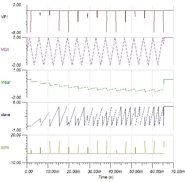

| Description: |
Response of extractorator at 220k input signal. Note the fade-in effect for the first few cycles until it stabilizes. In this case, the VCO frequency is set higher, so that the output is approximately a saw at twice the input frequency, |

Here is an updated version, with better outputs (better levels, better scale, better smoothing.)
I've added an extra output so that it could be built with 4 TL084s: 1 for peak pickers, 1 for triggers, 1 for integrators and 1 for the VCO.

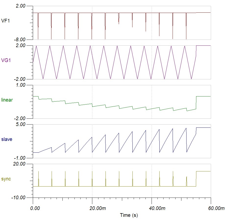

One optional value add is that with a resistor and a three-way switch (the two switches in the post) we can get a couple of different waveshapes easily.
Feeding the sawtooth output to the VCO input, we get a slight FM or phase modulation effect that produces a curved sawtooth.
Feeding Peak Picker 2 to the VCO input, and we get a a kind of disrupted shape. (Actually, this will depend on the audio input frequency too.)
Example waveshapes attached.

| Description: |
| Select disrupted wave has interesting interactions with the sync: many different waveshapes that could not be obtained otherwise. |
