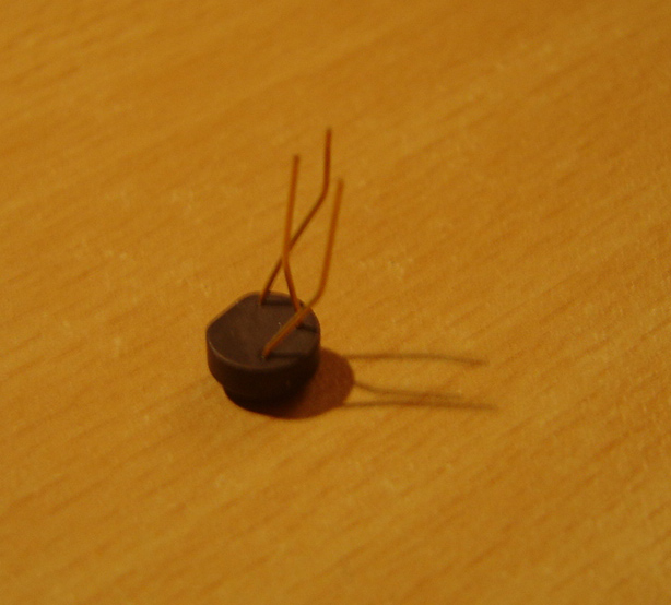

PostPosted: Sun Jan 11, 2009 2:42 am    Post subject: Reply with quote  Mark this post and the followings unread
I've edited my last post as I didn't know 2N3566 was obsolete.
2N3904 is a perfect sub in this design.
291 sound doesn't really rely on the obsolete part.
I'll post sample so you can compare.
This filter did not work here for months just because I've heard somewhere online that 3904 and 3566 were pin to pin compatible.
I now understand this is wrong : a transistor is pin compatible with an other within a specific case (TO-92 TO-220...)
TO-92 2N3566 or PN3566 is pin-compatible with TO-92 2N3904.
MY LAYOUT IS NOT FOR TO-105 CASE TRANSISTORS.
you'll have to bend two pins and put it backwards...
