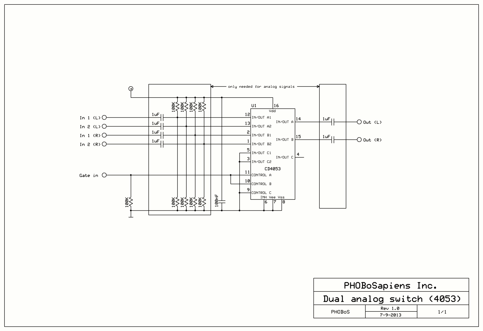

I have a need to switch 2 inputs out to one output from a gate trigger.
Say two different oscillators that alternate at the output to a single channel on a mixer when the gate trigger is high/low respectively.
Is this circuit what I need?
Cant really get my head around what is happening in the schem... Basically because Im stuupid.
Can some one dumb it down for me and explain what I need?
Posts: 5881
PostPosted: Sat Sep 07, 2013 6:42 am    Post subject: Reply with quote  Mark this post and the followings unread
nathanxl wrote:
Hi.
hmm let me see, please correct me if I'm wrong but from your question I get that you want a switch to select between 2 audio inputs. But instead
of a mechanical switch you want to do it with a gate signal ?
That can be done pretty easy, and you don't need the full circuit posted here, allthough with some small adjustments it could be used for that.
here's something that is more like what you want:
This version is for 4 stereo signals. and with the switch you can step through all 4 channels. But you don't need the control circuit (made with
FF1, FF2, N1..N4). All you have to do is invert the gate signal for one of the switch control pins. And you only need 1 CD4066, which gives you 4
switches so could switch 2 stereo channels or 4 monochannels.
having said that, this is the lunetta section so if you just need to switch the signal from 2 squarewave oscillators it can be done easier Rolling Eyes
Yes and thankyou for your prompt reply Phobos.
Ive used 4066s before for auto switching, they are very handy. From my understanding, at least the way I have used them is for each input there is an on/off switch.
I want a switch that is on/on between two inputs.
Thankyou for the attached pic, Im still not certain it does what Im looking for.
From the looks of it the inputs are split to 2 chips, and you mention having to invert one switch input.
So this will give me each input alternating it output between the chips.
Is this right?
http://datasheets.maximintegrated.com/en/ds/MAX394.pdf
If the MAX394 IN pin can be used as an output and the N pins used as inputs then this is the funtionality Im looking for.
I hope I have Ive made myself clearer.
Thanks

Posts: 5881
PostPosted: Sat Sep 07, 2013 9:50 am    Post subject: Reply with quote  Mark this post and the followings unread
yes, you could also do it with a 4053 (4066 was just the first thing that came to mind). So I've drawn 2 schematics:
one using a 4066 and a transistor as in inverter, the other one using a 4053 which doesn't need in inverter.
It also has one spare switch (if you use it for stereo signals) which you could use for some indicator LED's.
you can find some more info on the biasing for analog signals here
note: for the 4066 version a high gate will select input 1, for the 4053 version a high gate will select input 2. (can be changed of course)

Thanks again for that PHOBoS Very Happy . The biasing link looks really useful too. I've not done much lunettaring lately as I've been going off on several different tangents (and I've been a bit pissed off, to tell the truth - nothing to do with electronics, just life in general Crying or Very sad ). Anyway, I've got myself going again and one of the many things I wanted to try (eventually) was to put audio signals through the 4053 circuit. This should be of great help.

Thankyou so much Master Phobos.
I will breadboard these and report back.
