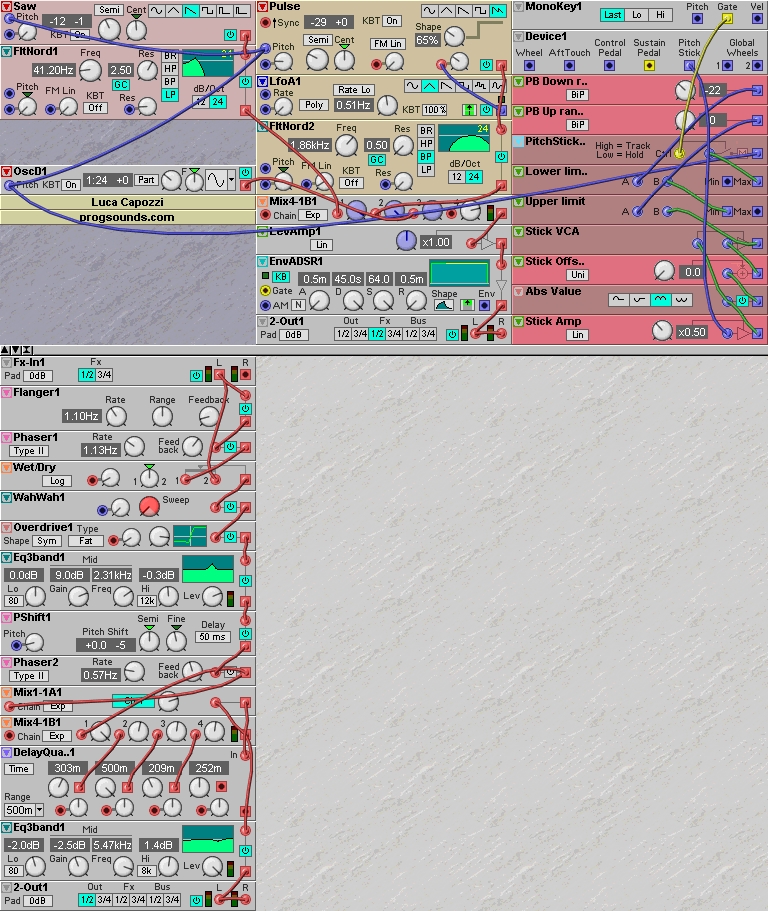

I'm planning on buying a Nord Lead 2 or 2X (or a rack version)... Now I'm just wondering can it produces the right kind of lead sounds for my use. I'm planning to use it mainly for my solo lead and other needed lead sounds first (who knows what kind of sounds I will also use Wink)
So the main question is: Can I get metal lead sounds out of NL2(X)? Good examples for what I'm looking for are the sounds that are used by Henrik Klingenberg (Sonata Arctica; I know he is using Clavia synths...), Janne Warman (Children of Bodom), Jordan Rudess (Dream Theater), Jens Johansson (Stratovarius), etc... Mainly I'm concerned because of the lack of effects... because I'm not sure if my budget will be big enough for NL2(X) and for some multi-effect box or overdrive/dist. box...

but still my main question is unanswered... Can I make those kind of lead sounds with Nord Lead 2 without any other equipment?

It sounds like a simple saw lead with a modest amount of overdrive. The overdrive is most likely from a stomp box or rack as the Nord lead has no built in fx.

PostPosted: Sat Jan 05, 2008 2:01 am    Post subject: Reply with quote  Mark this post and the followings unread
synastikki wrote:
... but still my main question is unanswered... Can I make those kind of lead sounds with Nord Lead 2 without any other equipment?
I think the G2 will serve you better, because these 'guitar like' sounds are hard to make on the more restricted NL2.
Totally agreed. I was trying the same road Smile Still I would make it on the G2...
See the attachment of a Derek Sherinian Monster Lead G2 patch. The FX part is rather large...

G2 might serve me well but it seems so complex... and also I have such a shitty computer back home that I would really have to get a new one to be able to use the G2 editor program... is the G2 really like "unlimited synth"? so I could make nearly everything i ever imagined with it except sample-based sounds? and there is a rack module, G2 engine, right? =P I'll really have to take it under consideration...

There is a Demo version on Clavia's site, which produces sound on your computer. Try it.
BTW I use the G2 on a very simple computer... Pentium 2 and Windows 98 as OS. Yes, I'm that old Wink
