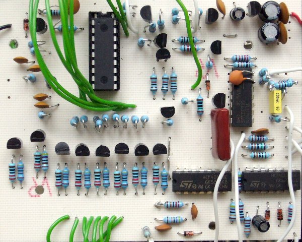

Hello Forum !
[my first proper post !]
I have been making some new Roland 100m Modules, as they
have been discontinued for a while !
Here is a link to a new sequencer I have been working on
http://www.flickr.com/photos/ryktnk/sets/72157604609909924/
and a video !
http://www.youtube.com/watch?v=vK1PoQffhjk
It has step repeat switches:- [1-8] and gate mode switches:-
[off/single/repeat/long] for each stage, plus random & pingpong mode.
It is based around a PIC, so is software update-able.
I am thinking of making a run of boards for the controller PCB
if anyone is interested . . . ?
-ryktnk

PostPosted: Sat Jun 21, 2008 11:23 am    Post subject: Reply with quote  Mark this post and the followings unread
Hello
Thanks for the comments.
I am thinking of producing the main pcb.
[see attached photo of prototype]
This has all the logic circuity for the sequencer plus clock
and portamento etc.
The large panel on the with the panel components, will not
be too useful as it is formated for Roland 100m
modules, and contains a few obscure components.
So to make it work you will have to hand wire all the
pots, leds, switches etc.
-ryktnk

ryktnk
Joined: Apr 24, 2008
Posts: 175
Location: london
PostPosted: Sun Jun 22, 2008 3:25 am    Post subject: Reply with quote  Mark this post and the followings unread
Hello
beautiful stuff! who does your panels?
Thanks.
The panels are from Schaeffer:-
http://www.schaeffer-ag.de/en/news/home.html
Not too cheap, but they are good quality, and nice people.
Price for the boards and PICs I will work out, depending on
how many to make, and post back next week hopefully.
Does anybody have strong opinions about the fixing holes ?
At the moment they are M3 sized, positioned fairly arbitrarily
due to position with Roland 100m pot-panel.
Board size is about 105x80mm.
Top two fixing holes are 72mm apart, along long side.
Bottom two fixing holes re 63.5mm apart, along long side.
-ryktnk

PostPosted: Sun Jun 22, 2008 6:54 am    Post subject: Reply with quote  Mark this post and the followings unread
Hi Ryk,
I saw this on the System 100M forum I believe. Thanks for making the project available, great work. I would like 4 sets of boards and pics.
I would recommend you put the mounting holes at the corners and if you have enough space, you could put extra holes at 4 edge centers so it gives extra options just in case someone is space challenged via the flying leads or their front panel layout. Also helpful might be to put mta.100 headers for the wires a la EM Klee. This will be good a source for clocking The Em Klee.
Sorry for asking , but here goes. Any possibility of voltage controlled stage addressing?

ryktnk
Posts: 175
Location: london
PostPosted: Sun Jun 22, 2008 1:53 pm    Post subject: Reply with quote  Mark this post and the followings unread
Hello
Regarding the connectors, the 8way for the LEDs and Pots are 2.54mm
spacing so should work with MTA100 or similar kind of connector.
Screw holes, they will probably stay where they are, sorry.
Ringer:-
About the voltage controlled stage, mmm
That could be possible, but would require sacrificing another feature, which
would probably be the max-stage setting; as there are no more free inputs on the PIC, and adding another socket.
The stage change to a new stage would still be dependent on the clock
pulses and the amount of step repeats on the current stage, but would
jump to an arbitrary stage set by the CV, is this what you mean ?
Floppy:-
would it be possible to add note quantize via the software ?
No as the CV's dont go through the PIC, they are just plain analogue.
-ryktnk
