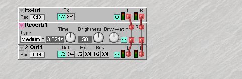

I don't know Embarassed Embarassed like you see, this question is very basic but a problem for me.
The reverb in the FX Area does not sound to me, but in the voice Area all is OK.
In which I am being mistaken? erm, maybe not ...

That looks fine, does the 2-Out module in the voice area have fx 1/2 selected as the destination?

If you want to use the reverb for external effect processing in the FX area
you need to have a simple 2 in module if you want to put material from the inputs of the synth thru the verb.
The FX in module is for routing sounds from the voice area to efx area.

You posted the same picture twice, probably not what you meant to do.
Does the reverb not work at all for you in the effects section or does it sound bad ?

I'm making my first path Embarassed Embarassed
Thaaaaaanks to all too much coffee for the answers, I'm trying to apply the reverb to the general sound of the patch, to all the patch not for the physicals ins of the synth.
Sorry my english, but you understand what I'm trying to say?.

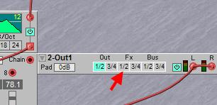

At the moment, the patch in the voice area is assigned to the main out 1+2, click the FX [1/2] button as shown, this will assign it to the FX-in module in the FX area (and to your reverb).

dancing Yeeees , thaaaanks, the first Embarassed
