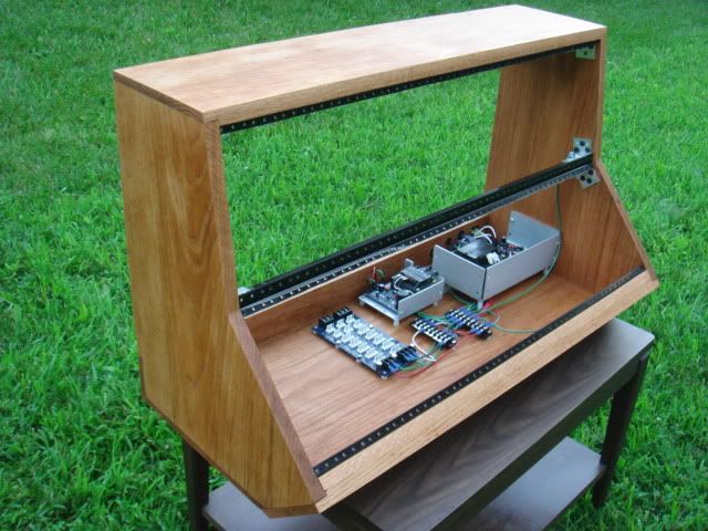

I'm planning on building a cabinet to fit 5U MOTM modules, 16U wide x 4 modules high. I'm wondering which is the best wood, where to buy in the UK, best ways of fixing modules in place, etc. Basically everything I need to know before starting the project (I'm no carpenter either)... Also, I'd like to hear your opinions on Varnish / Stain / French polish etc.

After pricing Walnut, I used Oak on my Klee case - it was about a third the price of Walnut. I have used Mahogany on a couple cases recently - it's easy to work with, but it's a little too soft - it gets 'dinged' pretty easy.
For mounting modules I'm pretty ghetto. The first couple racks I used strips of Oak and screwed the modules into that. For the next two I used aluminum 'angle' stock and used self tapping screws. That's what I did with the Klee.
Here's the Oak case....I stained it using Minwax "Dark Walnut" stain, and followed that with a couple coats of Parks polyurethane gloss.

I also used oak, and standard rack rails mounted horizontally to mount the modules (although that was a bit finicky due to the rails I used).
I just used tung oil as a finish with no stain.

Don't laugh Very Happy , I rake about in skips on whatever building site i'm working at and usually get some nice Latvian pine ply wood , knock something together in the shed then apply B&Q own brand varnish lightly rubbing with some P1000 sandpaper or light steel wool between the first few coats to build a sheen
Did you pre-drill a bunch of evenly spaced pilot holes or did you drill as holes were needed? If the latter, how did you prevent any shards of aluminum from an upper level from landing on boards on a lower level?
I favor wood strips, but knowing how well the Lunetta case worked out, maybe I'll try aluminum angles on my next case, whenever that might be.
Thanks.
Although evenly spaced holes would be wonderful....my homebrew panels have not been that precise Smile I drill them as I go. I use a vacuum after drilling - and to this point shards in the electronics has not been an issue.
The wood will be easier to adjust if I move panels around - fill the previous holes with wood bits and glue, and drill another hole...
