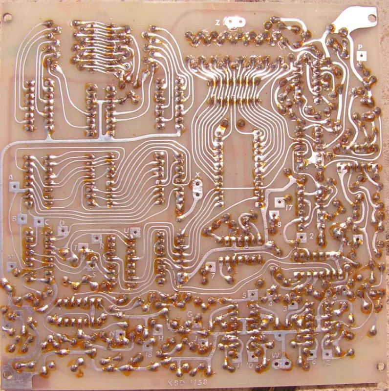

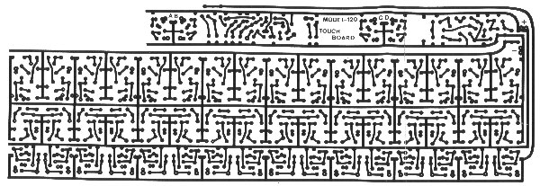

Subject description: Attached: pcb layout for Buchla key pads

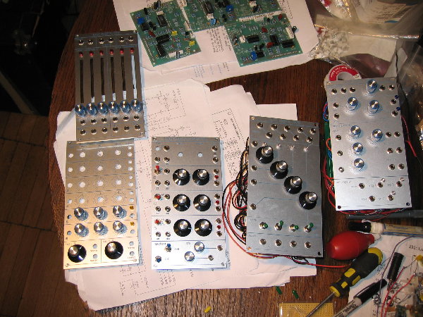

I've been building modules for a portable briefcase and/or fold-up boat for quite a while now--many of the modules inspired by and/or reproduced from Buchla designs. Most all of what I've built is from layouts circulating on this forum. I recently posted some pictures of my first panels, but here they are again, pictured below--to provide more context for this ongoing project.
Anyway, I've always thought the crowing jewel in this set-up could be a capacitance keyboard, or even a touch pad keyboard ala EMS. I have this Touch Controller schematic from Synapse, submitted by Serge, as well as the Programmer schematic, that goes with the Controller, from the next issue. I've also been looking at some of the Bugbrand circuits, like the weivel, etc. These circuits are well described and they seem doable, even for me.
However, maybe the most contentious issue about building a controller like this, for me, would be in designing and constructing/fabricating the actual keyboard.
I've been told that on the early Buchlas, the keyboard was made from an actual PCB, with the keys simply etched onto the conductive metal-- and also that the Serge controllers were/are made from pezio elements.
I've also read that there was a Japanese analog synth circuit book published in the 70s or 80s with many schematics and PCB layouts of commercial synths and included a PCB layout for the Buchla touch controller. This would, of course be a great help if I was to go the etched PCB route. Probably some people here have this book I'm talking about, and I'm just wondering if anyone would be so kind in sharing this layout with me?
Also, though, I guess I should say, my most ideal inspiration for a touch controller would have to be the later Buchla keyboards, such as the 218-219 touch controllers, also pictured below. But, I have no real idea how these are constructed. Most likely they are factory fabricated instruments and perhaps beyond my limited fabrication resources.
But I'm just putting it out there for anyone's musings...Does anyone have any ideas on how a controller like the 218-219 could be made? The physical keyboard, that is? I'd love to know if anyone here has tried to make a controller project like any these mentioned (and how Very Happy).

I was interested in building one of these as well, but I never had the time to stare at the schematics until they made sense.
http://rubidium.dyndns.org/~magnus/synths/companies/buchla/
(I don't know if you've already looked at these)
If anyone has the PCB layouts, holycrap I'd love to see that.

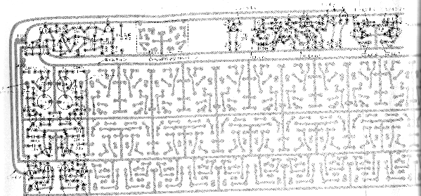

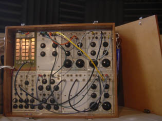

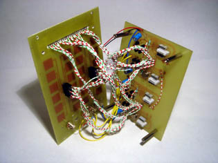

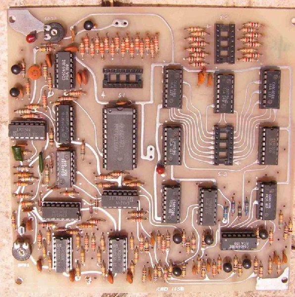

I'm attaching a few photos I found (don't remember where) of a Serge TKB board. This is a capacitive touchplate board, different from the one in Synapse. Enjoy... !

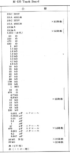

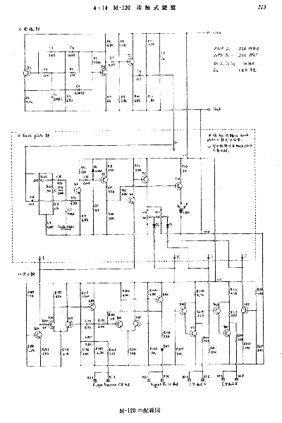

I've got the docs you're looking for. Wink
Starting off with the schematics and parts list:
schematics
 Filesize:  63.35 KB
 Viewed:  1724 Time(s)
Japanese Touch keyboard parts list
 Filesize:  78.77 KB
 Viewed:  911 Time(s)

PostPosted: Wed Jul 23, 2008 6:44 am    Post subject: Reply with quote  Mark this post and the followings unread
Here's the PCB Layout, and parts overlay.
here's the PCB layout from the book.
 Filesize:  1.49 MB
 Viewed:  909 Time(s)
 Filesize:  2.16 MB
 Viewed:  983 Time(s)

And it wouldn't be complete if I didn't include the PCB layout for the touch keys, now would it?

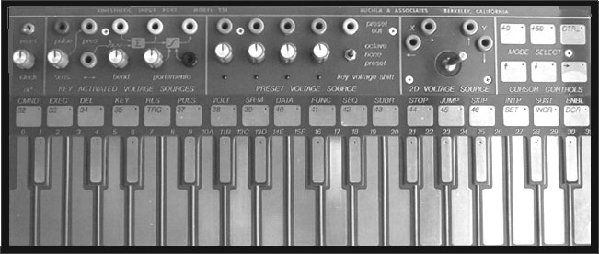

PostPosted: Wed Jul 23, 2008 5:16 pm    Post subject: Reply with quote  Mark this post and the followings unread
I had a 217 touch keyboard once and it was notoriously difficult and time-consuming to calibrate (one that I wouldn't attempt myself; gave it to a tech). It seems that each key calibration can interfere with the neighboring calibrations, or something similar. I can't say that I would recommend that circuit. I haven't played one of the smaller ones so I don't know if it's more responsive (the 217 sometimes didn't "see" when you played a key).
I'd certainly be into a remake, if it weren't too non-discrete. Modern component speeds take away from the analog character.

Hey Peake,
You had a 217? How was the touch control strip above the touch keys? I've always wondered if that wouldn't be a good DIY solution for a ribbon controller like device. For those who don't know what I'm talking about, there's a pic and description on Buchla's website:
http://www.buchla.com/historical/b200/217-keyboard.html

It was excellent; I'd buy a box with two of them alone if it were available. (Edit: Only if they were vintage circuits- none of this modern high-speed stuff, thanks.)
They each output gate, pressure, and position (both increasing toward the center of the unit, IIRC). Because they're nonlinear they're a lot of fun.
Buchla also included a set of four individual keys which output a settable voltage, gate, and pressure (each). Very useful for initiating events or modulation paths.
