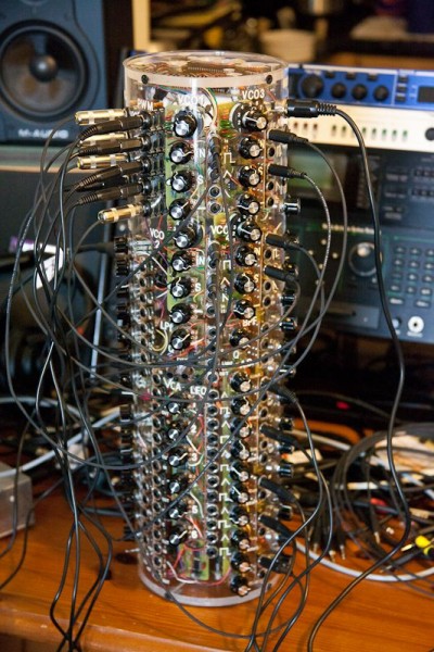

In the chat, my good friend wofl posted this as prior art reference:
Les
Cylinder Synth Prior Art
 Filesize:  110.09 KB
 Viewed:  792 Time(s)

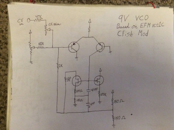

PostPosted: Fri Dec 23, 2016 9:24 am    Post subject: Reply with quote  Mark this post and the followings unread
Edit. Switched back to 2 9v battery supply and scrapped this. Biasing the FET output buffer was tedious and affected the UJT core to much.
I spent some time yesterday on a project using the little EFM VCO.
I adjusted it to see how it worked on 9v. Wanted to use it with a battery.
I added the 2 150 ohm resistors as a divider, and adjusted the capicitor value to bring it back in range.
It worked really well.
Even ran it on a 9v battery. Though I'm sure it would drain it fast.
☀️Edit. Error. The top 2 PNPs should reference 1/2v not ground.
I built 2 of these. On the third one I built it like I drew it and couldn't figure out why it wouldn't work.
 Filesize:  840.71 KB
 Viewed:  767 Time(s)

PostPosted: Fri Dec 23, 2016 9:42 am    Post subject: Reply with quote  Mark this post and the followings unread
Then I added an extra 2n 3904 amplifier, so you can hear it on a small speaker.
I love trimmers to bias transistors. Sweep it till it works good. Saves a lot of time.
Edit ( I just realized I made a mistake drawing the schematic) the top 2 PNP transistors reference 1/2 v not ground.

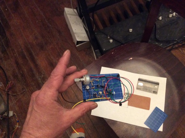

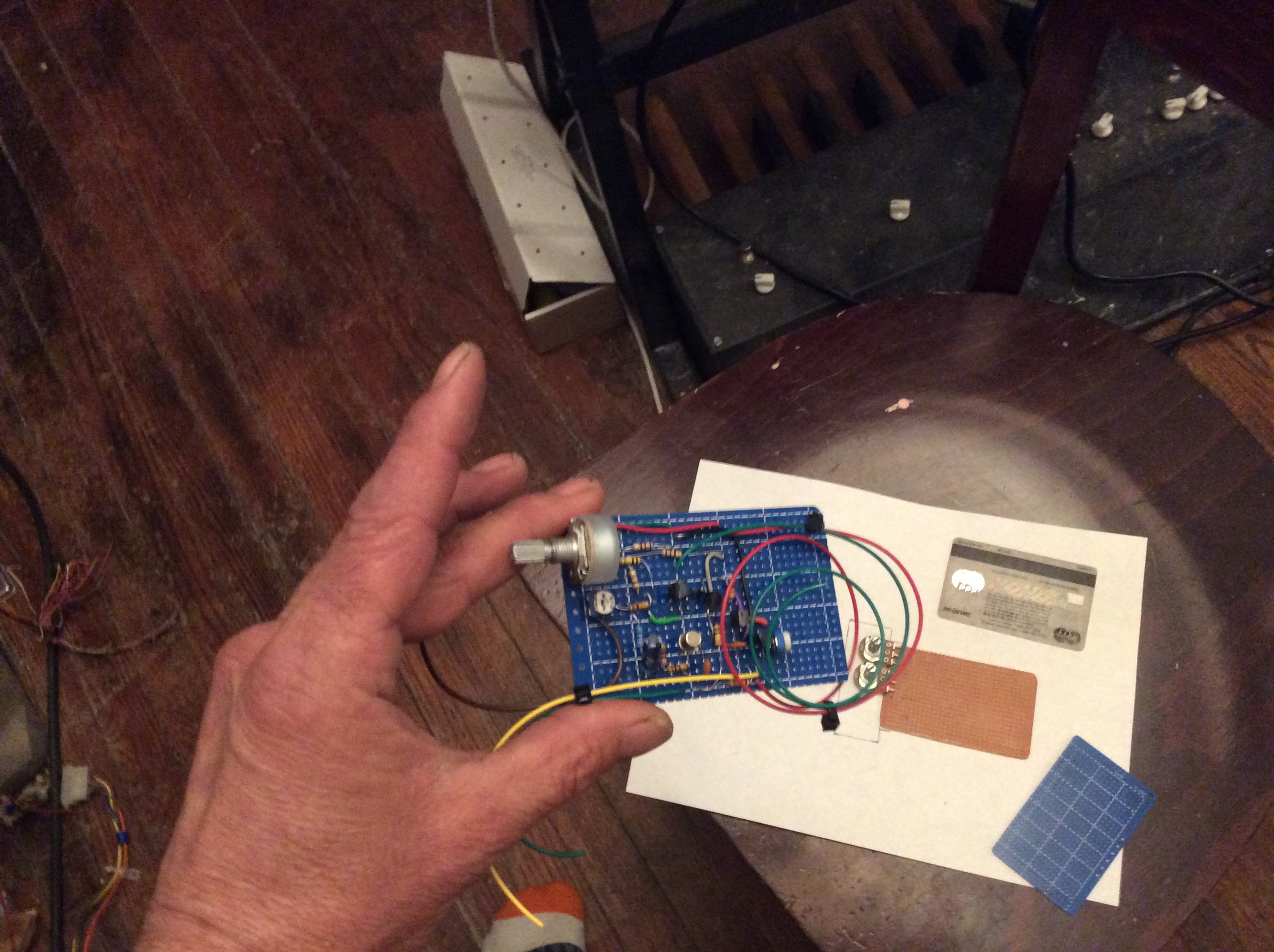

Cfish
Joined: Feb 24, 2016
Posts: 477
Location: Indiana

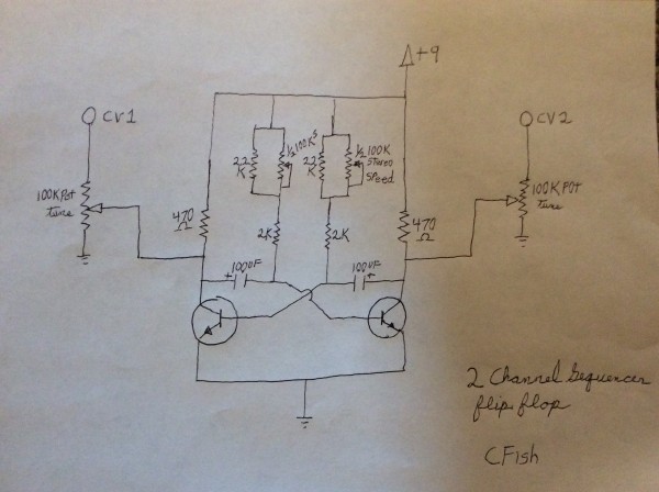

PostPosted: Fri Dec 23, 2016 12:33 pm    Post subject: Reply with quote  Mark this post and the followings unread
Hi Les
I like the credit size modules concept.
What I'm working on right now is a desktop type synth, and I decided to use no integrated circuits. I love working with independent transistors.
Using 2 of the little VCOs, a switch that can direct the first VCO to drive the second, or each down there own signal path.
Am including the simple transistor flip flop below as a 2 channel sequencer to ping pong between the VCOs
Just got done testing the values in it on the breadboard.
( the parallel resistors on the stereo speed pot, are because I want to use only things I have on hand)
 Filesize:  836.66 KB
 Viewed:  669 Time(s)

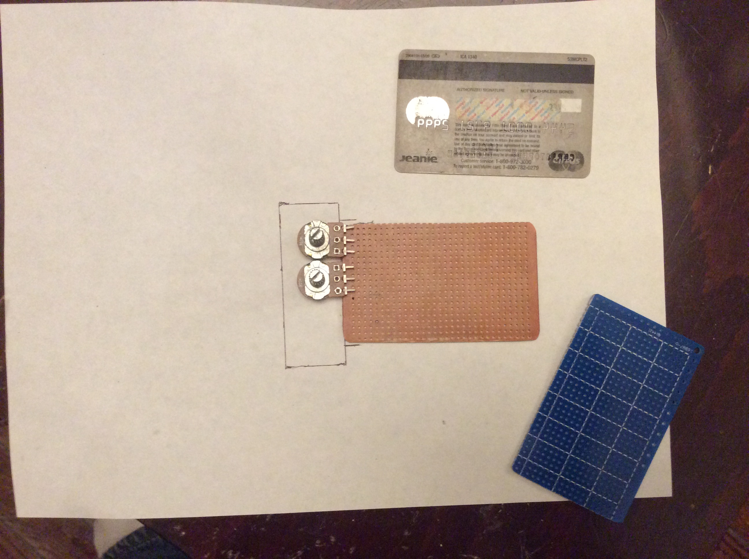

CFish, Also I have wanted for a long time to make music circuits by designing 3D printable "forms" around which one could wrap the leads of discrete components and then either twist, solder, or both to make the connections. We have prior art on this site in the Lunetta sub-forum. I'll try to find it. This would be different from the prior art but similar in concept.
Les

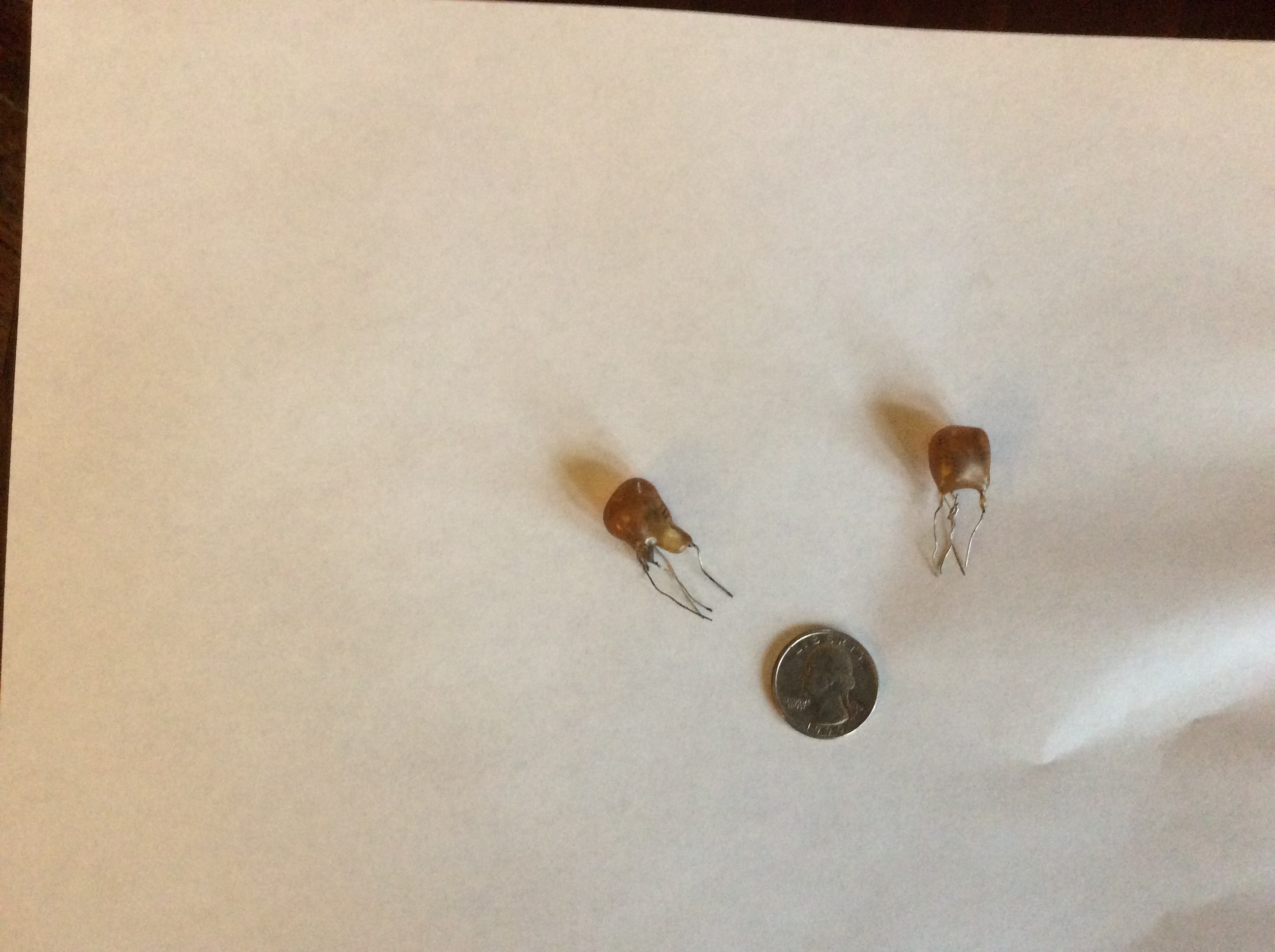

Not to go off track on your thread, but I thought you would appriciate these.
Open air wired VCOs, dipped in fiberglass resin.
 Filesize:  994.53 KB
 Viewed:  513 Time(s)

PostPosted: Fri Dec 23, 2016 1:47 pm    Post subject: Reply with quote  Mark this post and the followings unread
Forms would have been a big time saver when I made those.

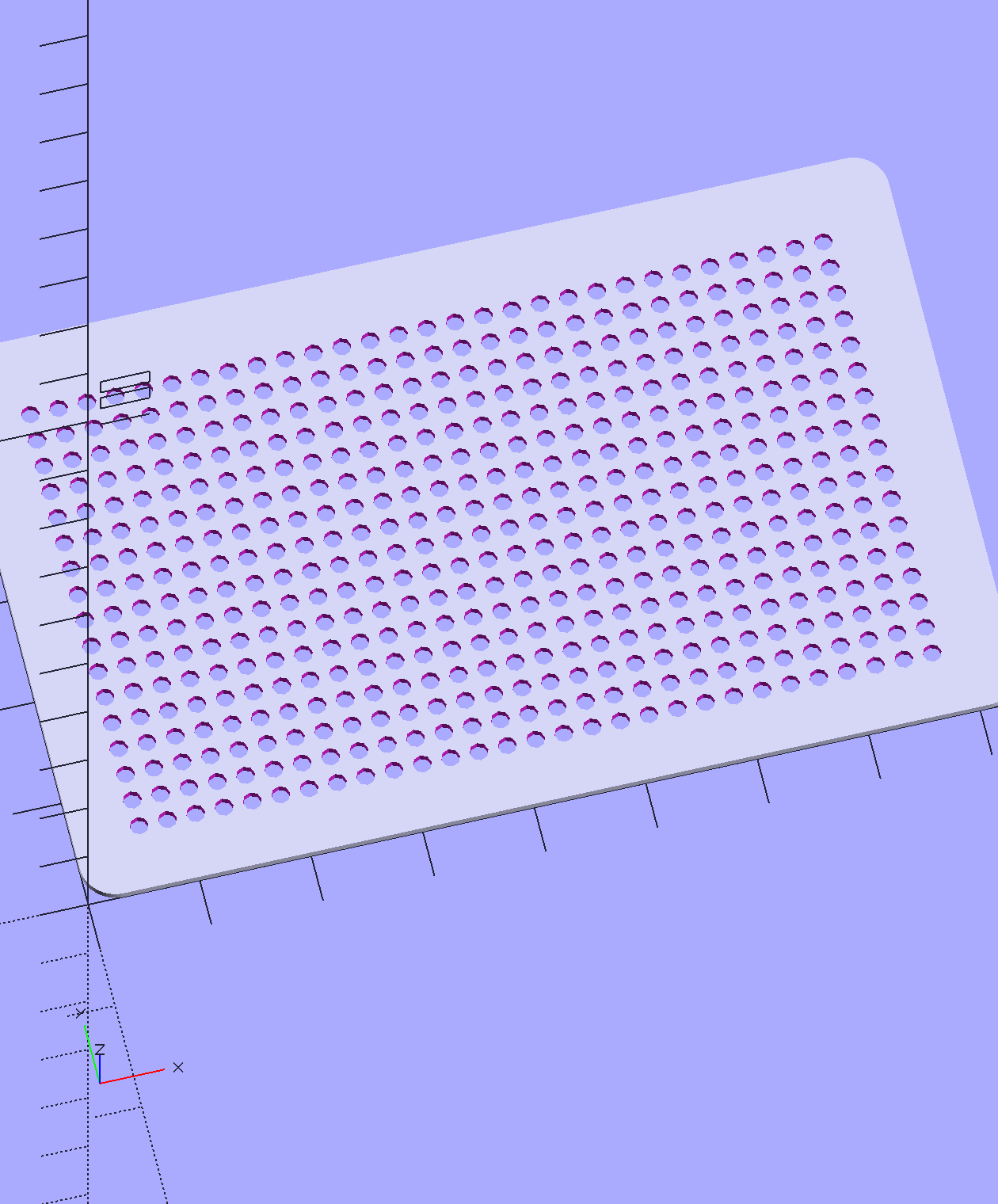

Here is an image of the card I am preparing to print. Print time is 24 minutes plus setup and cool down. So basically well under an hour each on a 3D printer.
Les
Here is a blank card that I will soon put on the printer just to see how it works. 6mm (1/4 inch) keep out distance on both x and y.
 Filesize:  62.54 KB
 Viewed:  541 Time(s)

In 2007 my birthday present was electro-music.com;
in 2016 my Christmas present was the credit card synth.
Thanks CFish.
Les
